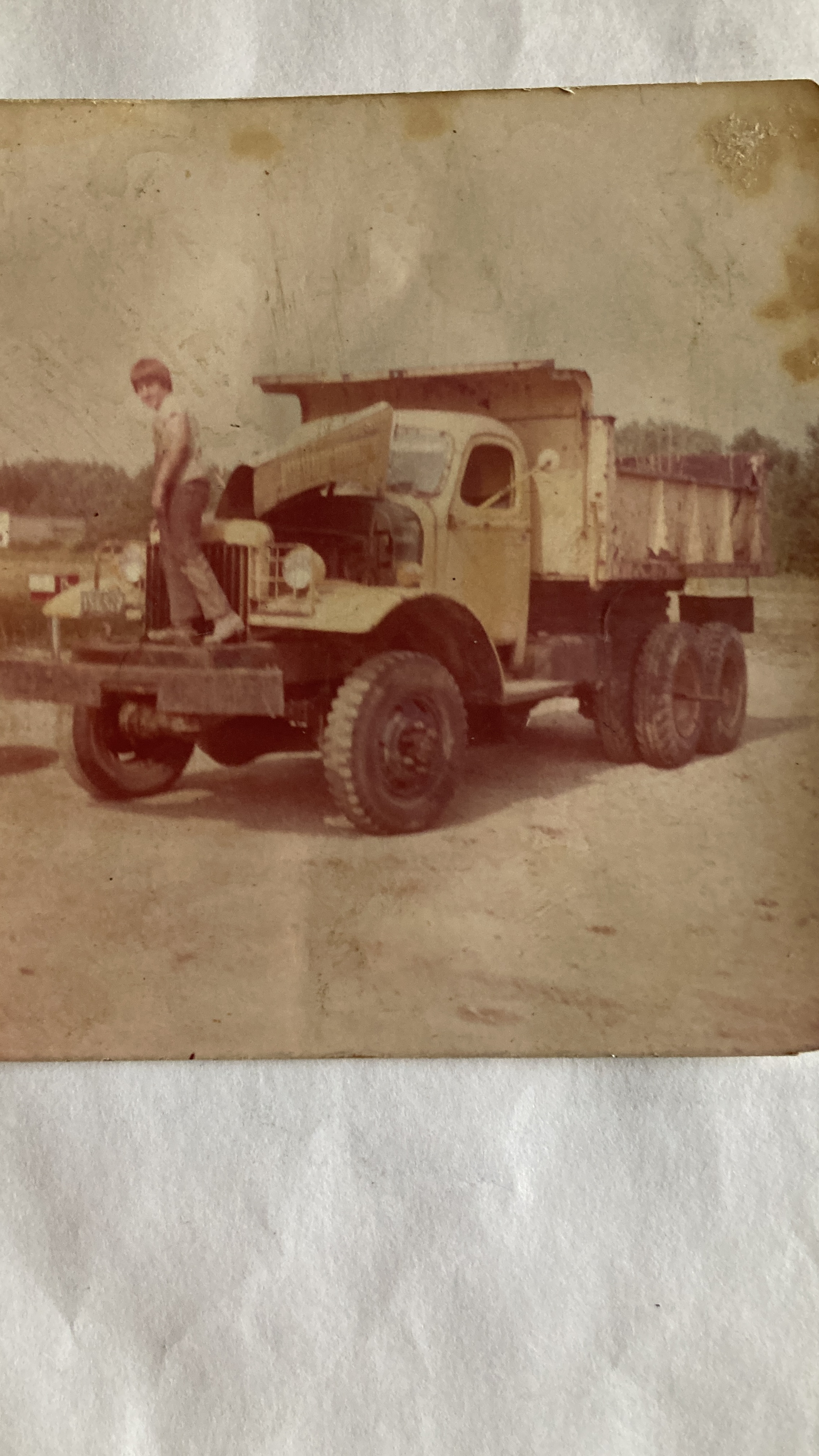

I got mine when I was 10. Actually it was there before I was, my dad bought it in '55 ... it was his first tandem.
Then he bought a new T-850 in '63 and the old 6x6 got pushed into the weeds and I retrieved it. Still have it today.
Nice photo. Were you doing some work to the rear wheels? looks like a wrench sticking out.
Ha! No, that's one of the axles. All the axles had been welded in at some point because it would break the studs off of the hubs, and the hubs eventually got so mangled they couldn't screw the bolts in any more.
We had piles of axles and I was just test fitting one. At the the picture was taken, only the rear axle was driving the truck.

Sounds like you had some interesting times keeping the truck going 🙂

Currently in the garage with a fresh RED 361B. But I spent quite a few years trying to locate a RF axle shaft that had snapped off next to the Convel joint. Just recently found one, and the missing axle shaft for the no. 1 rear differential.
Everyone the drove the thing has passed on so everything is theory, but I suspect that the reason they had so much trouble with the rear axles was because the front axle was broken. I base this on the fact that the transfer case cannot be shifted to low range without being shifted to 6 wheel drive. Thus, the load would have been spread over six axles instead of four. The axle headaches, coupled with the fact that the engine was shot, led to its retirement.
When I got it apart, I found that the axle fracture was polished smooth like it had been broken for a very long time , maybe even before we bought it.
Seems like all the M5H6 stuff is currently on the north-western coast. Used to have a good place in Chambersburg PA until they sold off the WWll division. The missing axle came to me NOS.

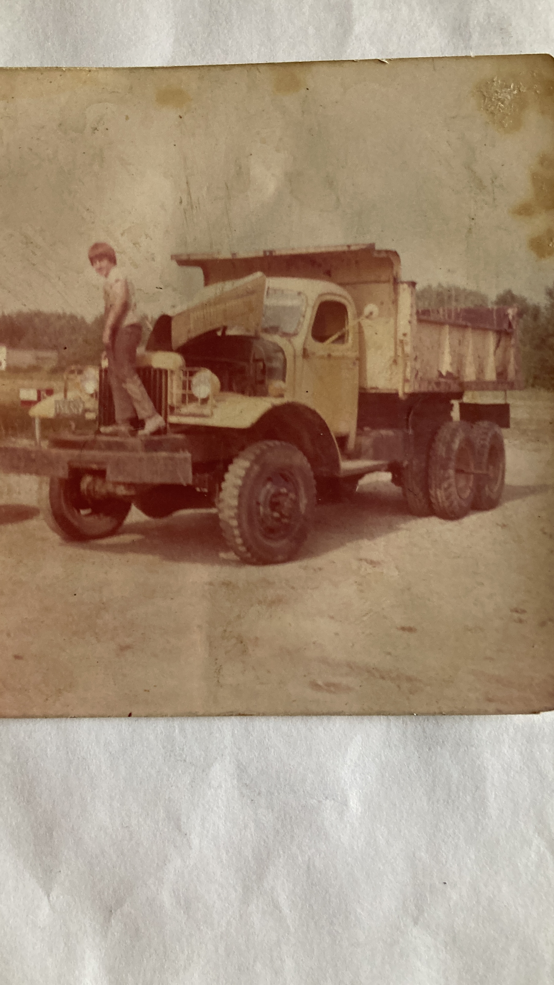

Then he bought a new T-850 in '63 and the old 6x6 got pushed into the weeds and I retrieved it. Still have it today.View attachment 98456
