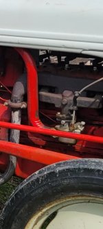

I've got a '48 8n 12v that ran and cut with a 5ft finish mower but did not hit high rpms. Over 7/8th of throttle the tractor pops and back fires. When I push the clutch in and free spin the tractor ran good. After messing with the main jet to add more fuel, it turned into a crank no start scenario. Checked spark on all 4. (Bright and blue) verified plug order(also correct) verified fuel flow(strong) and set the carb setting 2 turn out main, 1/2 turn idle mix.
I ended up pulling the carb(absolutely clean and zero rust) and replaced the distributor and cap with one the prior owner had and this made it fire up and run.
Now the tractor runs but spits and back fires and won't do much over half throttle unless I creep it up, pops and lugs with hard acceleration and choke makes it die.
This tractor has been garage kept for some time. This issue started after letting it set in my field for 2 months cutting with it a few times.

Sounds like your tractor is punishing you for leaving it out in the field. My thoughts are leading to distributor, not the cap and rotor, but I would check the points. Look for pitting and check the gap, .015. Check the bushing, is there any side to side movement of the shaft? Then I would take a look at the centrifugal advance weights. Are they clean and free to move? Then of course reset the timing.
From the picture----it looks like an aluminum carburetor---that is the characteristics of the Chinese carbs you described. I'd find me an original and rebuild it, then adjust the high speed screw at full throttle. I never like to use a six foot brush hog, or finish mower on an 8N----it's a little too much, and I found a five foot works much better, and still cuts out your tracks. Of course, that's one man opinion, and I'm sure you'll get others as well, which is fine, too. Weigh everything and do it your way, Dennis.

I've got the stock one. The marvel schebler. Didn't have time to clean it out but you are not the first person to say they prefer the stock ones.

While adjusting at full throttle, when it bogs and pops do i assume this is lean and add more fuel with the downward pointing main jet(power jet)?

Check the bushing on the distributor shaft? Internal on the distributor or on the cam from the motor?
Timing on the front mounts are done by the slide plate on the side of the distributor that's held down by a Philips screw correct?
The bushing for the distributor shaft, It is internal If it's worn you can't keep the points gap set. You're correct on how the timing is set.
But, I may be wrong about the distributor anyway. I failed to notice the after market carburetor. I would go that route first.
I know they grate on nearly everyone here, but I have one tractor with the aluminum after-market carbs and it runs just fine as does the other 8N with original iron MS carb.

When i bought it the tractor had the 241b aluminum carb on it and it ran good enough to spin the mower and cut it all. This slowly became an issue where I was down on power and spitting and backfiring.

Carb didn't change over time.....but could get dirty over time, regardless of Chinee aluminum or iron MS.
