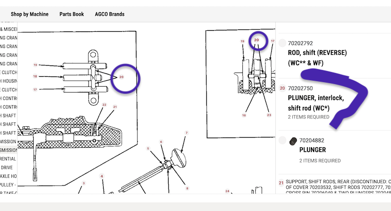

Qhile getting ready to install the spring and detent ball fo rteh reverse rail a little bullet shaped piece of iron fell out of the housing, I think it should go between the two rails but can't find anything like it in the parts manual. I'm not sure just what to do with it.

they are interlock pins, there should be two, one may still in there (look at page 23 in shop manual I sent to you)
