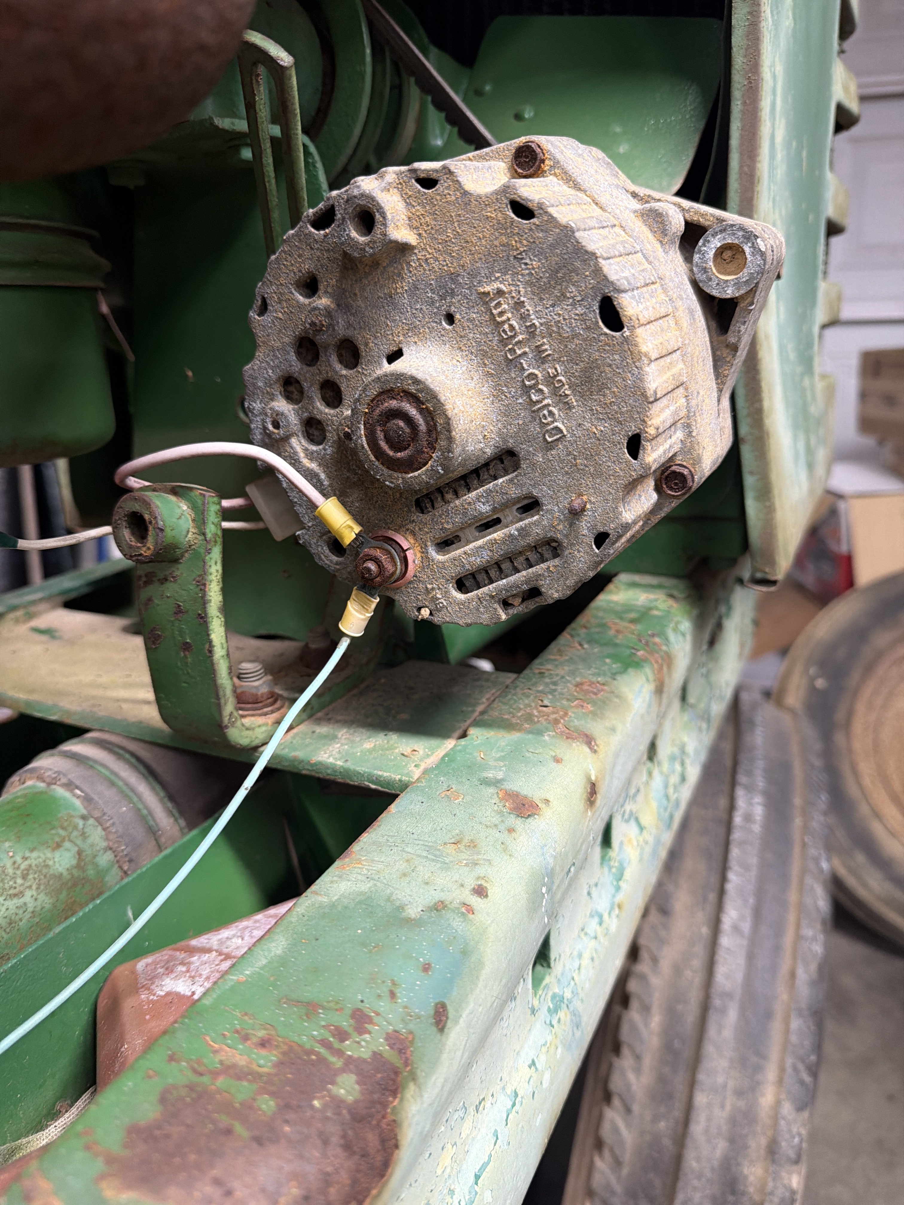

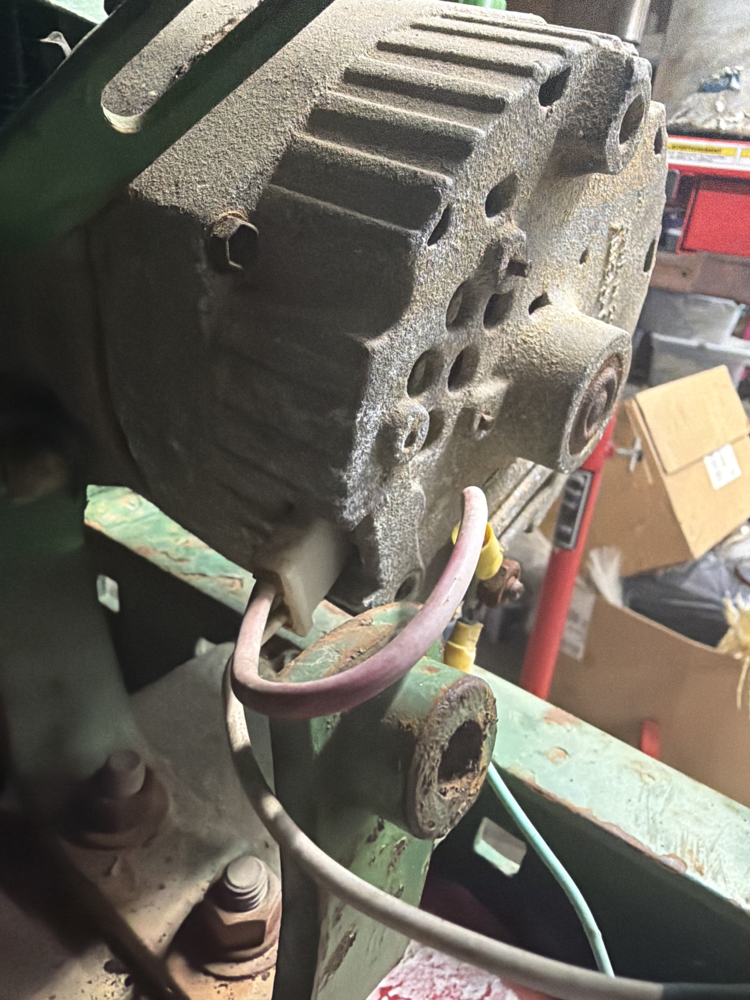

You should post some pictures of at least the alternator so we can be sure which "multi-wire" Delco alternator you have.
@Jim.ME @Fixingfarmer thanks guys. Your thoughts all match what I see and think. We just never know what these guys have done in the field over the years. I will get some pictures later this evening when I get back in front of the tractor.

@Jim.ME sorry for any confusion. It’s the same alternator just from both sides.

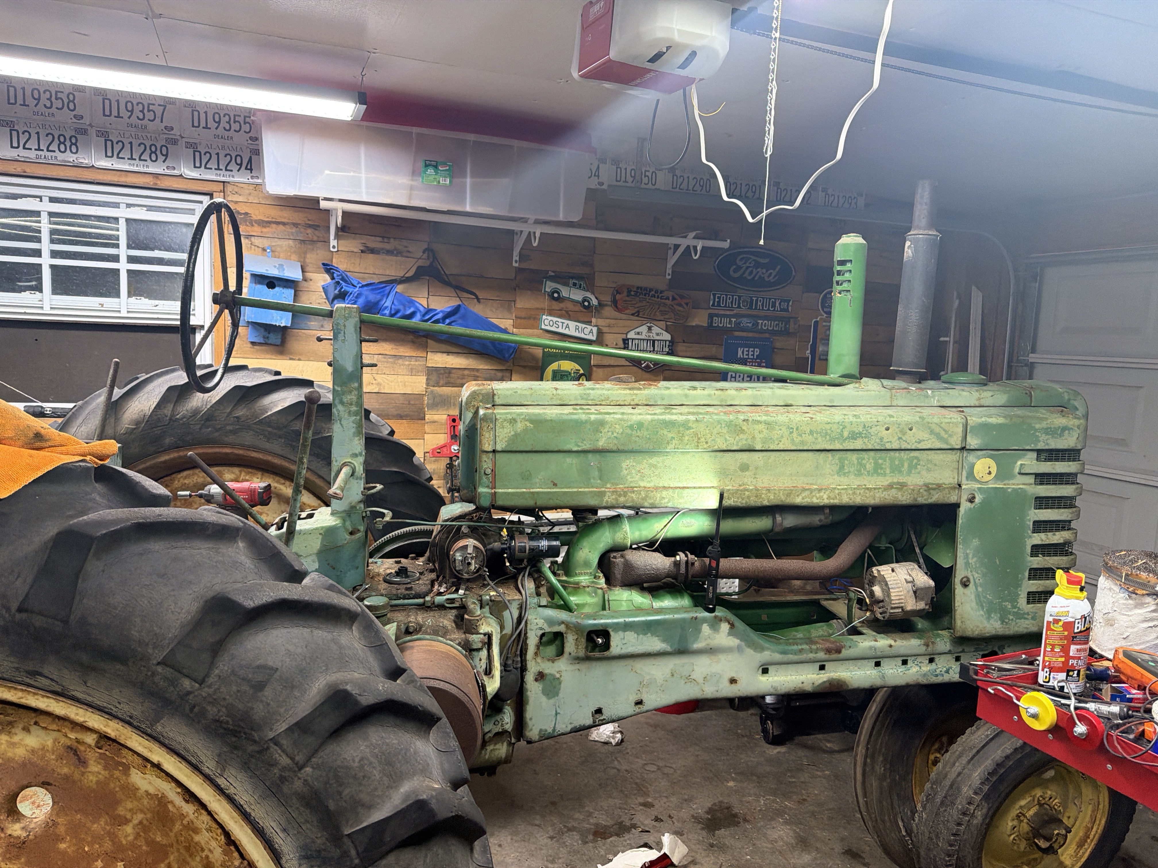

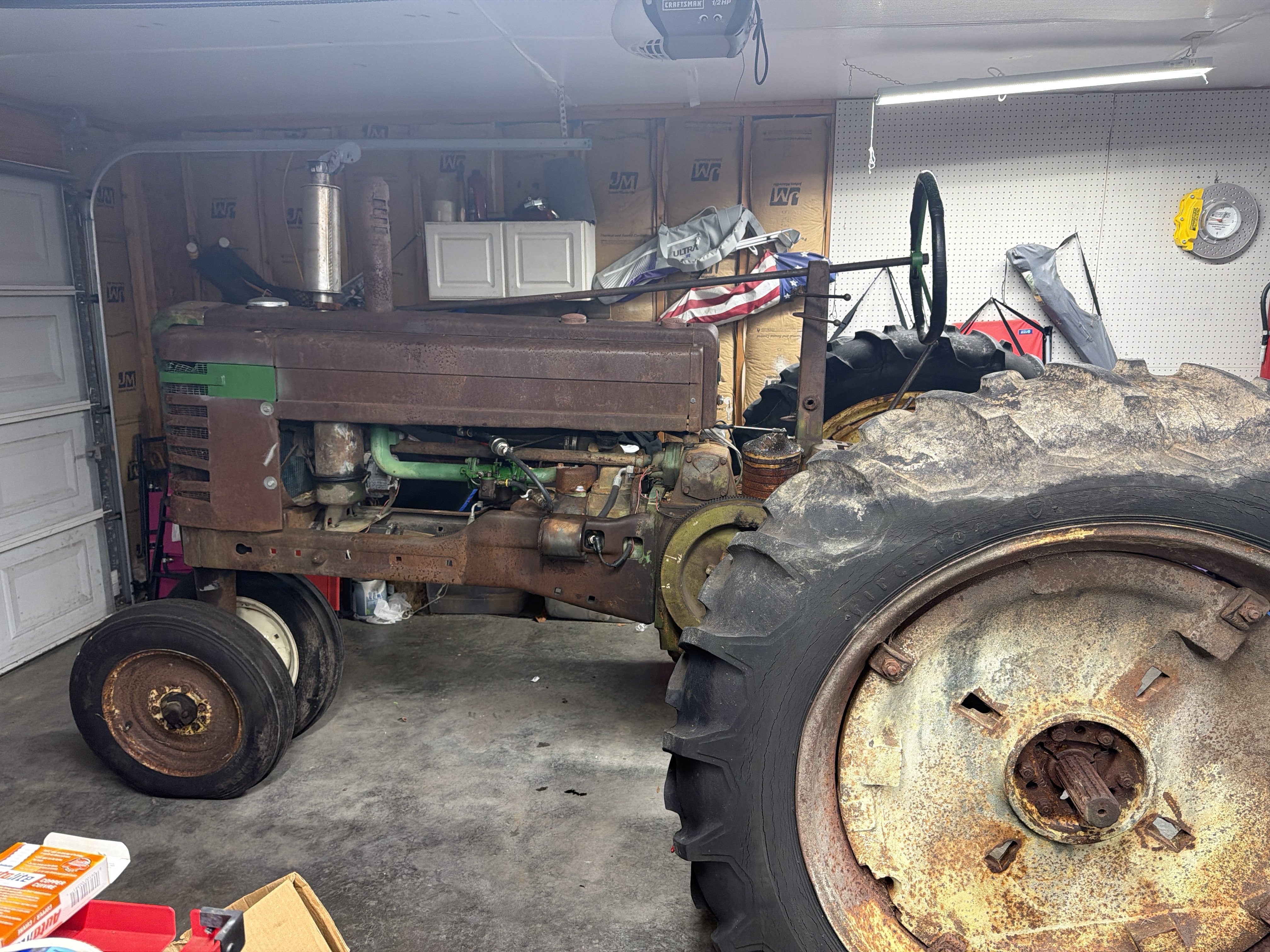

I should also note, my photos of the tractors above are actually two different tractors, not the same one from both sides. I just took the shots that were easy to get inside the garage.
