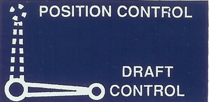

Has your 3-PT passed the Lift Test? Which handle do you mean? The Touch Control Lift Quadrant or the POSITION CONTROL/DRAFT CONTROL selector? Did you try it in both positions? Is the PTO Lever Engaged?
