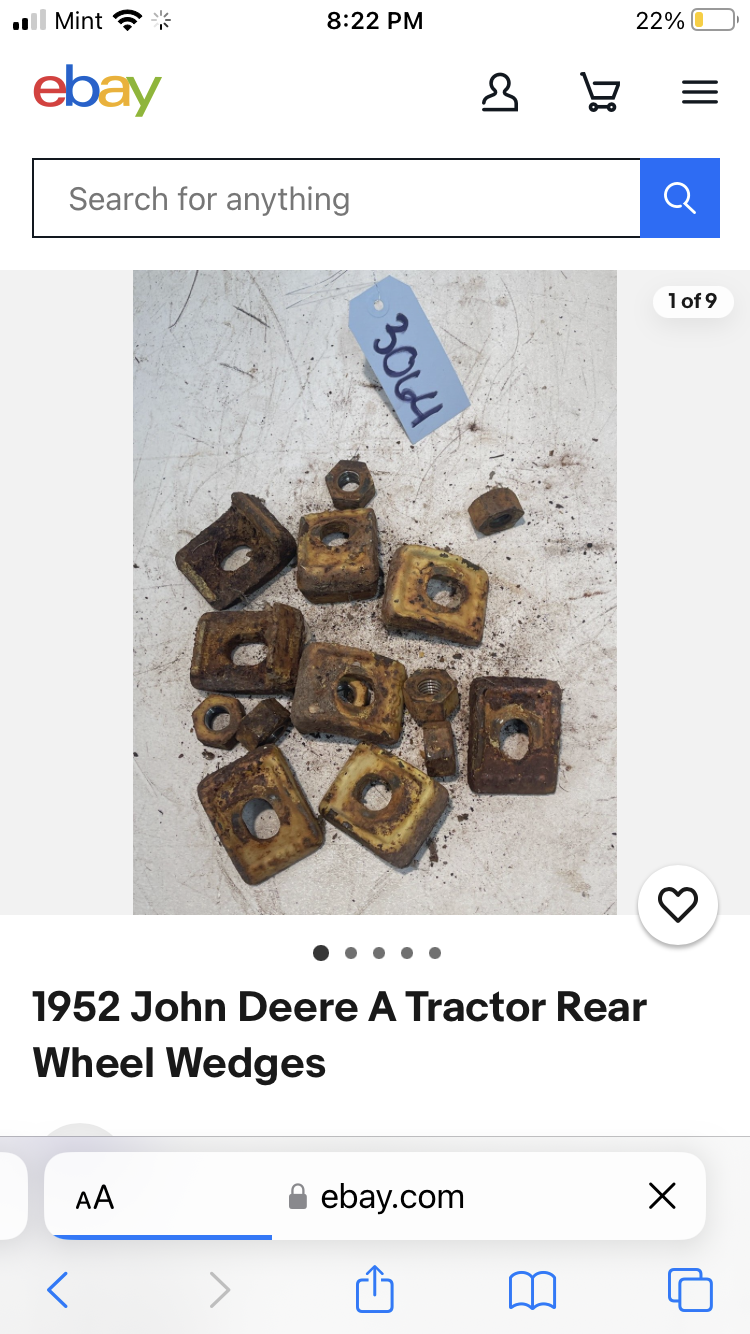

This is what’s on my 52 A I believe that’s what you describe? I think the loop might be part of the nut and you would just put a regular nut on instead handy for chains I suppose

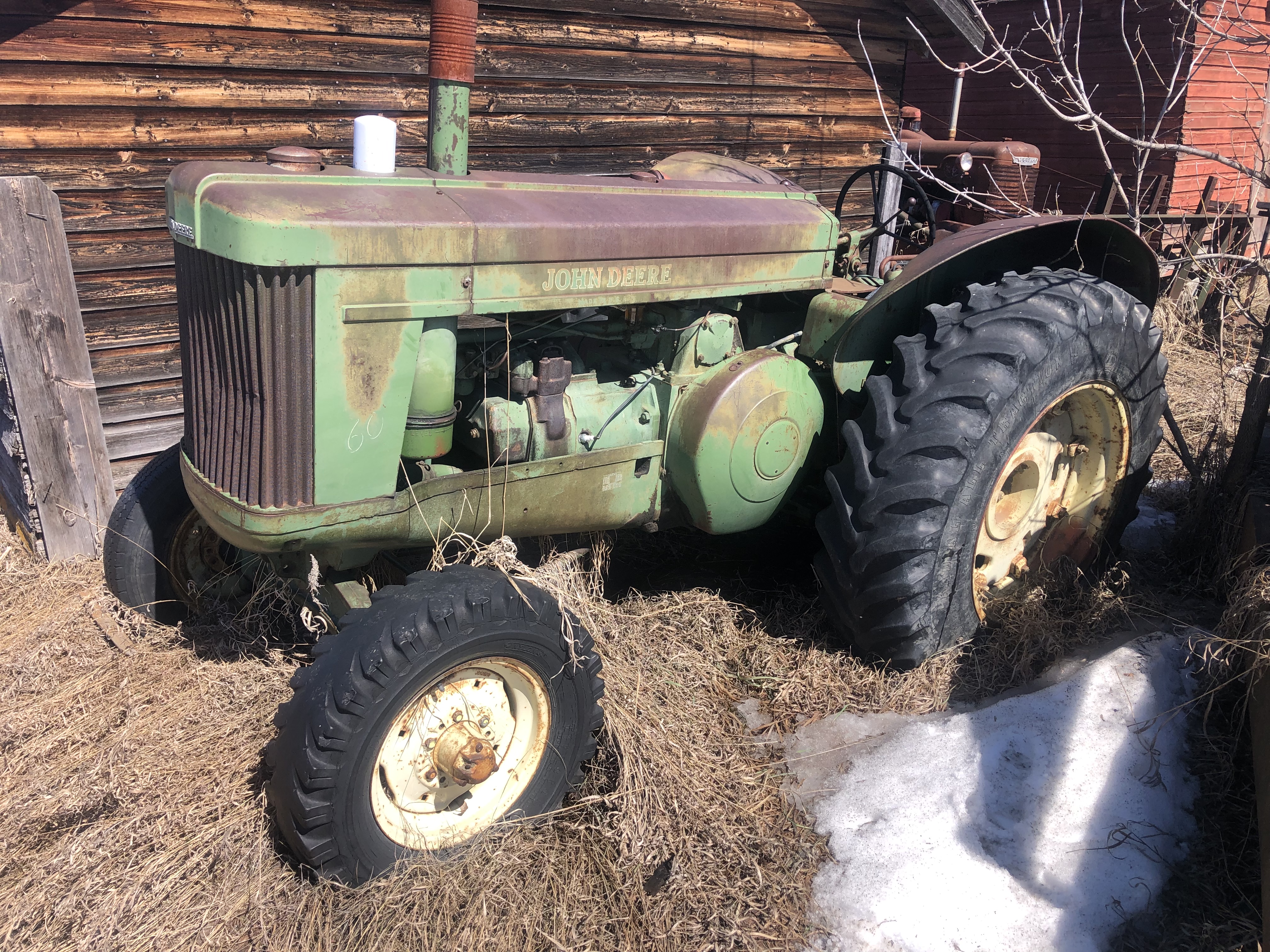

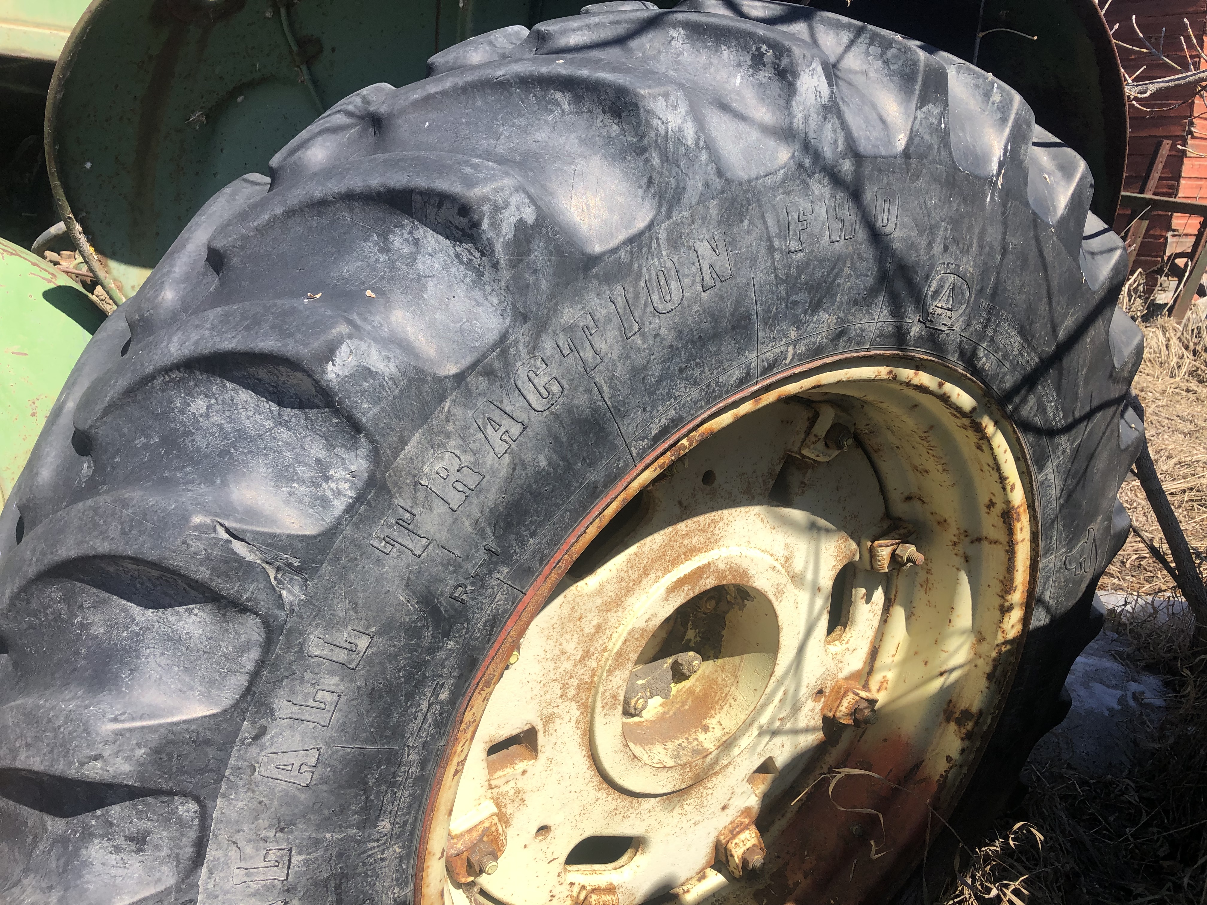

This is my low 60. It has 14.9 x30” tires. The AR used 26” rubber. The high 60’s used the 38”.

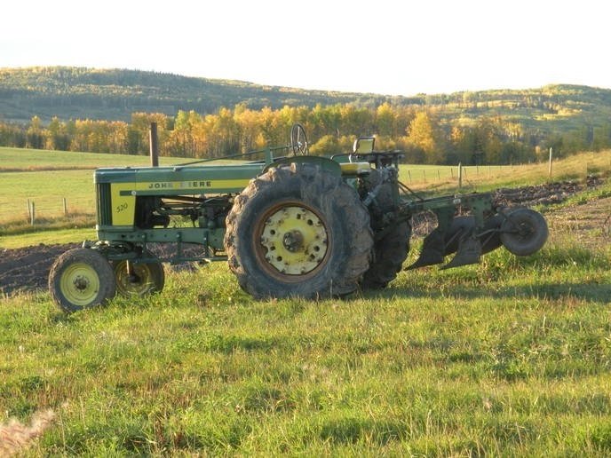

I own a John Deere 520...for the soil conditions,the 38" narrow rubber was useless!
I happened to be at an auction,and purchased two 30" rims,with Tires 18.4 X 30 and cast centers...supposedly off a JD 3010 or 30210.
Installed the above assembly's on my 520.
Had to use the TAPERED Wedges from the 520.
Bob..................:)
