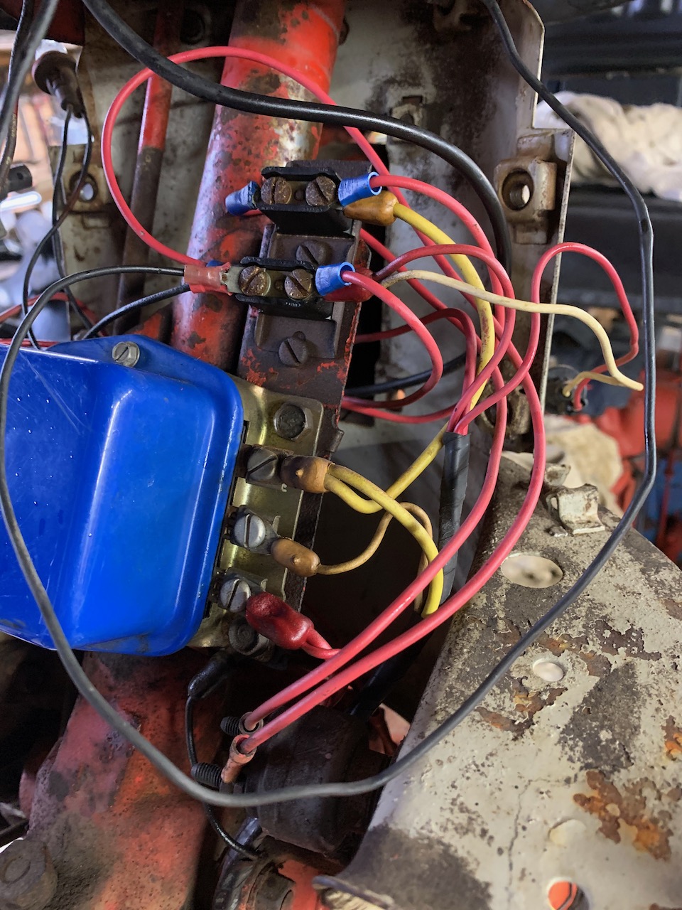

Does anyone have a good photo or illustration of where the Junction Block goes? My tractor was in a fire and the wiring and associated items were destroyed. I can't find a good photo of the correct location in the Ford manual. Thanks.
Here's a picture from 1958 981, which should be similar. At least some of the wiring is original. I did remove the blocks and installed a fuse panel.

The 8NNN-14448 JUNCTION BLOCK IS FASTENED ON THE BACK OF THE DASH PANEL WITH TWO #10 x 3/8" PAN SCREWS. They are shown and listed in the MPC's from 52-64. Terminals are fastened with #8-32 brass hex nuts.
