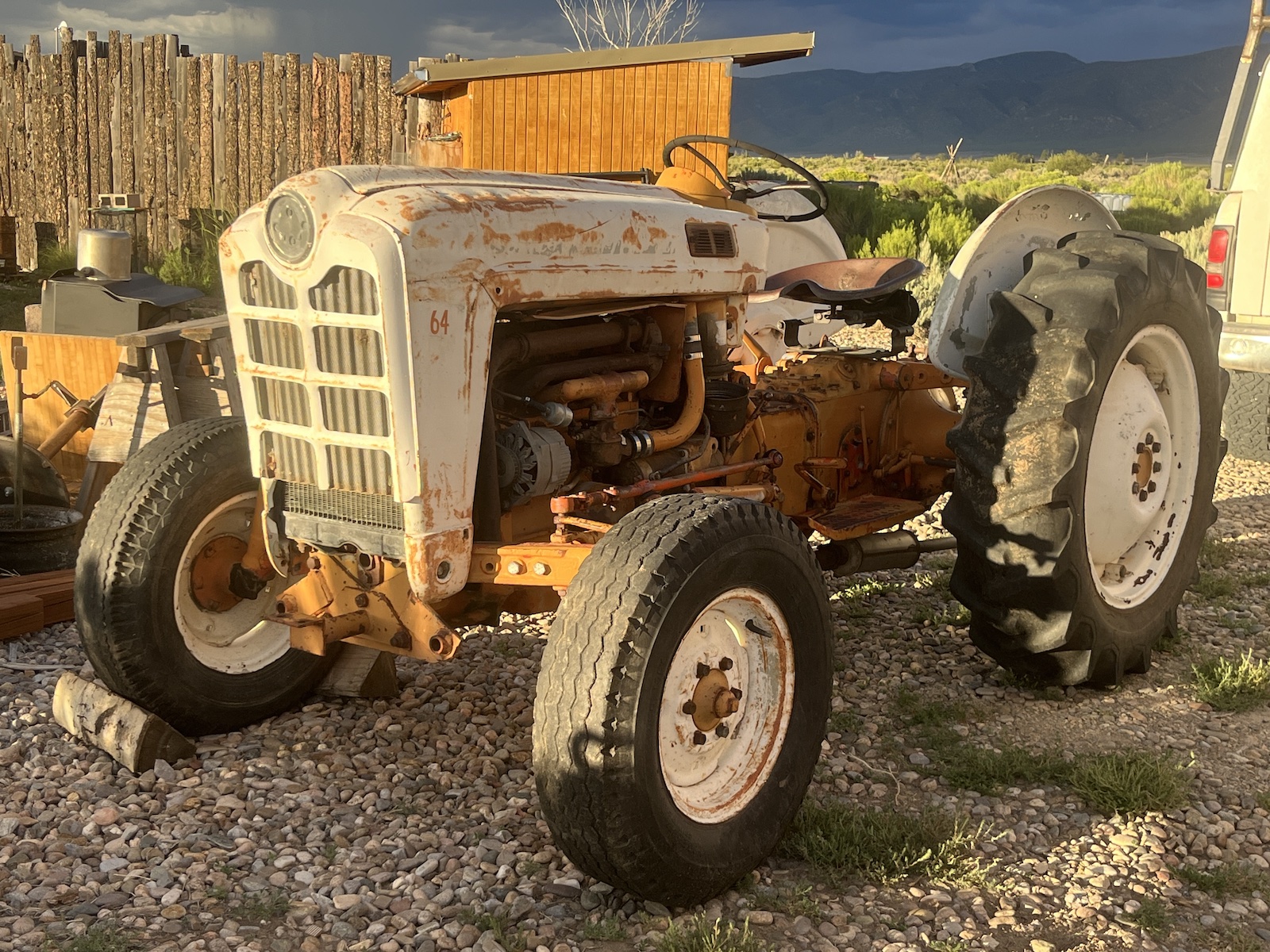

I'm new to YT and to tractors. I just bought a 1960 gasoline Ford 841 with Sherman that I'm hoping to get into service, and as I look into it, I'm glad I didn't pay more. This will be a project.
When I shined a flashlight into the spark plug holes I saw what looked like some kind of petrified crud on top of the #2 piston. (Head gasket?) The borescope I ordered hasn't gotten here yet, so I tried out my new compression tester -- supposed to be a good brand, Mityvac.

Here's a picture of it right after I got it home, before I started pulling it all apart.

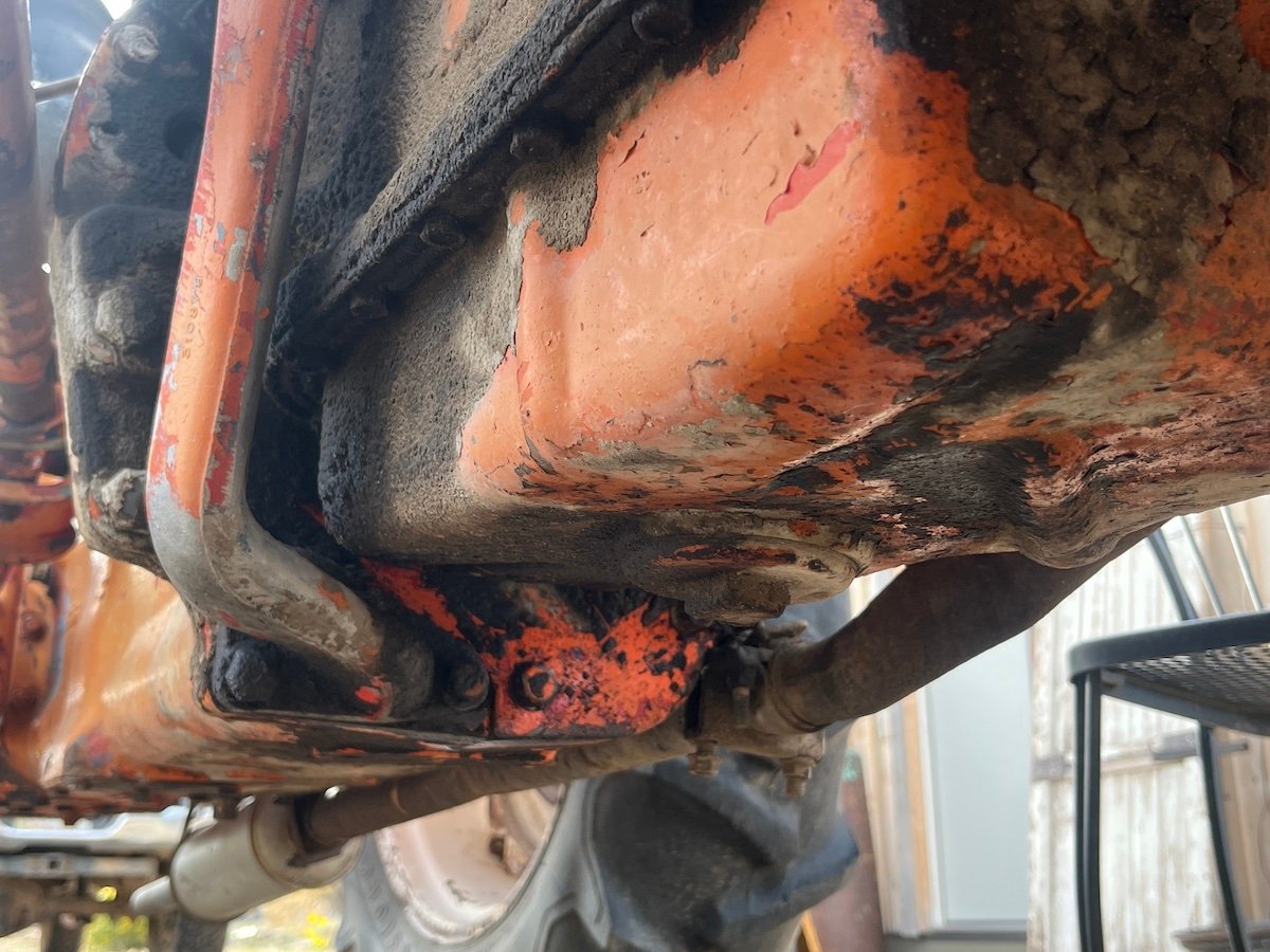

Thanks guys! Just a follow up. It took me a while to figure out how to drain the flywheel water. One of the bolts that holds what looks like an inspection plate (?) onto the transmission is a through hole, so removing it drains the fluid. You guys were right -- about a gallon of water, followed by a few engine oil creepy crawlies that slithered out. Here's a split second video after water gushed out for a good 5 seconds or so -- I thought I was taking a photo (I can understand basic mechanics, but I will never master an iPhone).

That hole is not a drain for the bell housing. It appears to be a blocking plate for the hydraulic tubes, in place of the hydraulic manifold. A picture of the right side of the tractor while standing near the rear of the right front tire should verify this. You drained the hydraulic chamber. The dipstick for it should be in the round cover on the left side beneath the seat where the PTO lever is.
Here's a better picture. The drain bolt is next to the hydraulic manifold, but in a separate plate. It was definitely water and a little curdled engine oil, not hydraulic fluid. The trans and hydraulics are both still full (of oil).

I don't see any picture. However on my 1957 840 that hole is a through-hole leading to the bellhousing compartment of the transmission. So that's what you were draining. When I pulled that bolt nothing came out, I had to stick a wire through to confirm it wasn't a blind hole. My tractor didn't have a seperate plate, just the Engine Rear Cover Plate (Parts Book nomenclature). However they changed the transmission case starting with serial number 14257, Jan 1958, and apparently went back to earlier rear engine cover design, at least as I am reading the parts book which is kind of confusing.

Woops, I was rushing out the door. I attached the picture to the last post, where it belonged. Thanks for verifying that through hole. There are no other drain plugs under the trans near the bellhousing, so I guessed a through hole and was right -- there had to be some way of draining it.
