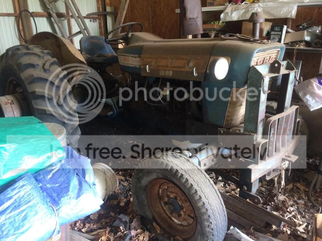

Can someone please give me a ballpark figure, of what this tractor may be worth?
I'm asking for a friend, as her husband has passed away. It runs. Needs a battery.
Thank you
It's not a '63 for starters. It's '65 or later. If the left rear tire is as good as the right, $4000.00 to $5000.00
67-68 model 4000 but it's had a late model engine swap, I see a oil fill in the timing gear cover and a right side dip stick of which neither came on a 4000.
I see several dollars worth of rear wheels weights, some type of snow plow mount, if the rear tires are good it'll bring $3500-5000 here depending on how it runs.
Thank you very much! As i said, her husband has passed away. And she doesn't know anything about tractors. Your input is very much appreciated.
She's located in Maryland. I don't want her to get screwed over. Thanks again :)
