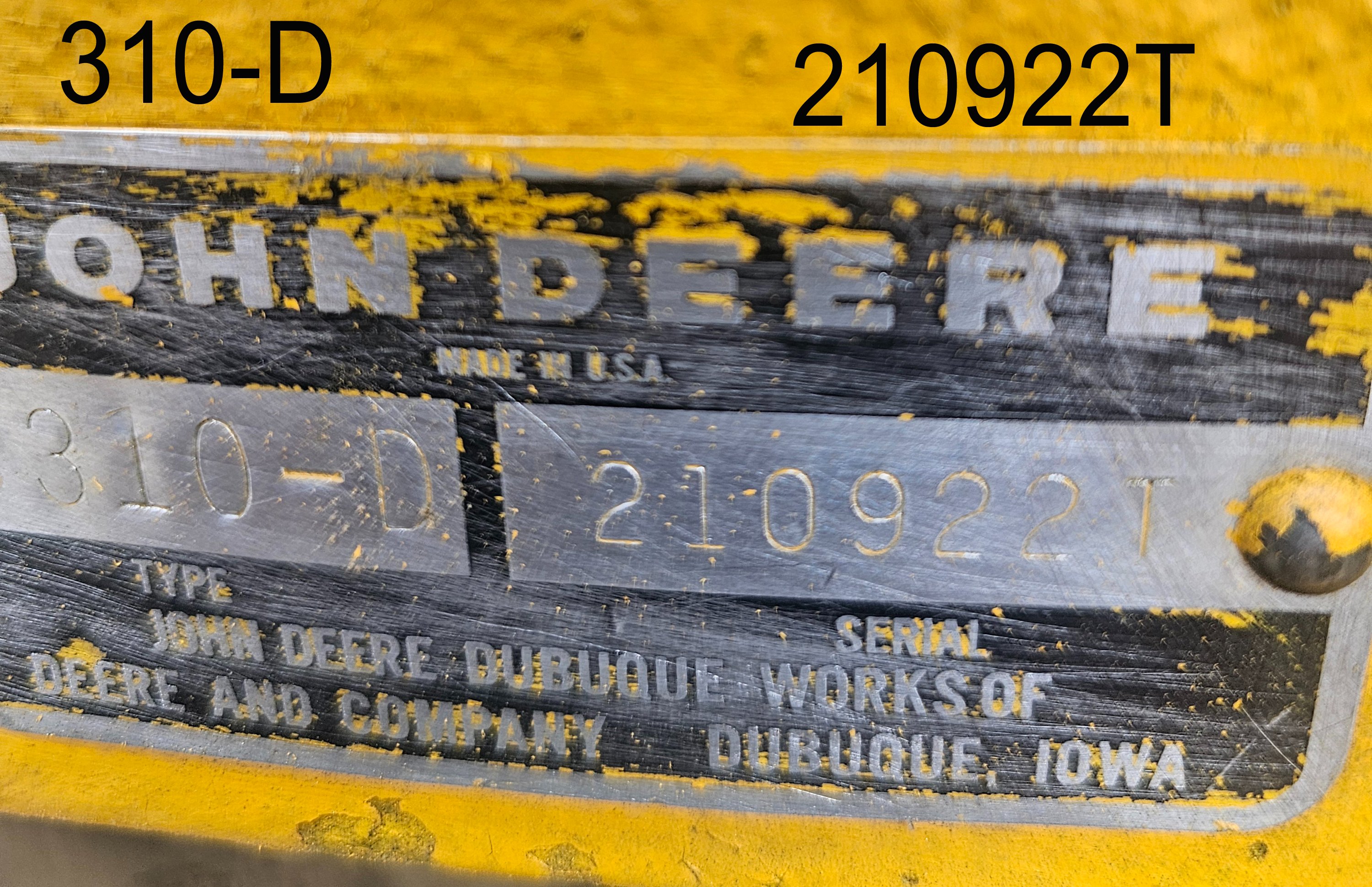

Thank you for pointing this out. My information from above is from unverified online sources. I have also found this unverified source that lists the 5th digit as follows:
5th Character (Engine & Transmission Combo):
B = Diesel, Collar Shift
F = Gasoline, Collar Shift
D = Diesel Engine with Hydraulic Direction Reverser (Power Shuttle)
C = Gasoline Engine with Hydraulic Direction Reverse
At least I was able to learn that the type 310-D is not a JD 310D, which was certainly confusing my research.
I have purchased the pdf version of the service manual to help my neighbor fix his machine. It has been quite helpful, but questions remain. He explained that when he disconnected the linkage at the transmission, and rotated the lever, he could feel three distinct clicks; reverse, neutral, and forward. The manual is clear that there are only two detents, with no neutral.

I agree that serial # plate adds to the confusion. I was employed at an AG only JD dealer from '65-'87 so my personal knowledge of JD industrial tractors is very limited. The JD AG tractors shared a lot of the same components as the JD ind tractors
I believe they started building 310As before the last of the 310s. The 310A (no dash ahead of the letter indicates a series of the model) used a D to indicate the collar shift with reverser. It is possible that designation got put on a 310 tag at the tail end of the 310 model production run when mixed with 310As.
Industrial serial numbers are not near as well documented as the JD Ag tractor serial numbers. I have seen similar issues around the 350 and 450 crawler serial numbers.
