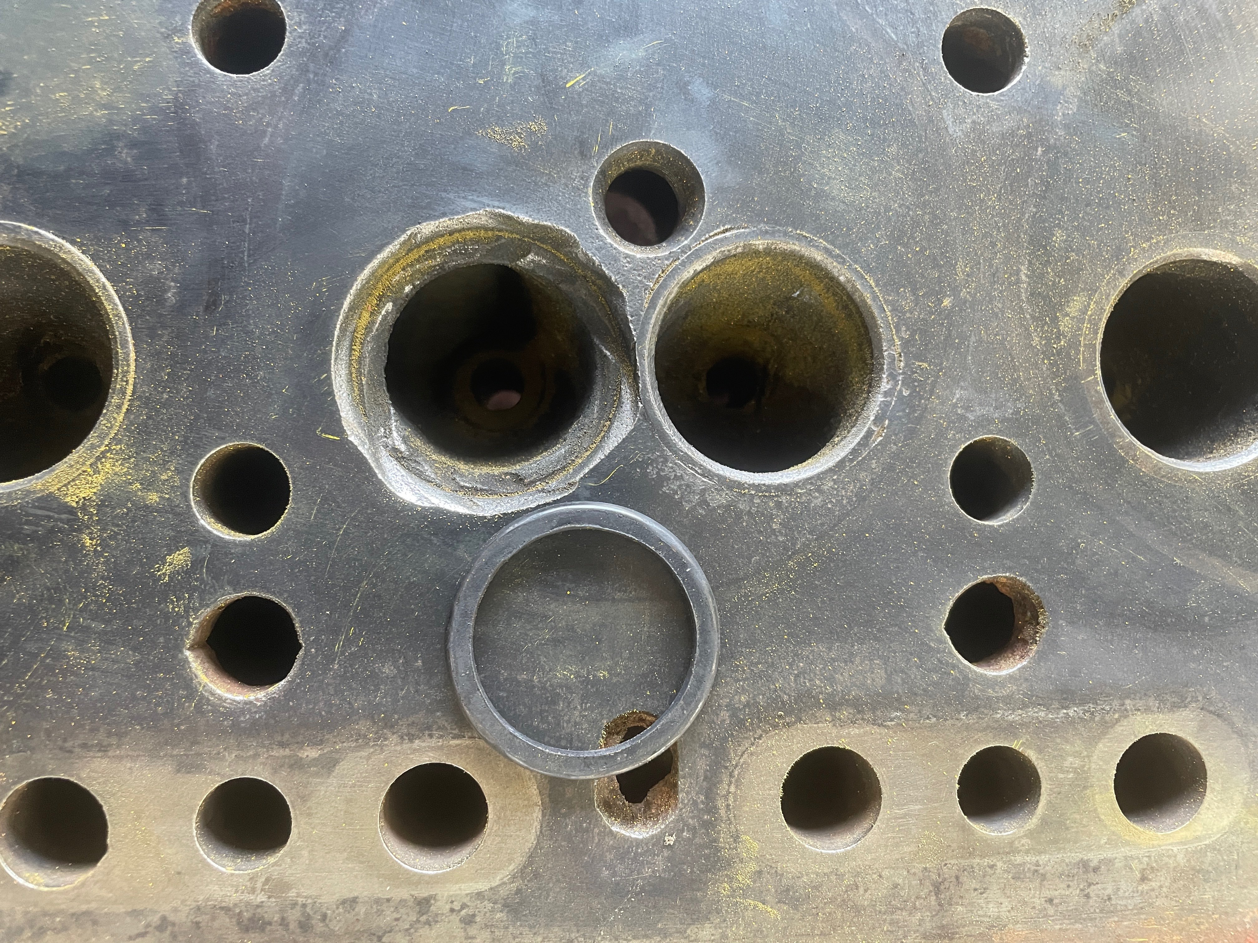

Sorry. It’s a 3 cylinder, 2.4l gas engine. We had a valve seat drop out.

The seat fell out. The previous owner continued to run the engine and so the valve and the loose seat beat the heck out of the head. Here’s a picture.

Put an oversized seat in it. Not a big deal. Any decent machine shop should be able to do this. Very unlikely you will find a head, 885Gs are very low production.
Pretty sure the diesel heads started as the same casting. A creative machinist could likely modify a diesels injector holes for spark plugs. Issue is the diesels don't have inserted valve seats, so you have to do 6, instead of just repairing one.
I think the blocks are 100% the same.
Ii suspect the gaskets are the same. cheap enough to gamble on.
Thanks for your advice. We are hoping the oversized seat will solve the problem. We will find out next week. I will order the gasket set. I didn’t know the diesels don’t use the inserted valve seats.

Here's an update...just received the head back yesterday from the machine shop. The oversized seat and a new exhaust valve did the trick.
