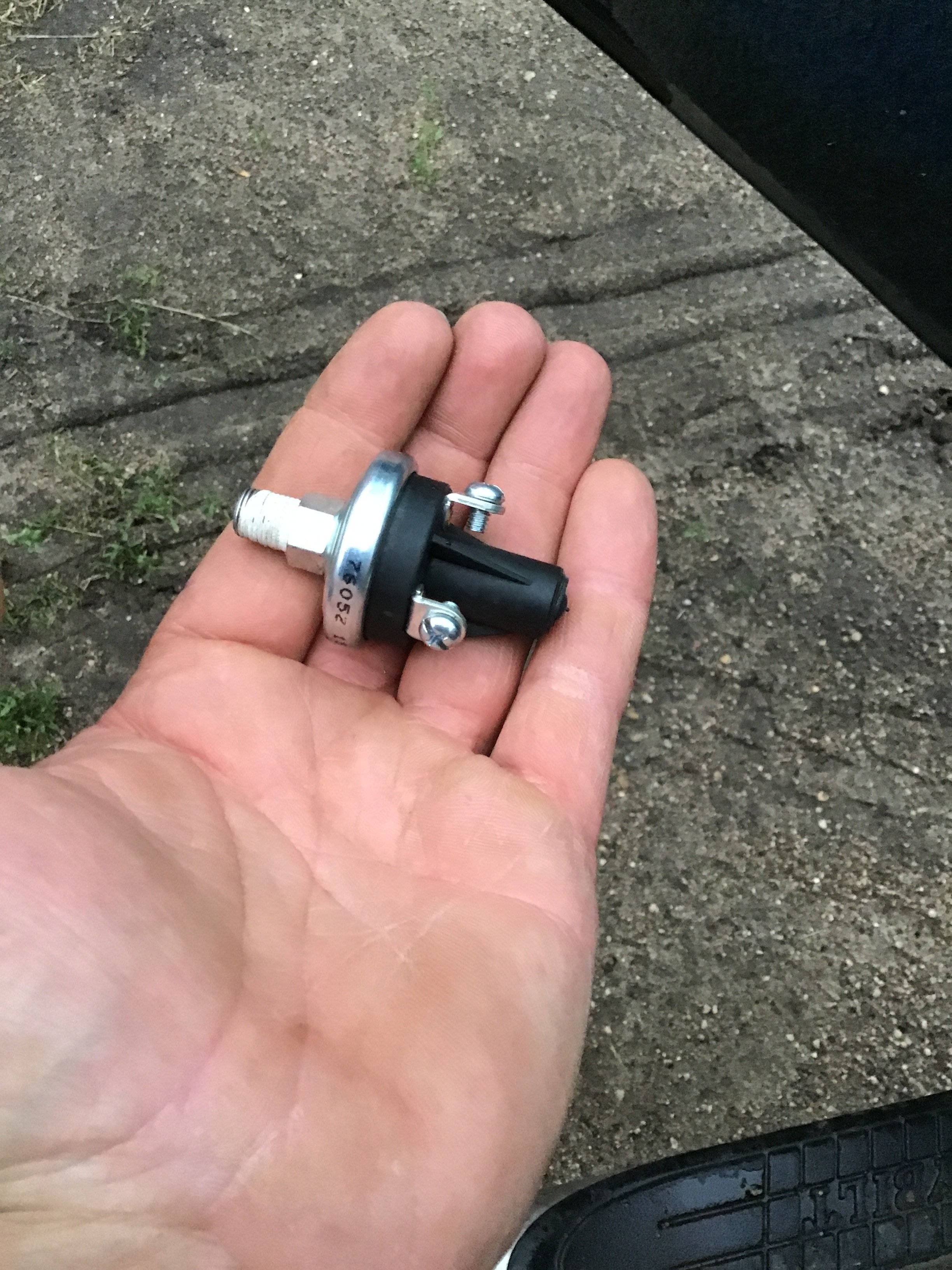

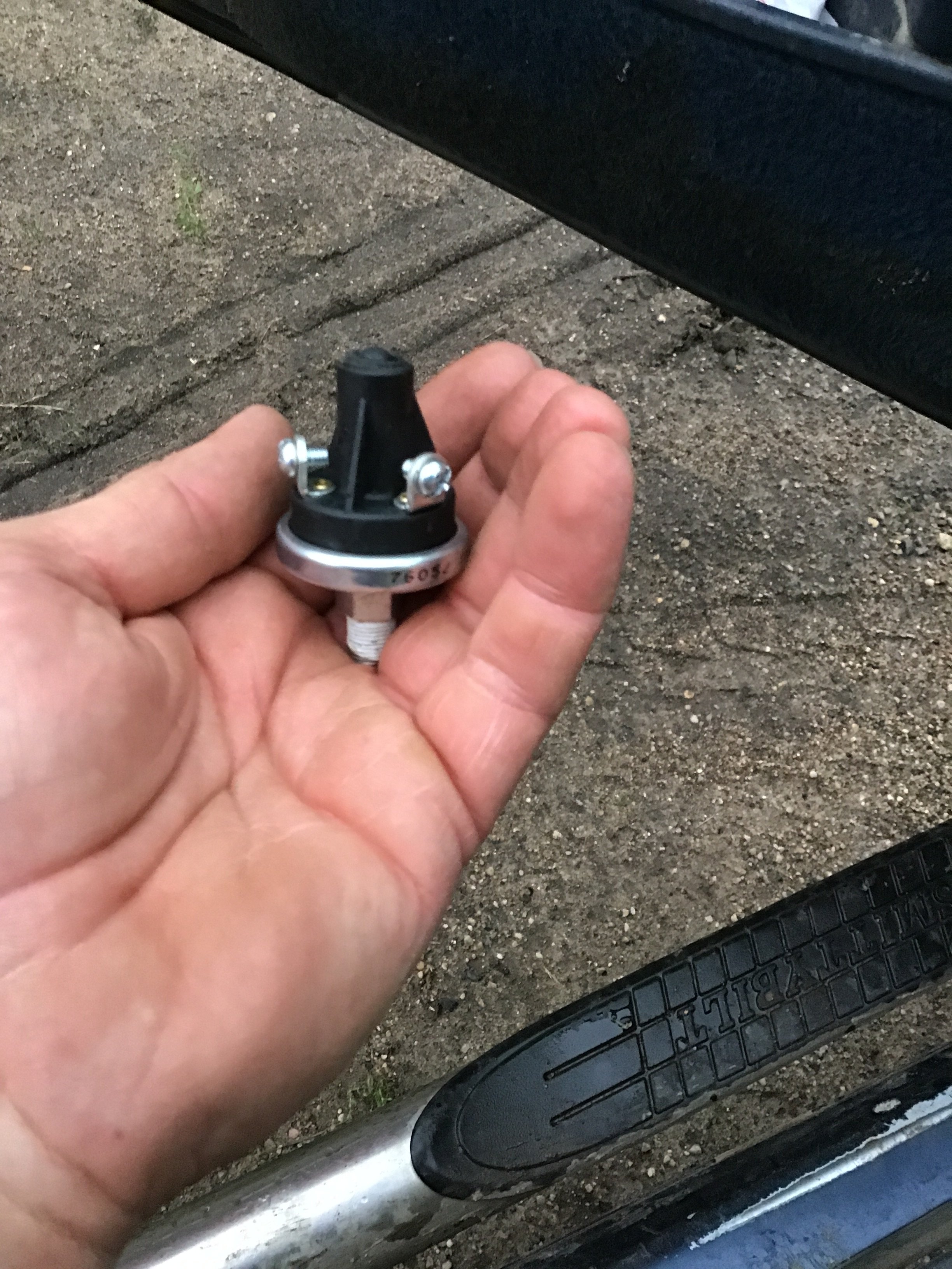

Is this the wrong part?
I picked this part up at the dealer back in early April and just got around to installing it but it doesn’t appear to be the correct part even though it came in a bag with the correct number.
Thanks for any help

So the part they gave you is the correct part number but the wrong part?
Did the wrong part have 2 terminals but the correct part only has 1 terminal?
Thanks for any help
Correct part should have 1 terminal. They told me they have the problem fixed now
