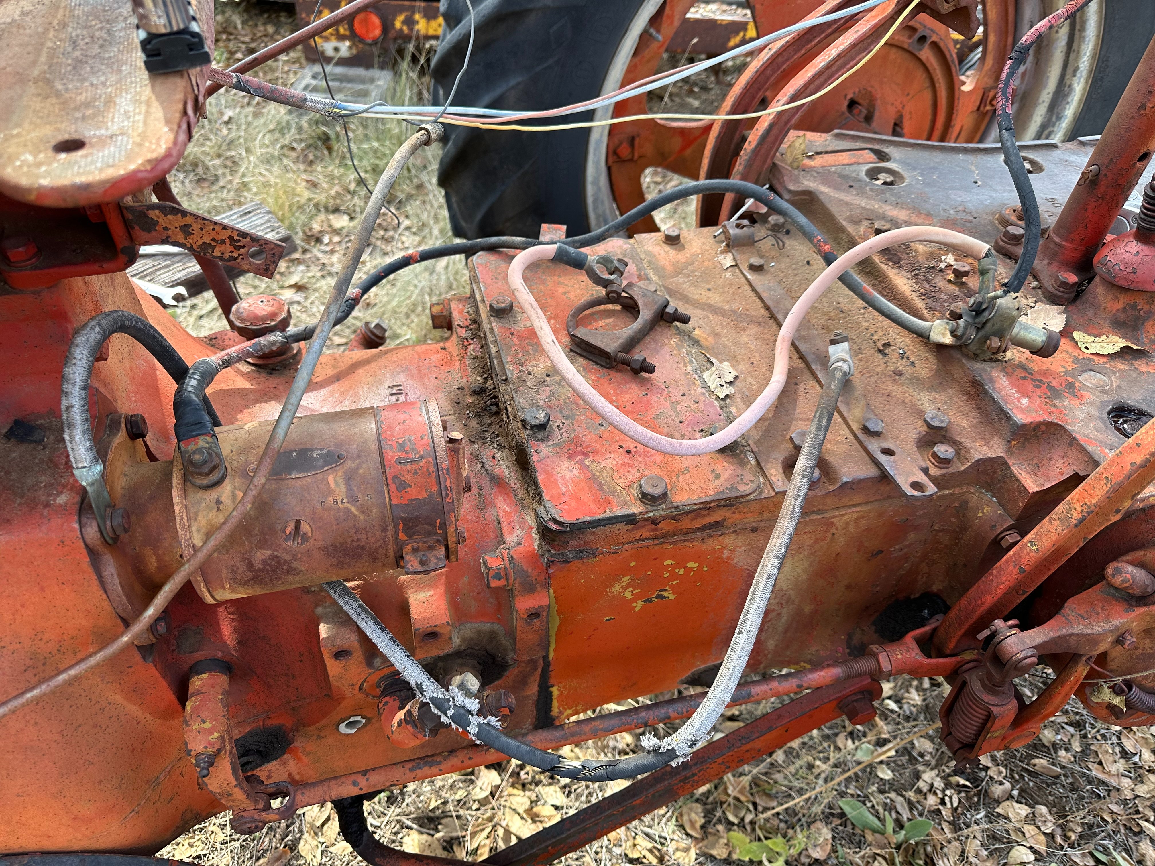

Only 3 bolt nose starters for a M were used on a MD. If you have 3 bolt mount it's a MD housing or a stage 2 SM housing. If a SM 3 bolt mount a starter from a 300, 400, 350 or 450 and some others will work. Part of those are 12 volts. Use magnetic switch on starter or just cable to stud from kick start switch or whatever. If MD center housing you may want to repair what you have as the hole starter bolts in is a different distance form ring gear than a SM housing with a 6-digit number ending in R1 is. Maybe you have a stage 2 SM. If you have a MD starter it would have the stud cable mount. Some of the two bolt and three bolt starters can have noses and armature that can be switched around either way. Picture of 450 12-volt starter I put on a 2-bolt nose. Have put M starters on 3 bolt noses also.

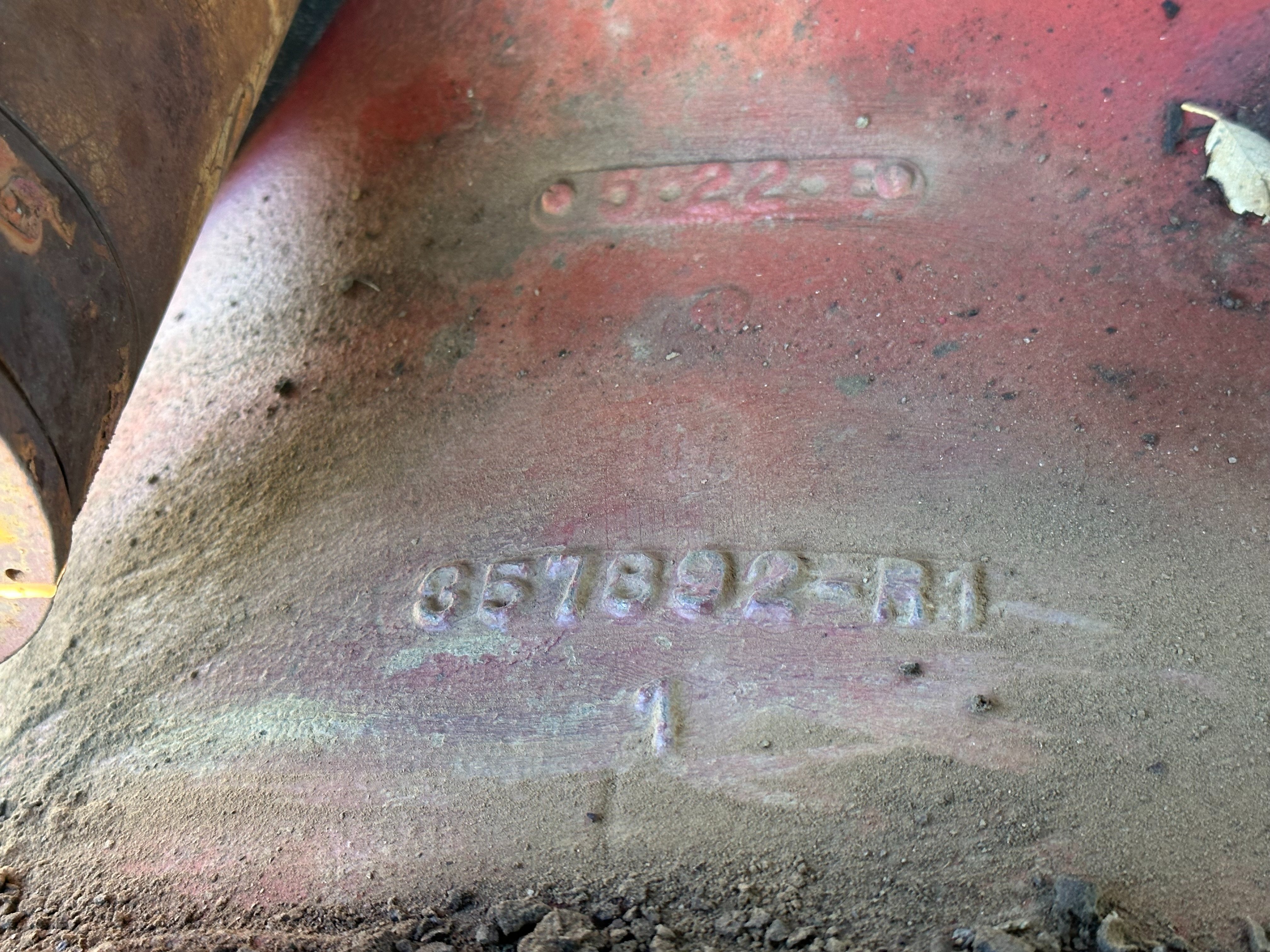

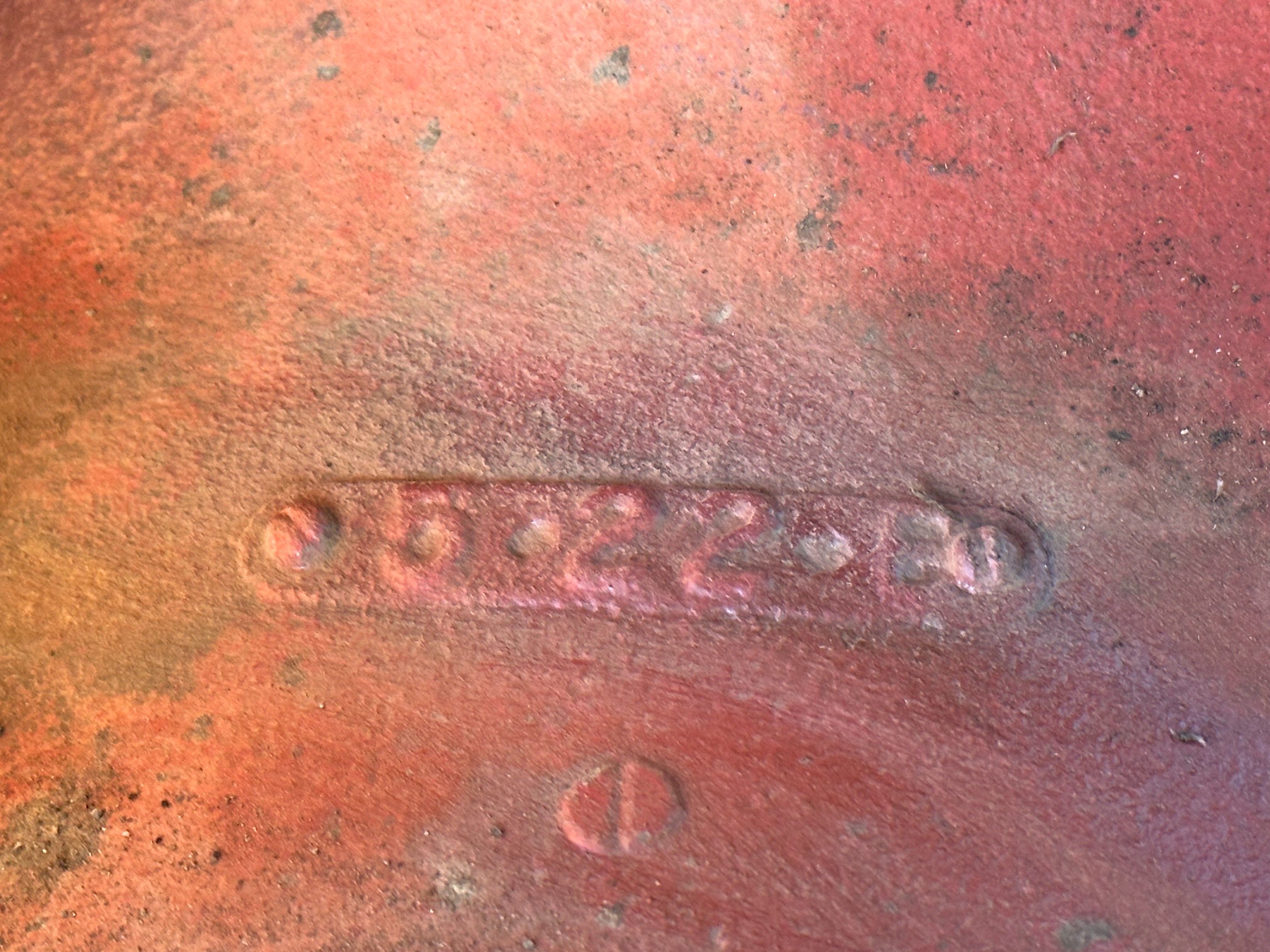

IMG_1181.JPG IMG_1183.JPG IMG_1387.JPGIMG_1137.JPG This the casting numbers on the clutch housing and what is stamped on the starter data tag. There isn't a data tag on the clutch housing. The engine is stamped X 1 and that is gasoline. The engine cover has a M on it so I assume it's a M and not a SM and not a MD (diesel).

Looks like you have a replacement center section. Have had a couple of those and I think you will have to make your starter lug or pull switch yourself. I think that all of the three bolt starters were saddle switch from IH and probably some one swapped the nose on yours to keep the original wiring set up when the center section was replaced. What year is your tractor? The ones that I have with the newer center section were early M’s that had been loader tractors. Good luck, Mike

It could very well be a replacement section... I could have a Frankenstein tractor. It has Lambert disc brakes 3-bolt covers, and a flip up rear seat that has a base to be mounted to a tool box or under seat battery box. Tractor doesn't have a battery box under fuel tank but has the mounting strap and the seat was mounted to a chunk of I-beam (ha,ha). Some of these items are stated as optional in the parts book (not the I-beam) but I don't know. It will definitely be a conversation item.
From the casting numbers I think it is a 1947. The engine has FBKM 131495

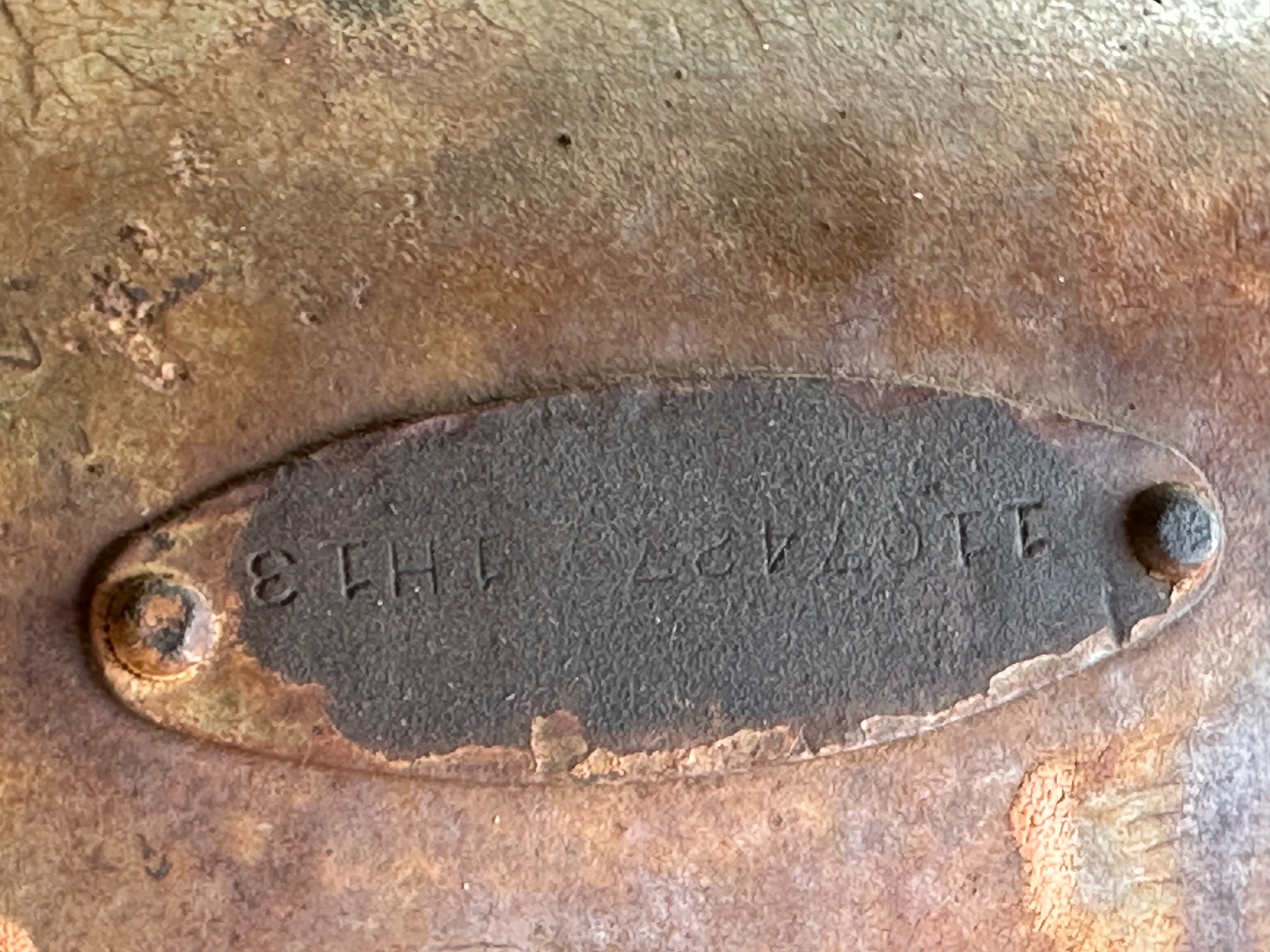

In your picture the Delco Remy tag is still on the starter. There should be a seven-digit number on it that begins with 11 stamped into the tag (there will be some other code stampings separate and following the number). That number may not be the solution, but it may be a clue. The number can be used in a search to see what other starters with that number look like or cross reference to. It may turn out to be the Delco Remy number for a starter with the two-bolt nose.

View attachment 132493 View attachment 132494 View attachment 132495View attachment 132496 This the casting numbers on the clutch housing and what is stamped on the starter data tag. There isn't a data tag on the clutch housing. The engine is stamped X 1 and that is gasoline. The engine cover has a M on it so I assume it's a M and not a SM and not a MD (diesel).
That is a center housing like used on SM tractors F-28175 or L-504802 and higher serials or on SW-6 tractors that used frame rails. Gas or diesel on all those. Also used later as replacement housing for M through SM below above numbers. Starter parts to uses original starter were needed on models below serial numbers. Several starters will bolt up and work on the housing.

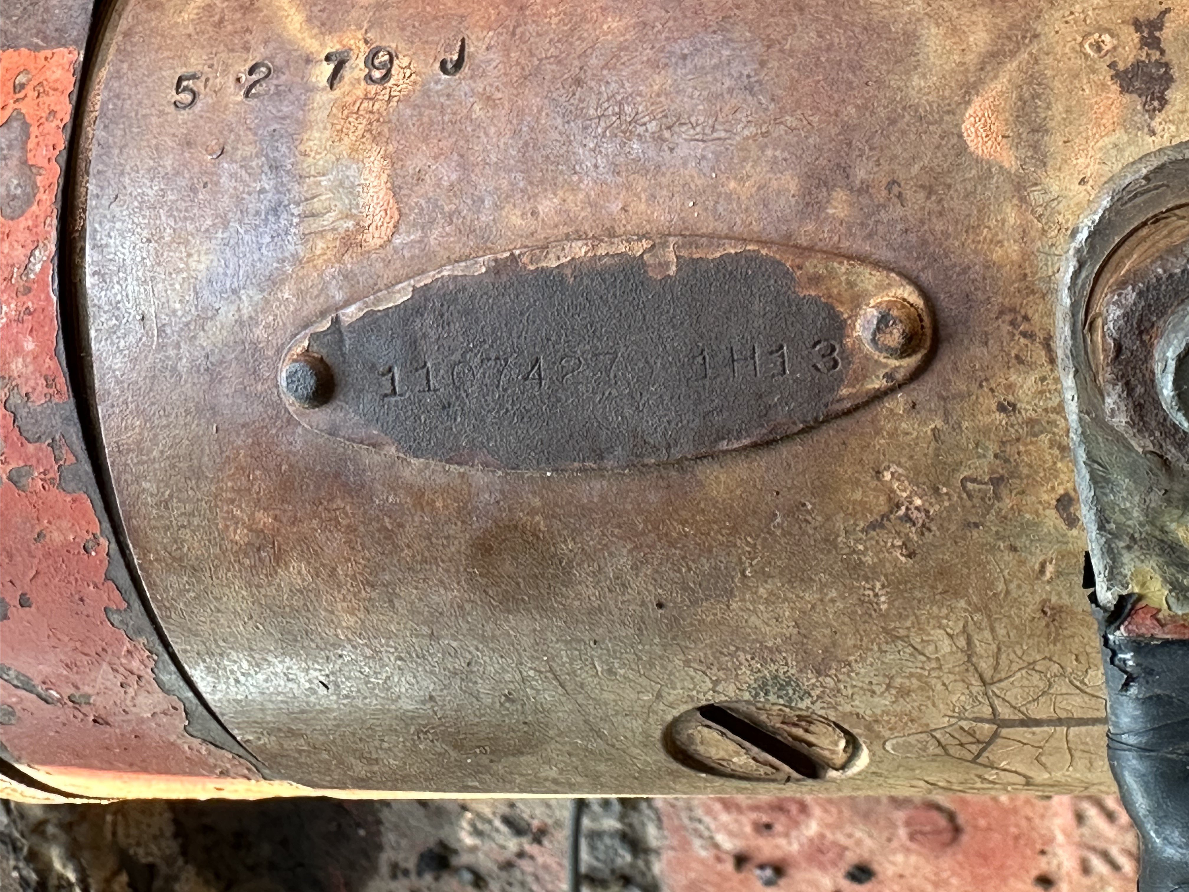

IMG_1135 -a.JPG I didn't notice the starter tag was upside down on prior post. On the tag is 1107427 and 1H13. On the housing 5 2 79 J is stamped. This number on the housing may be from a rebuilder possibly.

View attachment 132513 I didn't notice the starter tag was upside down on prior post. On the tag is 1107427 and 1H13. On the housing 5 2 79 J is stamped. This number on the housing may be from a rebuilder possibly.
That number shows up as having a 2-bolt end housing on the PartsASAP site. It says it is 6 volt and fits Ms serial number 28174 - earlier. From that I would say there is a very good chance the end housings will interchange. YMMV
More very interesting information. I was thinking that the nose would interchange with a 2-bolt unit. I may get a 2-bolt starter and see how it works out. However, contacting a remanufacture or rebuilder will be done to hear what they have to say since they work with these starters all the time.
