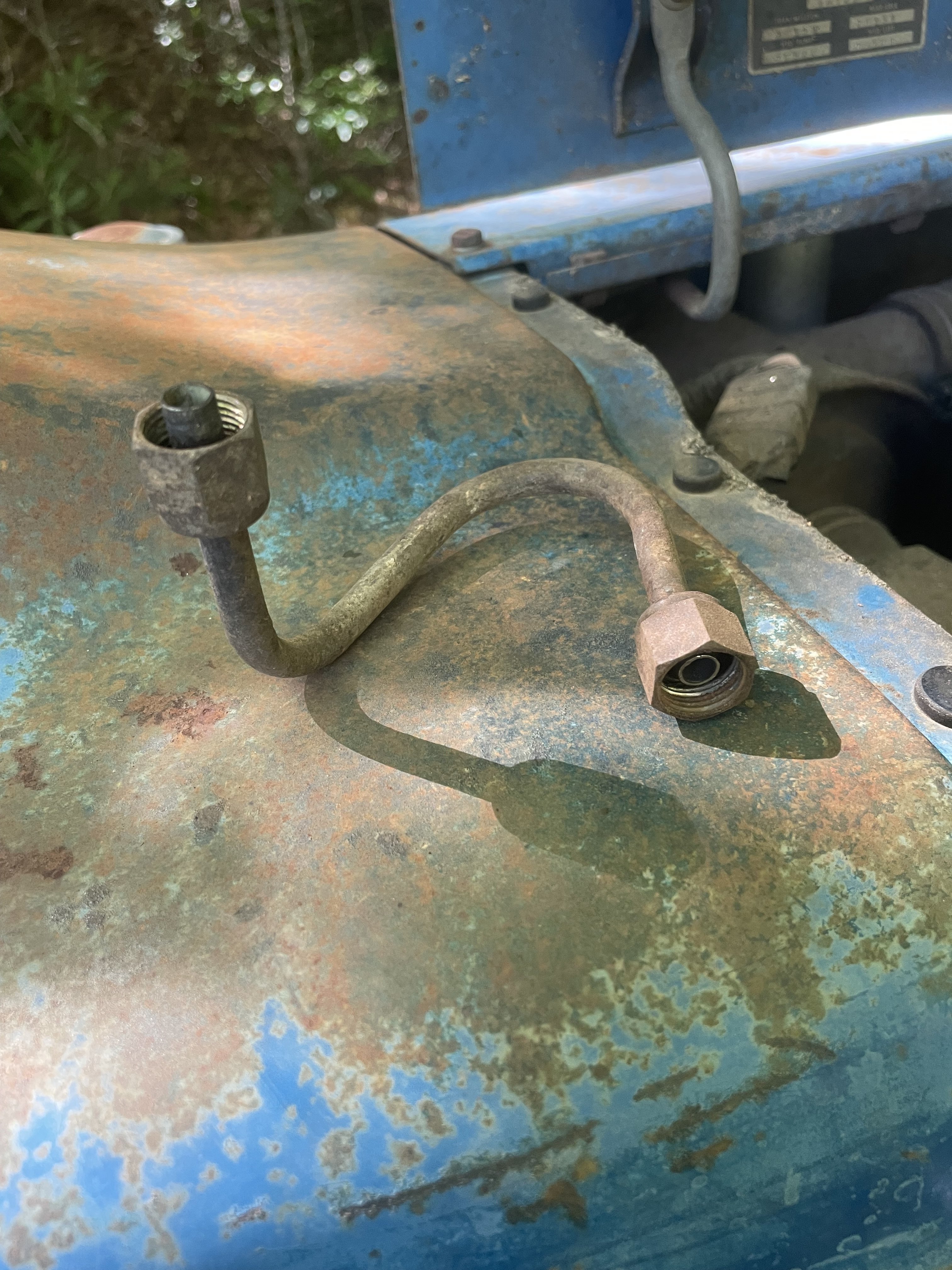

2000 Fuel line
Ltljon
Member
I cant find this specific line by its self or in the usual group of 3 for this model. It leaves the glass bowl & runs to the carb. The end either needs reflared or a furrel but if its replaceable Id just as soon put a new one on.
Best just to buy a straight & make it work?
Its on the carb side tho but I may still have to come up with something like that.
I think shaun means he makes a new grommet by cutting a piece of fuel hose1/4" long are so long. I have made the grommet are used some I had on hand. The original is not flared its just a length of steel line.
I went by Napa to see if he had anything & get a filter. He did the sane thing, cut off a small piece of gas line. Ima give it a try this week.
Those grommets are used elsewhere maybe on a diesel are a Fergusson tractor... I am sure I have some I don't remember what they fit.
