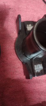

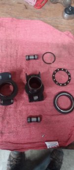

Working on a 4cyl 2000 that has a terrible hunting problem. Pulled the governor and found a few flat spots and was looking to replace the worn parts, but can't find internals just a complete governor. Does anyone supply repair parts for it or just the whole unit?

A new one is just a little over a hundred dollars plus shipping on this site. Its kinda like water pumps and fuel pumps time find parts you spent more time trying to find the parts.

Weld/fill and grind flat. Can't make it more broke.
