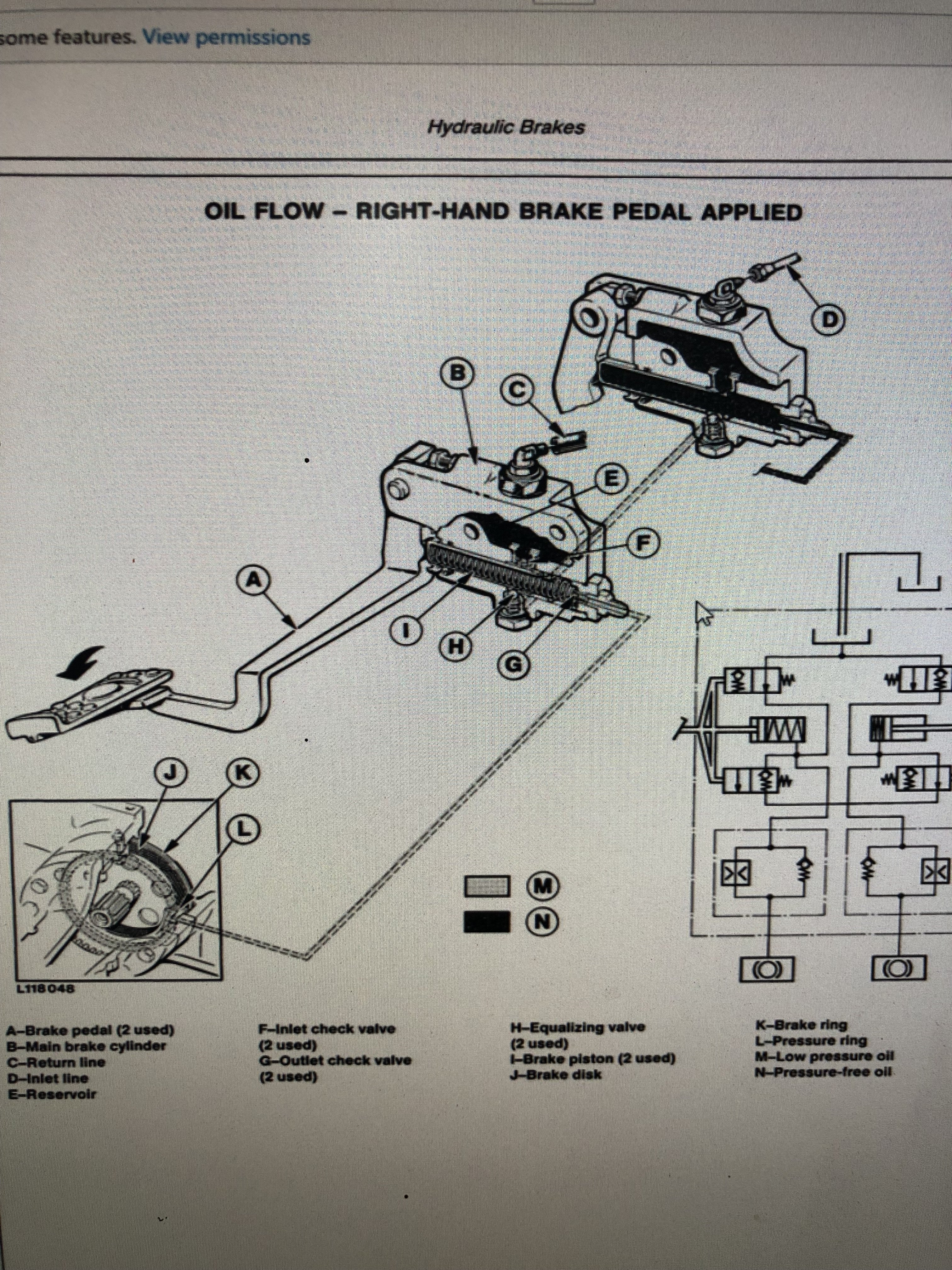

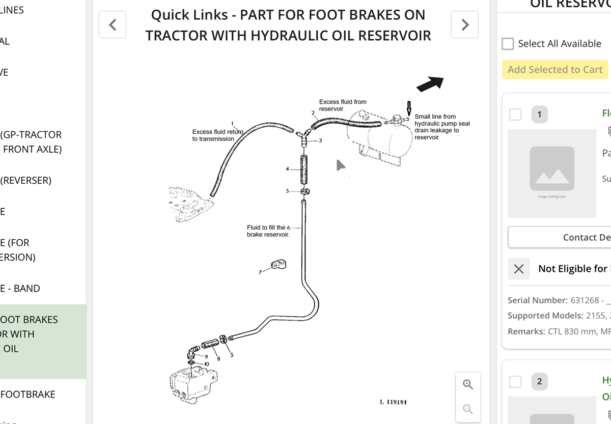

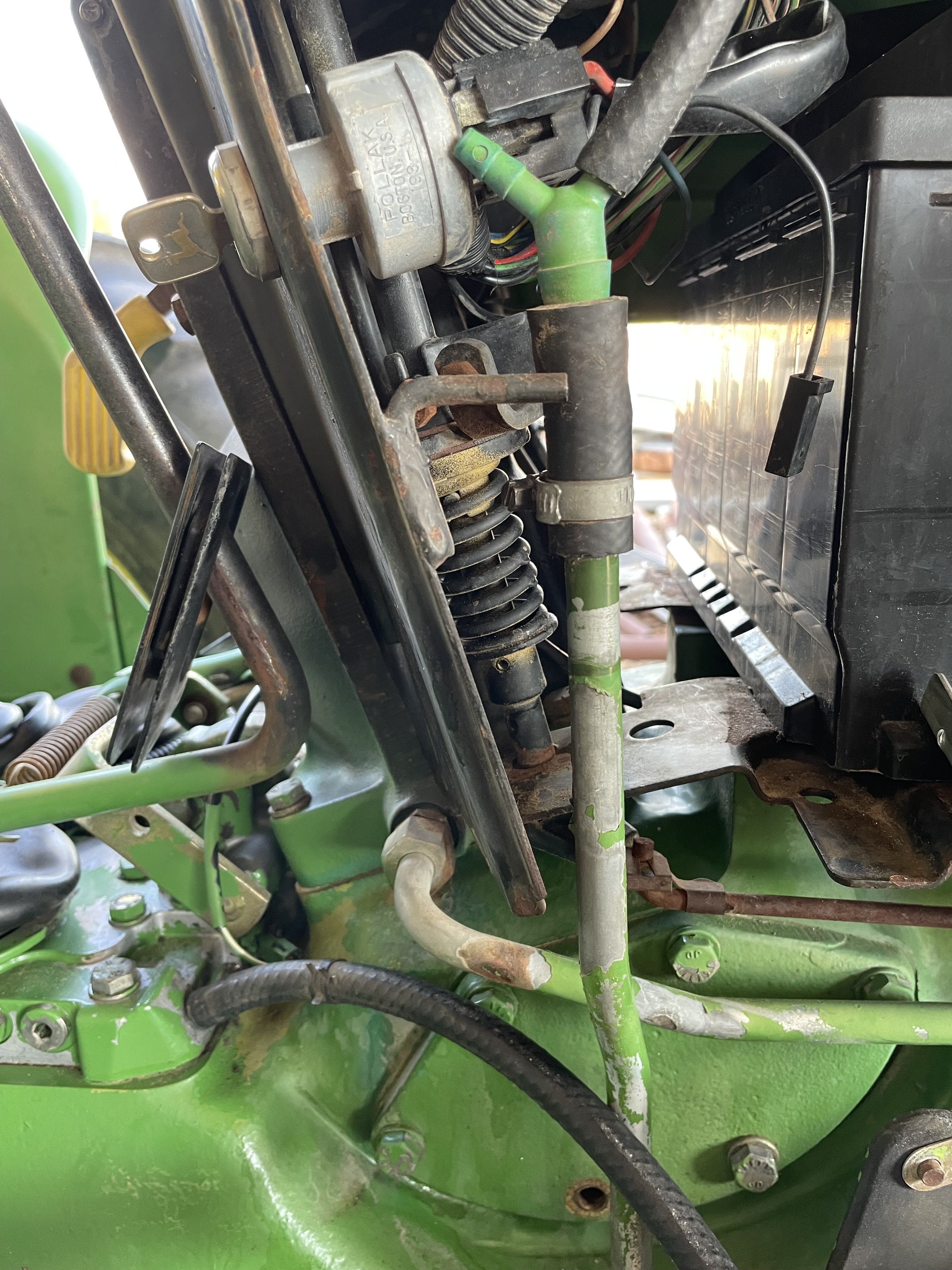

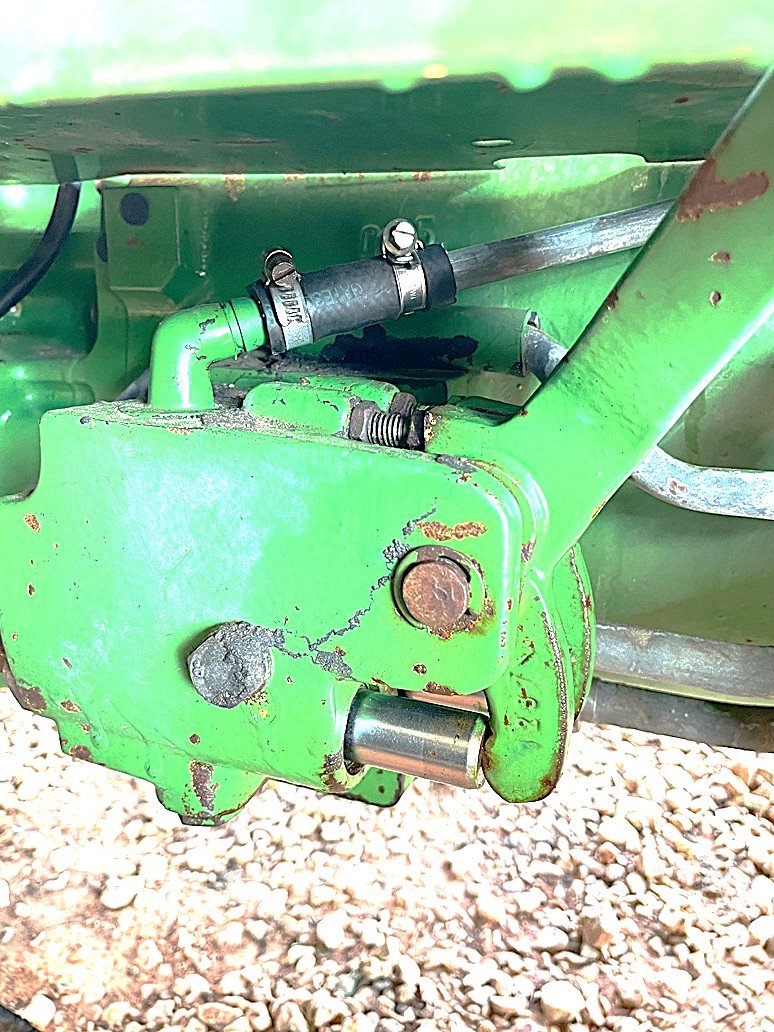

It appears to be fed some by the excess flow line. That excess fluid line is where the reservoir plug is in some of the earlier ones.I believe that flexible line is a drain back to the transmission case once the reservoir fills and would be the same off the brake valve since it should be fed by the high pressure pump after the steering but I’ll double check that in the morning.
there should be a brake line off each side of the valve that heads to each brake. Then is there a 4th line? Or is that it? It’s possible that it could connect to the case and get fluid from an internal line but I thought it was external.
If it is getting fed from the oil cooler return as some are, I believe it is internal. Without the right flow drawings and info in TM4436 this is speculation.
