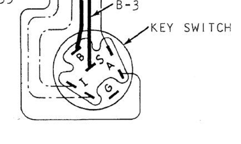

Went to JD and got a switch, but the terminals aren't the same as the old one, so what goes where ? I assume the BAT goes to the battery, and the black and red wire going to the starter and solenoid go to IGN ? And ACC obviously means accessory ?

Yes, it's the right switch but what wire goes where
The picture below from a 2030 Technical Manual (uses the same ignition switch) will tell you the switch terminals, if that is what you need. If you don't know which wire is which, you need 2240 Technical Manual with the wiring diagram to chase them out. I don't have a 2240 manual, but the 2030 manual has some wire color info that helps for a starting point, provided colors are visible and have not been "repaired" over the years. I expect the 2240 manual is similar. A test light and a jumper wire can be used to figure out what each wire does, but that is a hands-on thing you need to do. Be sure the tractor is in neutral or park before applying power to any wires.

Guessing your 2240 diesel has a mechanical stop to pull. If it was wired similar to the other JD models of those years, you need a battery power wire, which should come from a circuit breaker on the battery terminal of the switch. You need a wire from the start terminal of the switch to one terminal on the neutral start switch. There should be a separate wire from the second terminal of neutral start switch to the start terminal on the starter solenoid. A third wire likely would go from an accessory terminal of the switch to the indicator lights for the oil and alternator (alternator light circuit would also excite the alternator).
Has this electrical system been worked on (hacked) before? From what you are posting it doesn't sound OEM, if there is a wire from the switch to the starter and a wire from the battery positive to the switch. Colors are no help here; they might be if you had the manual to look at. You are going to have to see where the other end of each of the three wires you have goes. I can tell you where I think they should go, but I can't chase them out to the ends from here.
