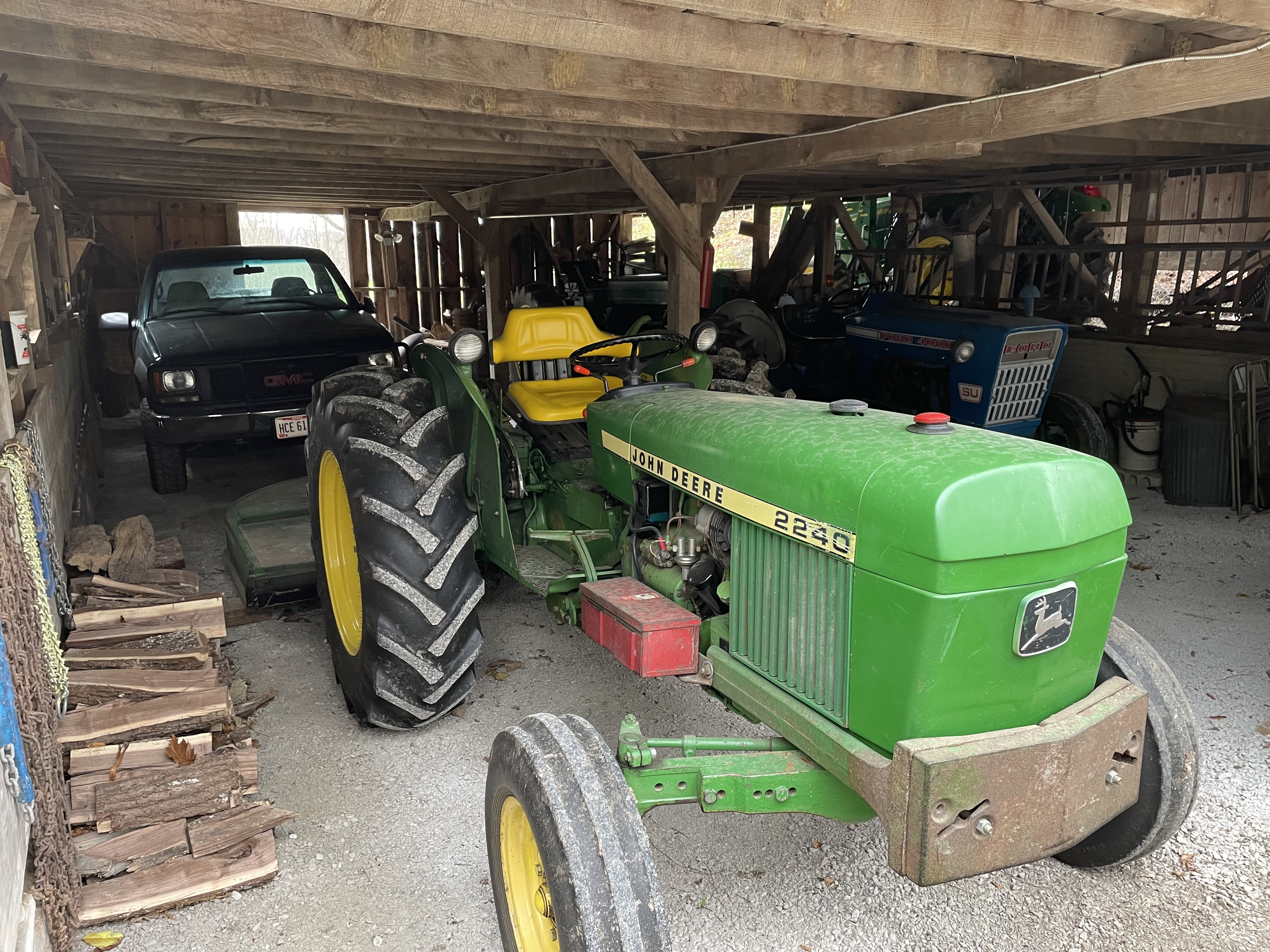

We have one. It’s the early version. Independent PTO. And 2 speed power shift. Low/horizontal exhaust.
Best tractor for mowing around trees and hill sides. Really like the strong power steering, diff lock, foot throttle, strong brakes.
