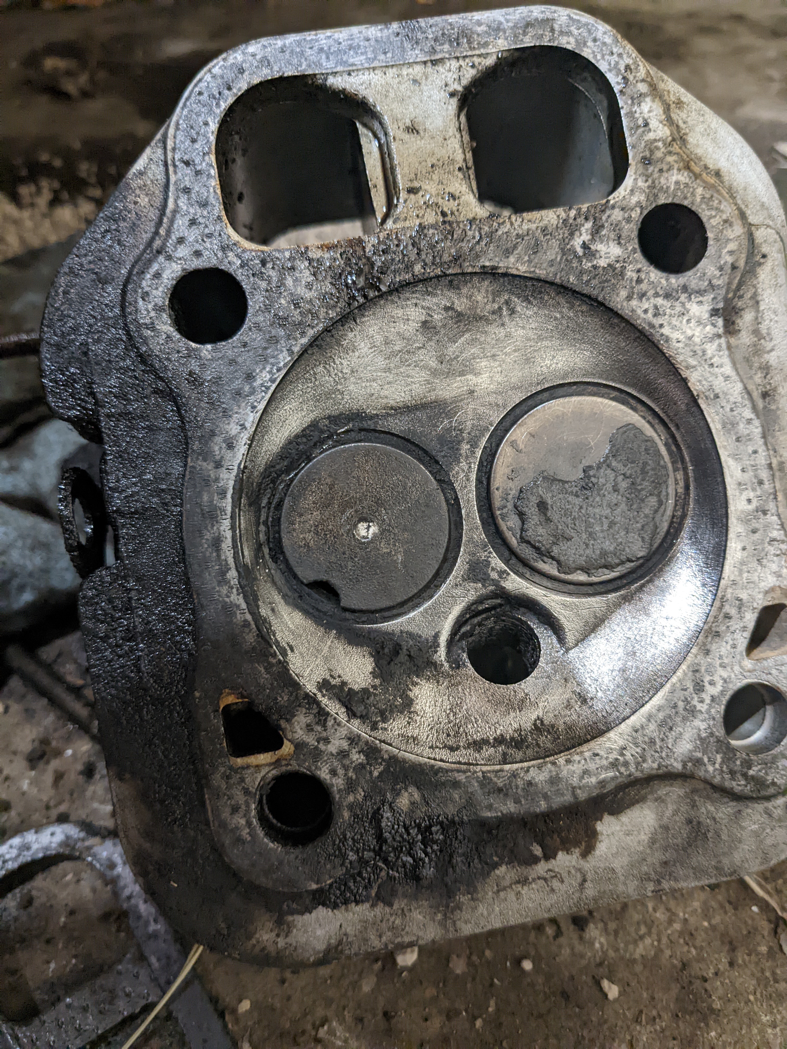

My mower engine quit while I was mowing yesterday.it will run on one cylinder with the spark plug removed from the other side.I’m thinking an exhaust valve not opening and the compression choking down the engine?I didn’t take it apart yet to diagnose the problem yet.any experience with this?kubota zg23 mower 23 hp Koehler gas engine
I have a CV22 Kohler apart in my shop for the same symptoms. This one has a chunk gone from the exhaust valve. I've also seen the valve seats come out of the head on some of these engines too

I would remove the rocker cover on the cylinder you have removed the sparkplug. See if the intake valve is stuck open. I've seen plenty of stuck valves on the kohler engine. This occurs from an overheated cylinder, usually caused by a rodent.
I have a CV22 Kohler apart in my shop for the same symptoms. This one has a chunk gone from the exhaust valve. I've also seen the valve seats come out of the head on some of these engines tooView attachment 62466

Update:pulled the valve cover,the rocker hold down bolt had backed out but the threads on the bolt look ok.funny thing is the fuel pump is mounted to the valve cover and the actuator arm is run by the rocker going up and down.that arm was holding the rocker in place
