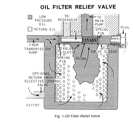

Hoping someone can help me.2955 is bursting the hydraulic filter canister.Obviously fluid cant return.Am aware of the bypass valve ,but shuoldnt the filter port be clear in the housing ,and where does it enter the cavity?Missing a gasket on the cartrige filter and think it plugged the return port?

I think Tx Jim has headed you in the right direction, that is actually the transmission filter, if that is what you are looking at. It is located on the bottom right side of the transmission. They offer a non-ported or ported (1 port) cover. The ones on my tractors are heavy cast metal, and I understand there is a lighter stamped metal type from other forum discussions here around installing loaders and might be what you have.
The oil filter relief valve should be in the side of the transmission. On a 2030 it is behind a hex plug above the filter location, I am not sure if your 2955 is the same. This is where having the correct set of manuals would help you. (TM4436 Operation & Test, TM4436S OP & Test Supplement, and TM4449 Repair for a 2955). The picture is what the 2030 TM shows for the flow path through the filter, I expect yours is similar. If the attached parts link is the right one it appears to be similar.

Yes, that drawing is correct so the filtered oil goes directly to the pump ?
But if that is the case, that it goes directly to the pump, that would explain why I can’t blow air through it, correct ?

Strained but unfiltered oil from the pump . And a return hose from a loader SCR . both route oil to the unfiltered side of the filter .
Any 165psi Oil flow through the filter that exceeds the demands of the transmissions High/Low , PTO clutch/brake and transmission lubrication . This leftover oil Is routed to the front pump , oil cooler and storage tank .
So if I understand you, the filtered port would not be open , meaning, I can’t blow air through it, correct ?
