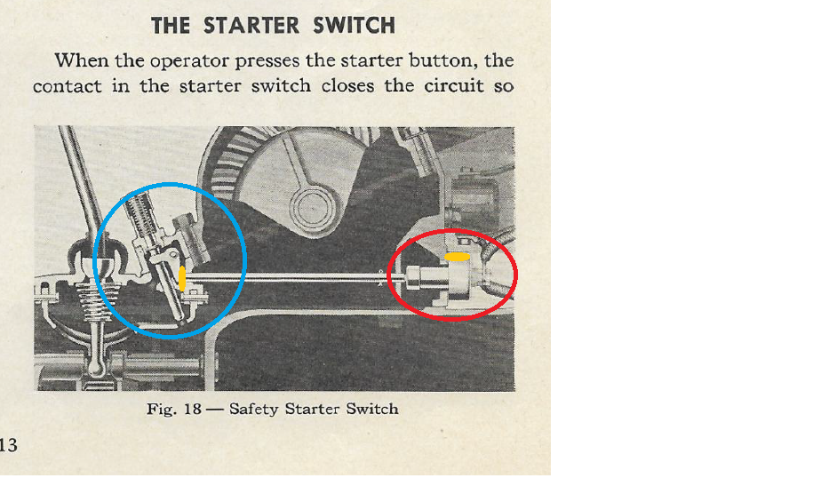

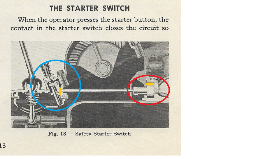

I have read here that the starter switch assembly wears down to the point where it won't work. The fix is to drop a coin in it. Apparently the coin goes between the back end of the rod 9N11512 and the lever 2N11515 that pushes it. I have yet to see a post that actually says where to put the coin, but that seems to be the only place for it. The parts are illustrated on the bottom of page 123 in the FO-4 manual. The link in the post for a push rod from Steiner is a valve train part.

In the picture below, the starter switch is circled in red. The coin is the yellow thing that is on the starter switch. I have not tried it, but I am quite confident that while it is exactly as described, it is not as intended and will not work. It would fall off as soon as the engine started, but since the engine will not start, it may stay there. The push button is circled in blue and the yellow coin is between the lever and rod. If you can jamb it in there, it will stay put, but whether it will work, I don't know.

My understanding has always been the coin goes on the starter switch as follows
  1. Remove starter switch
  2. Affix coin to end of pushbutton using an appropriate adhesive
  3. Reinstall switch
Coin location shown in blue
