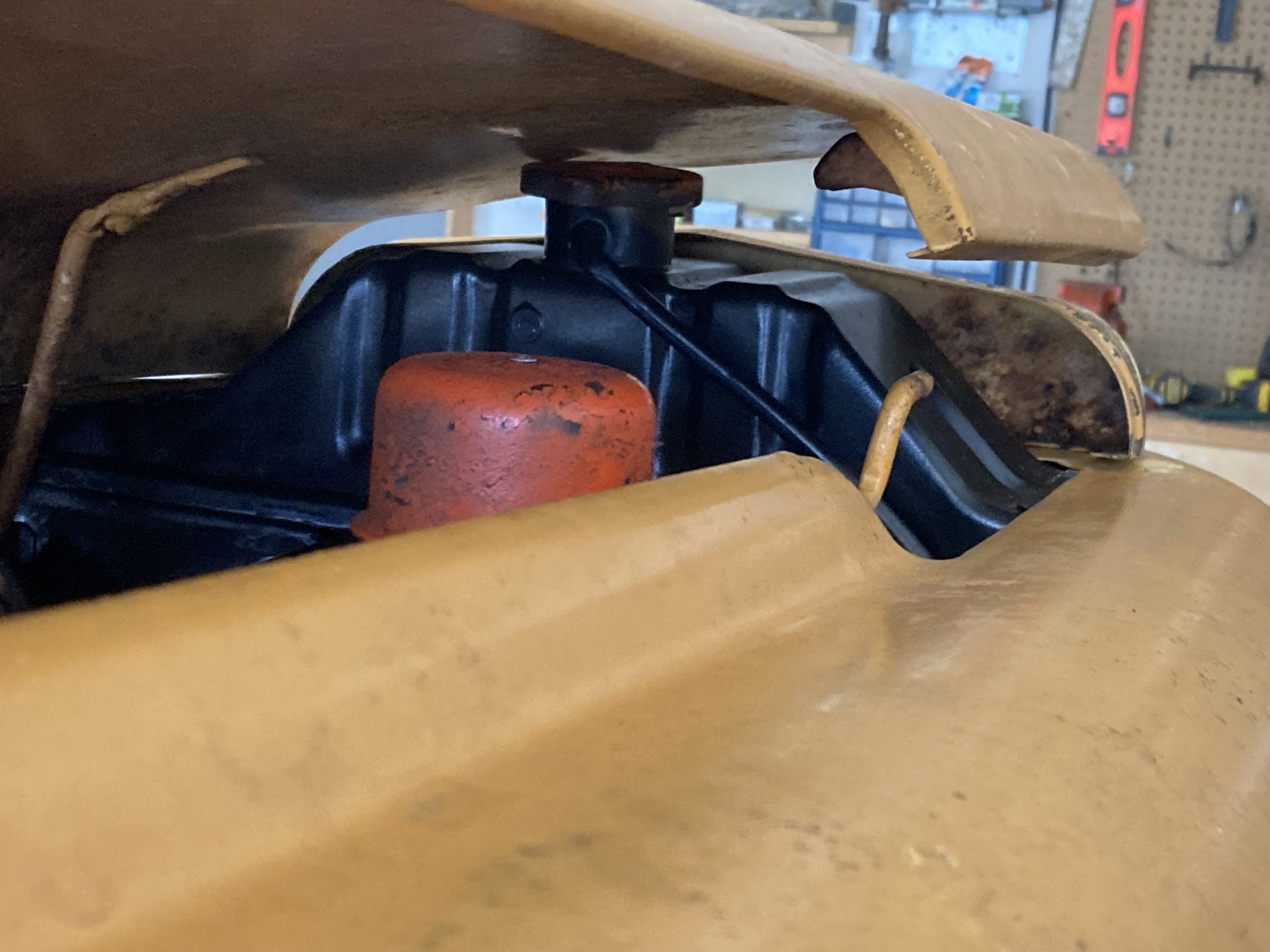

This is the the 1958 grill cap with a small cover The radiator cap is just under the cover.
This is the the 1959 grill and radiator neck & cap up through a round hole.
The top tin on the 300B is flat across the top, the 300RN has a top that opens, then is lower across the sides. Perhaps the lower height is to accommodate the profile of the different top.

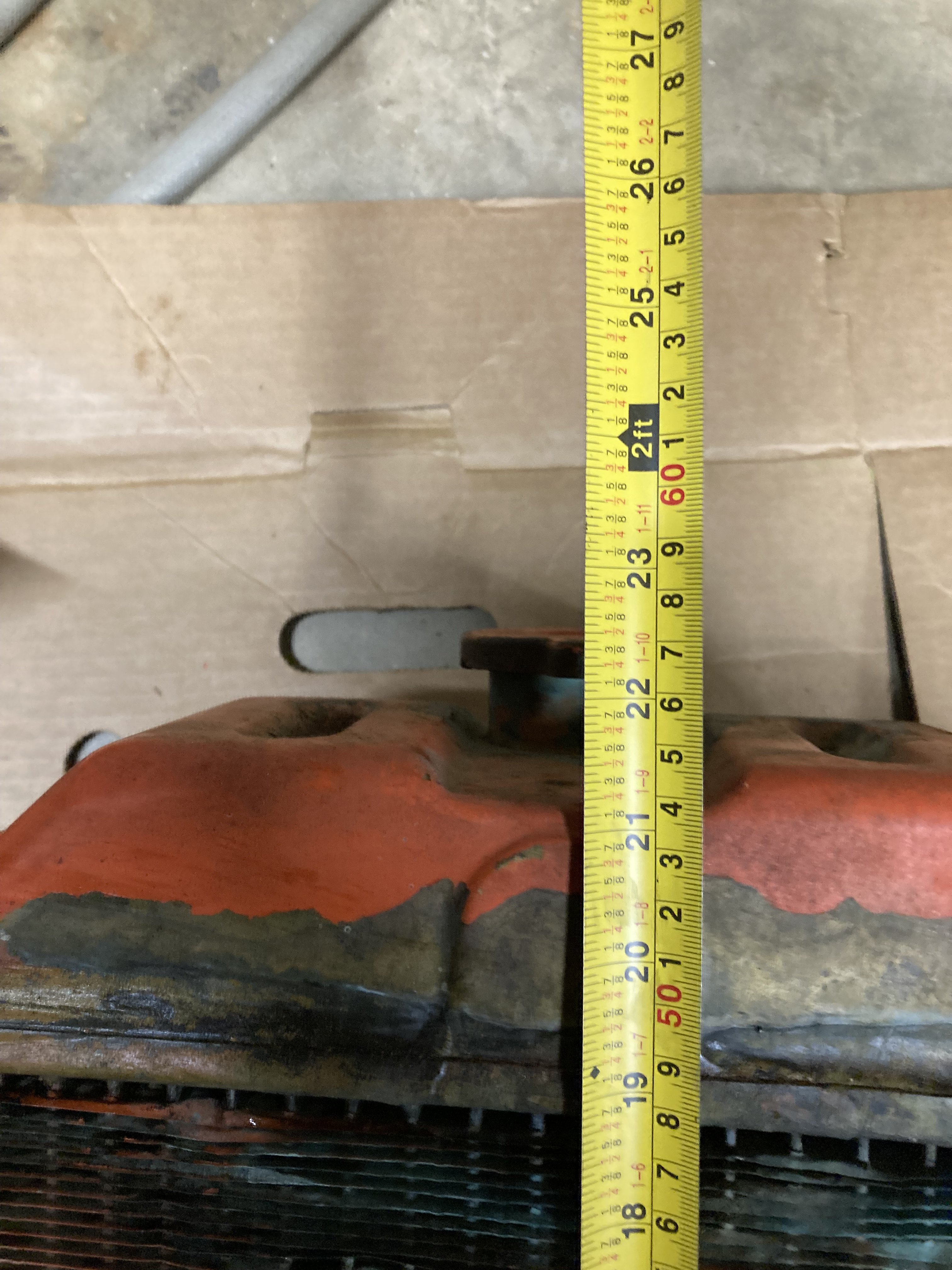

Was there any resolution on this? I would love an update as to their possible interchangeability.

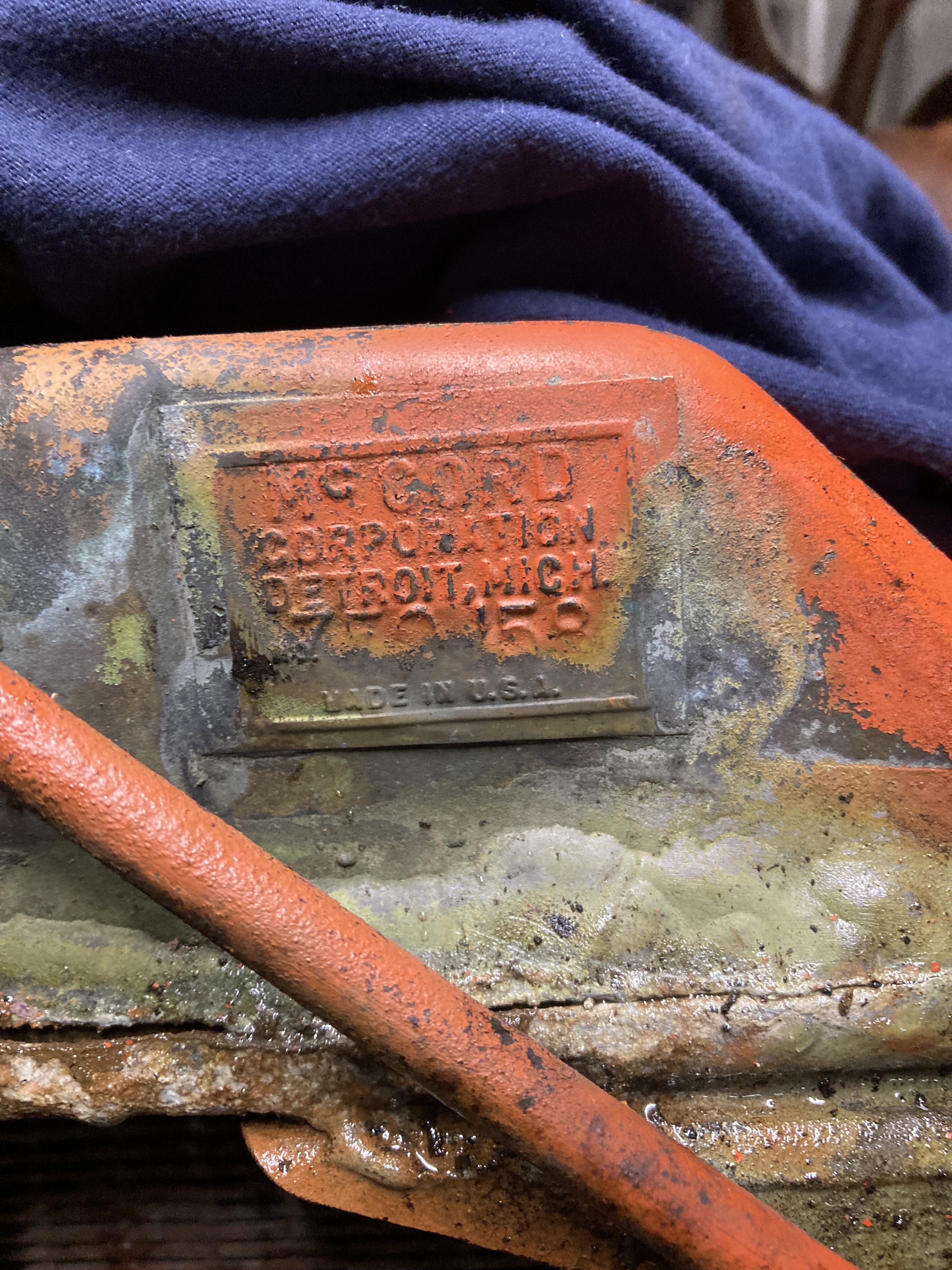

I just got a 1957 Case 311 round nose; serial #6075249, and looking for a new radiator. (Is the McCord radiator I pulled off of it original?)
Liker others, I am finding some options for the G45177, but nothing for G13090. However, the dimensions of the aftermarket radiators cross-referenced with G45177 (aftermarket # 219875) match almost identical with the one I just pulled off my round nose.
The #219875 available online:
Total Height: 22 3/8"
Total Width: 16 7/8"

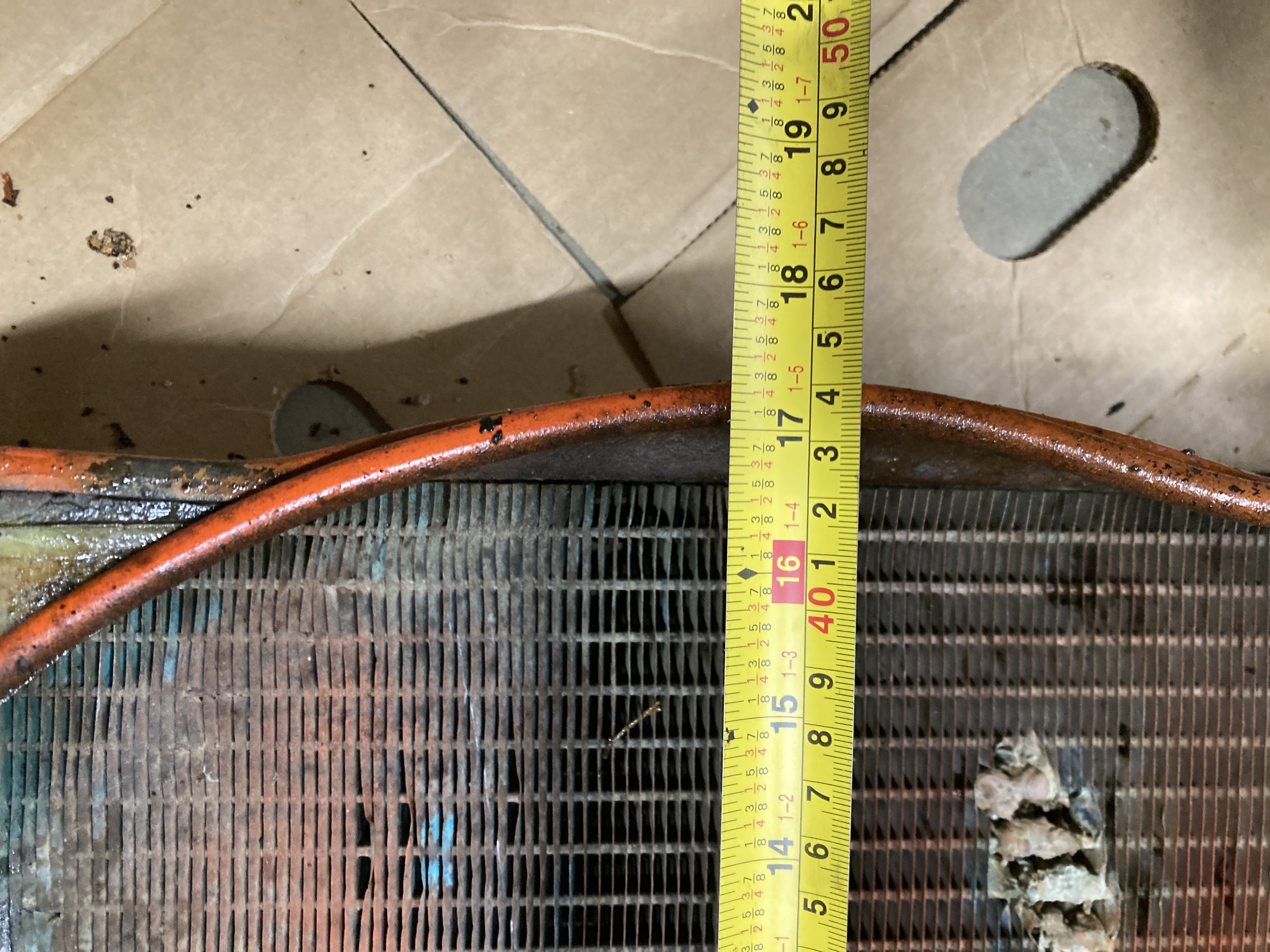

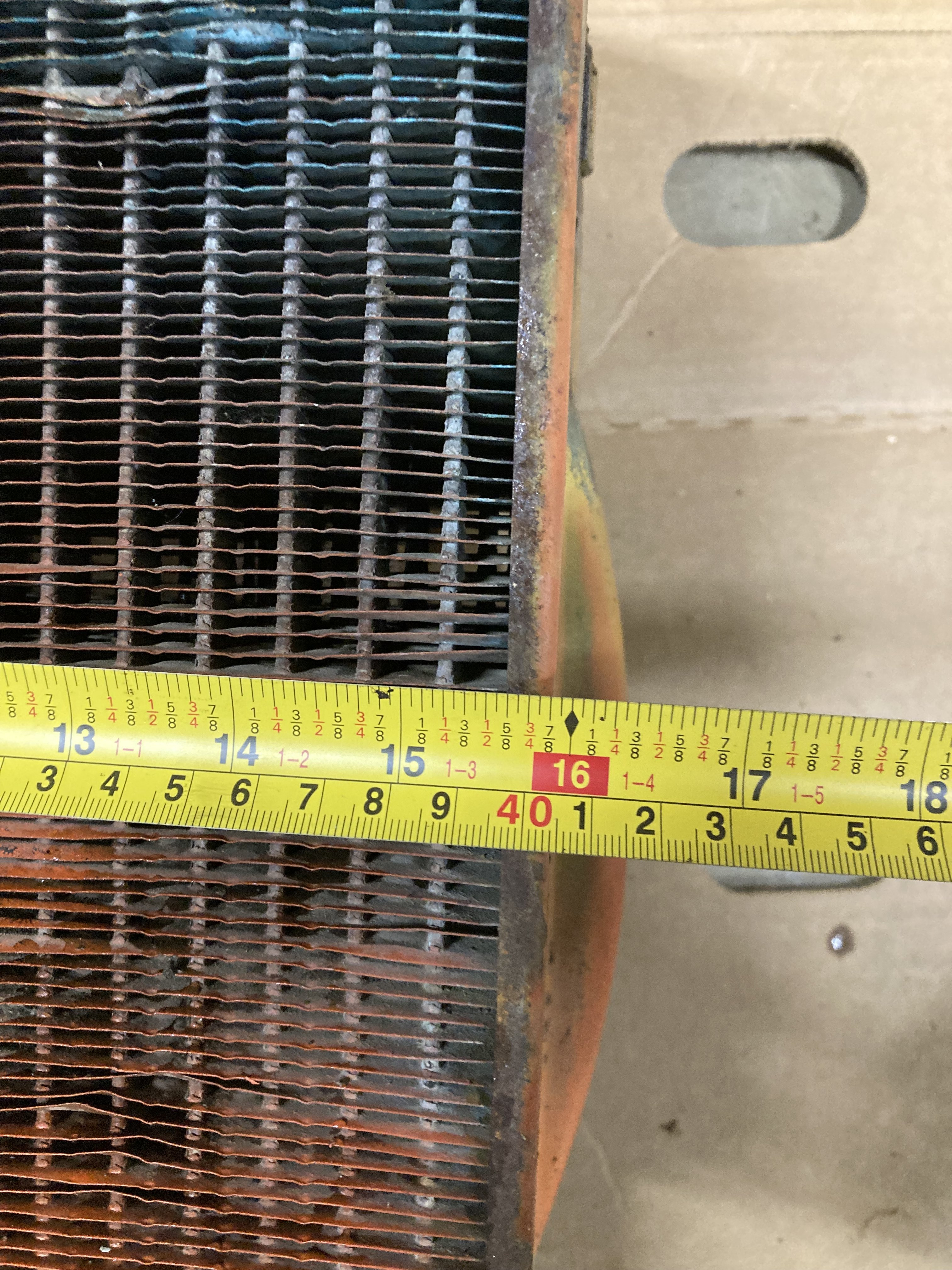

My measurements:
Total width: 15 7/8" front; 17 1/4" rear flare
Core height and widths are the same, with both having 8" mounting studs on bottom.
I have read all of the threads here I could find on the forum, but if anyone has any new information, experiences with this, reliable sources, etc., I would love to hear them. Otherwise, I am going to pop for one of these and see what happens (and report back!)
Thanks. I have learned a ton here about these old tractors the last couple weeks, and am really enjoying getting this thing going again.
Tim

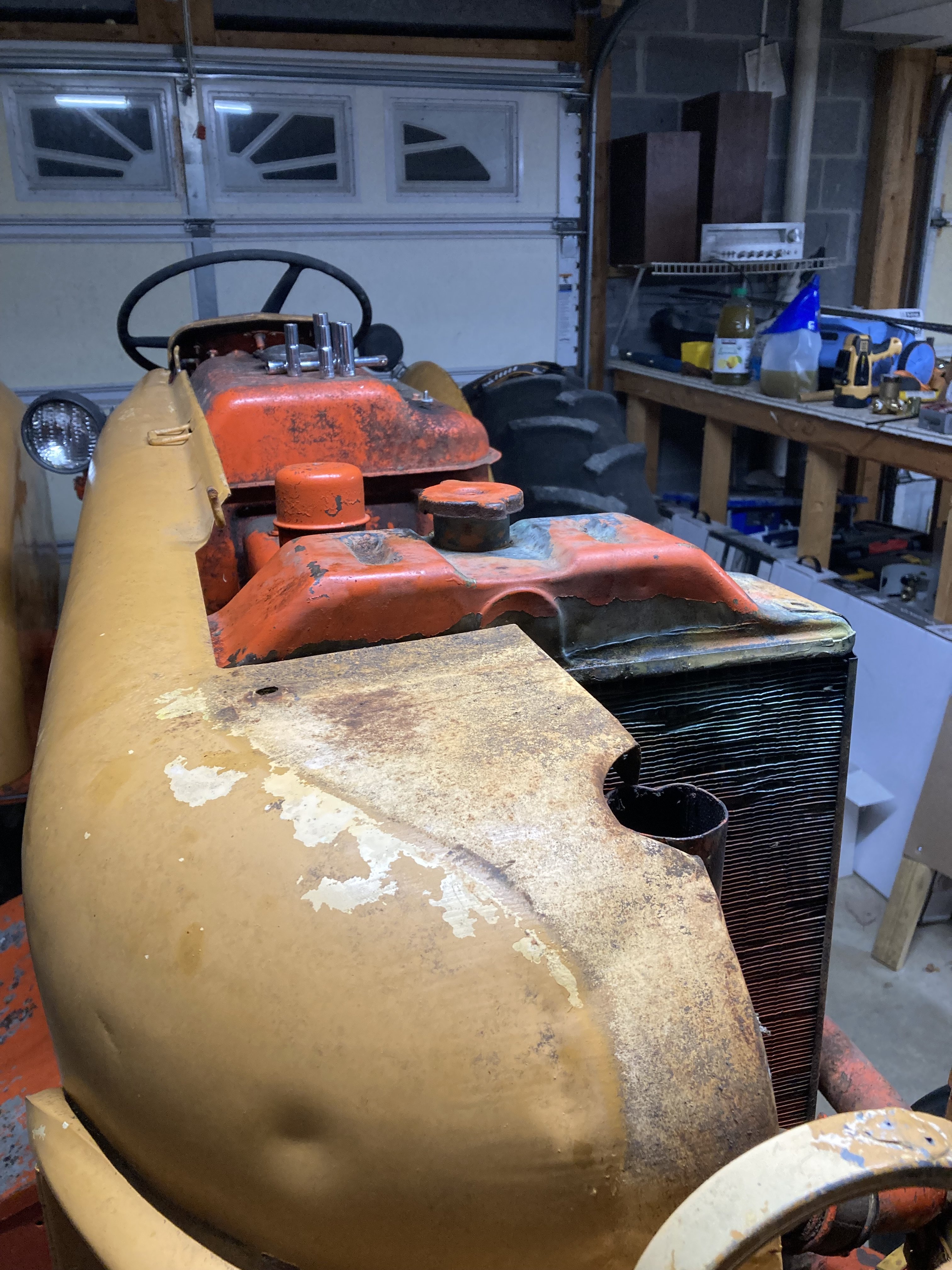

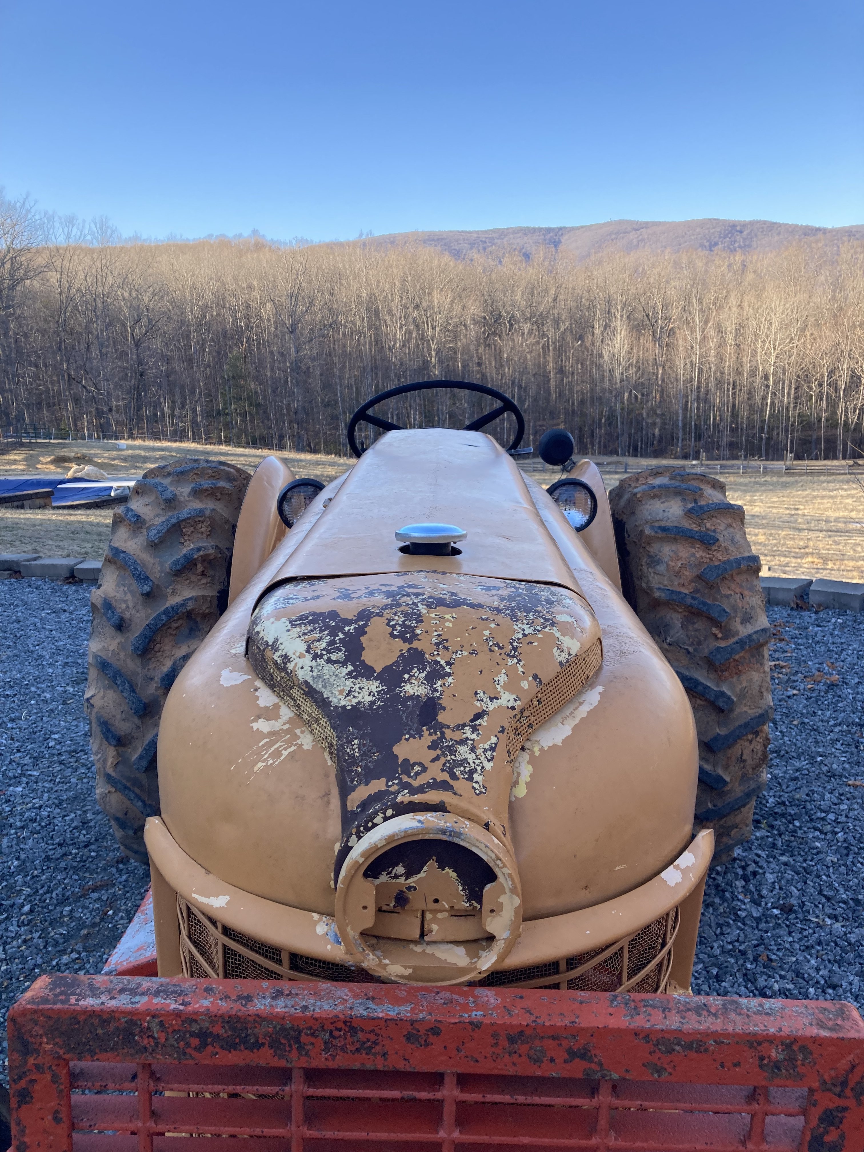

Just reporting back on this. I couldn't find a G13090 so ordered the G45177 for my '57 RN. The listed height on websites for the 45177 does not include the filler neck, so it's a little over an inch too tall. Everything else lines up exactly (width, depth, bolt spacing, top and bottom hoses, brackets), so I just used a hole saw and made it look like the other models with the cap that extend through the hood. It's a work horse, not a show horse, so I am good with it. FYI for those may be asking the same thing in the future.
