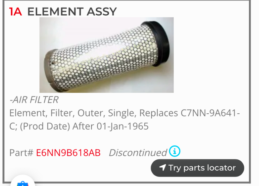

It looks like there’s a discrepancy in the NH part numbers
Messick’s photo of the filter shows the rubber seal

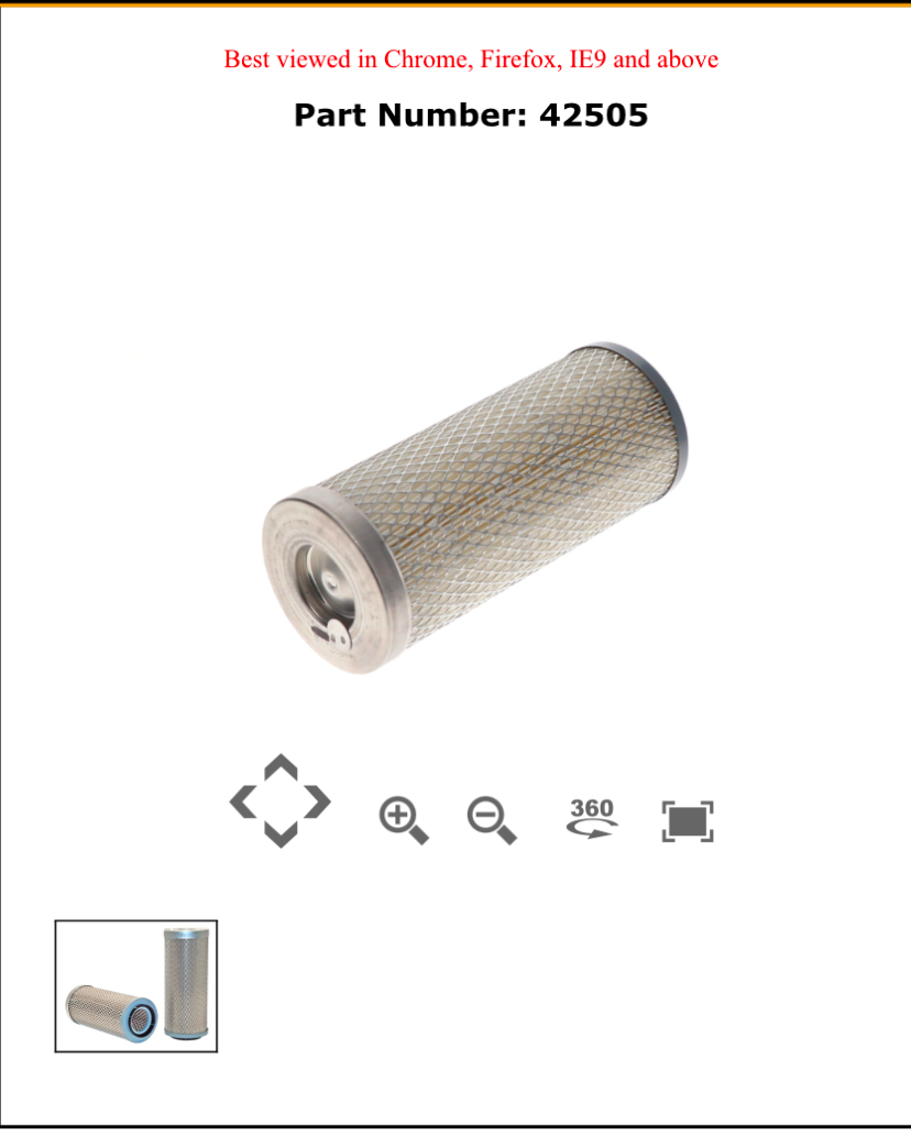

However crossing part # E6NN9B618AB or C7NN9A641 to Wix shows Wix 42505 with no seal

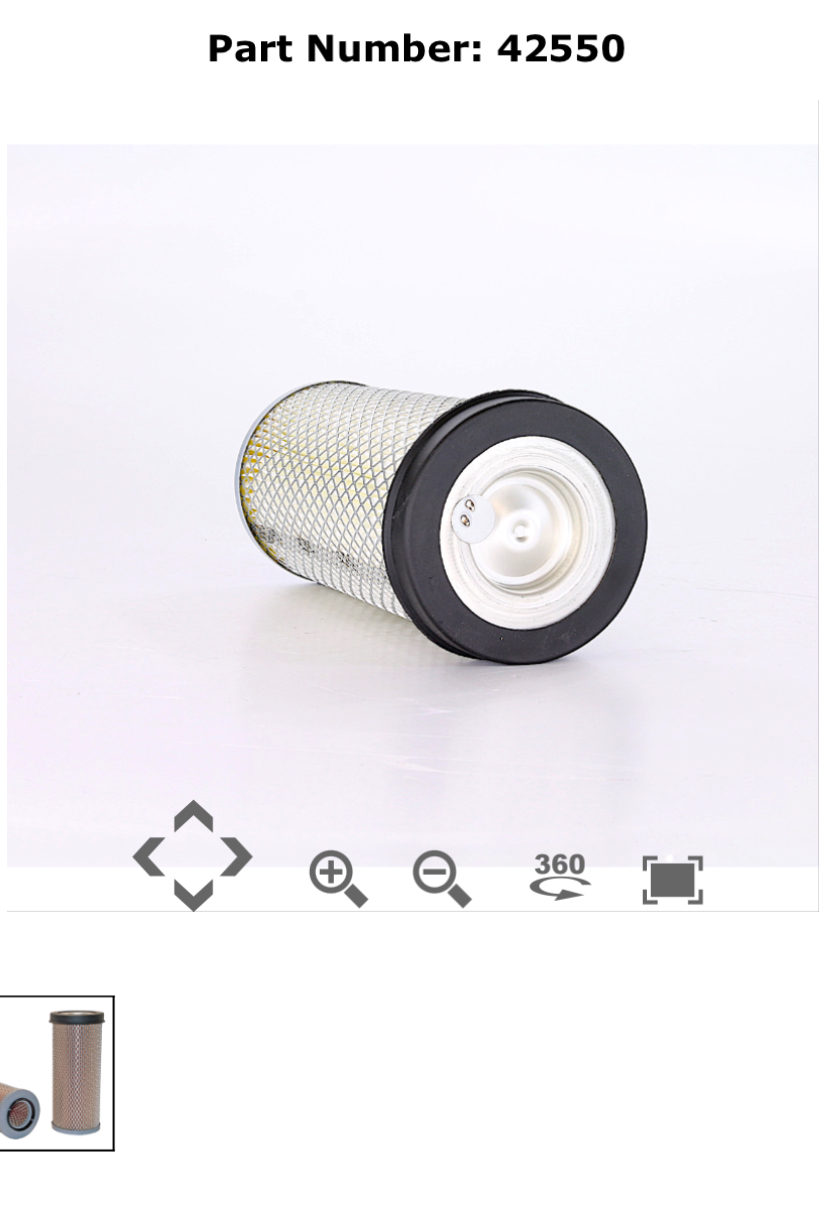

I looked in my 72 edition of the factory parts book which showed # D0NN9B618B which crossed to Wix 42550 that does have the seal
