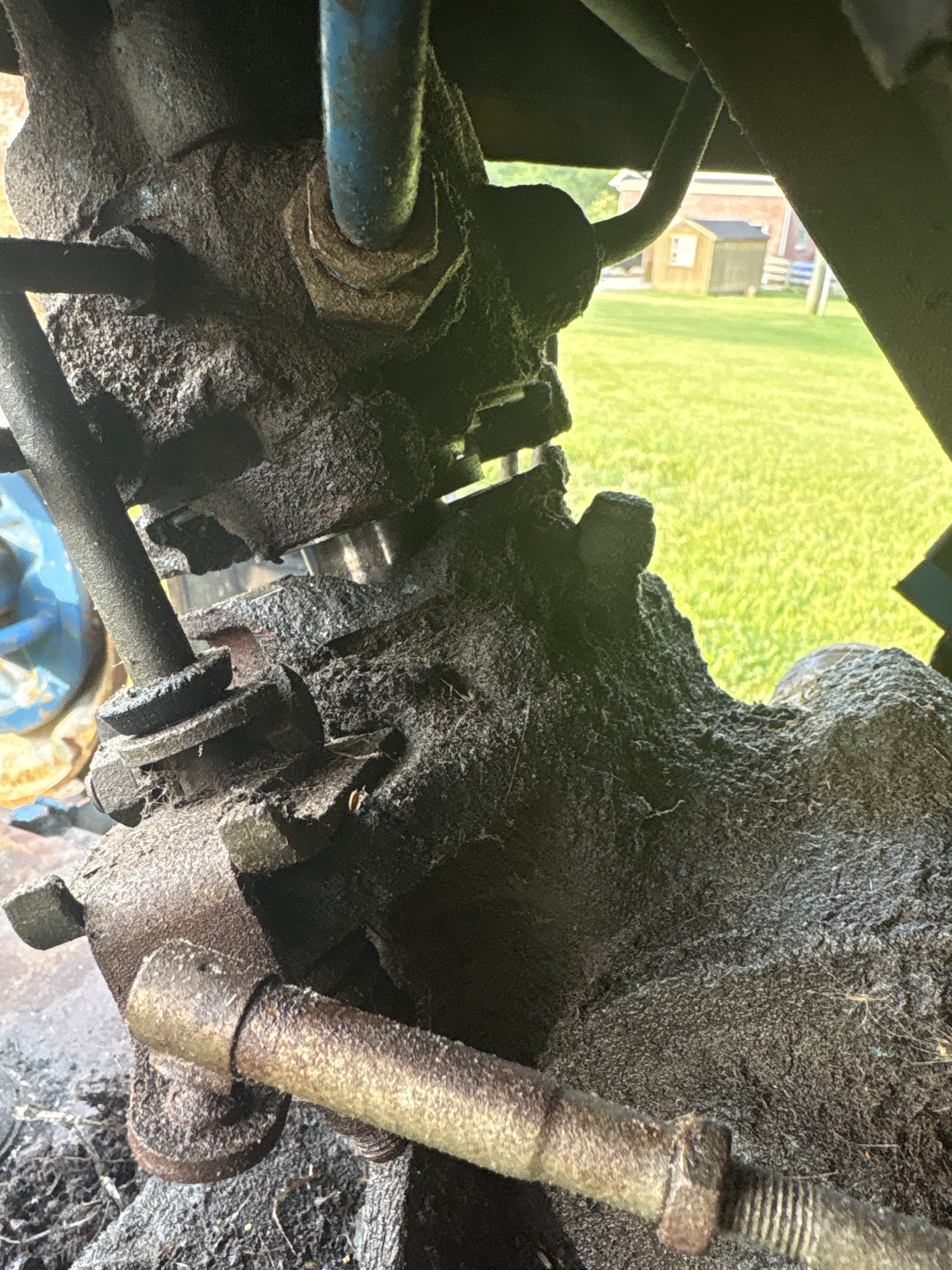

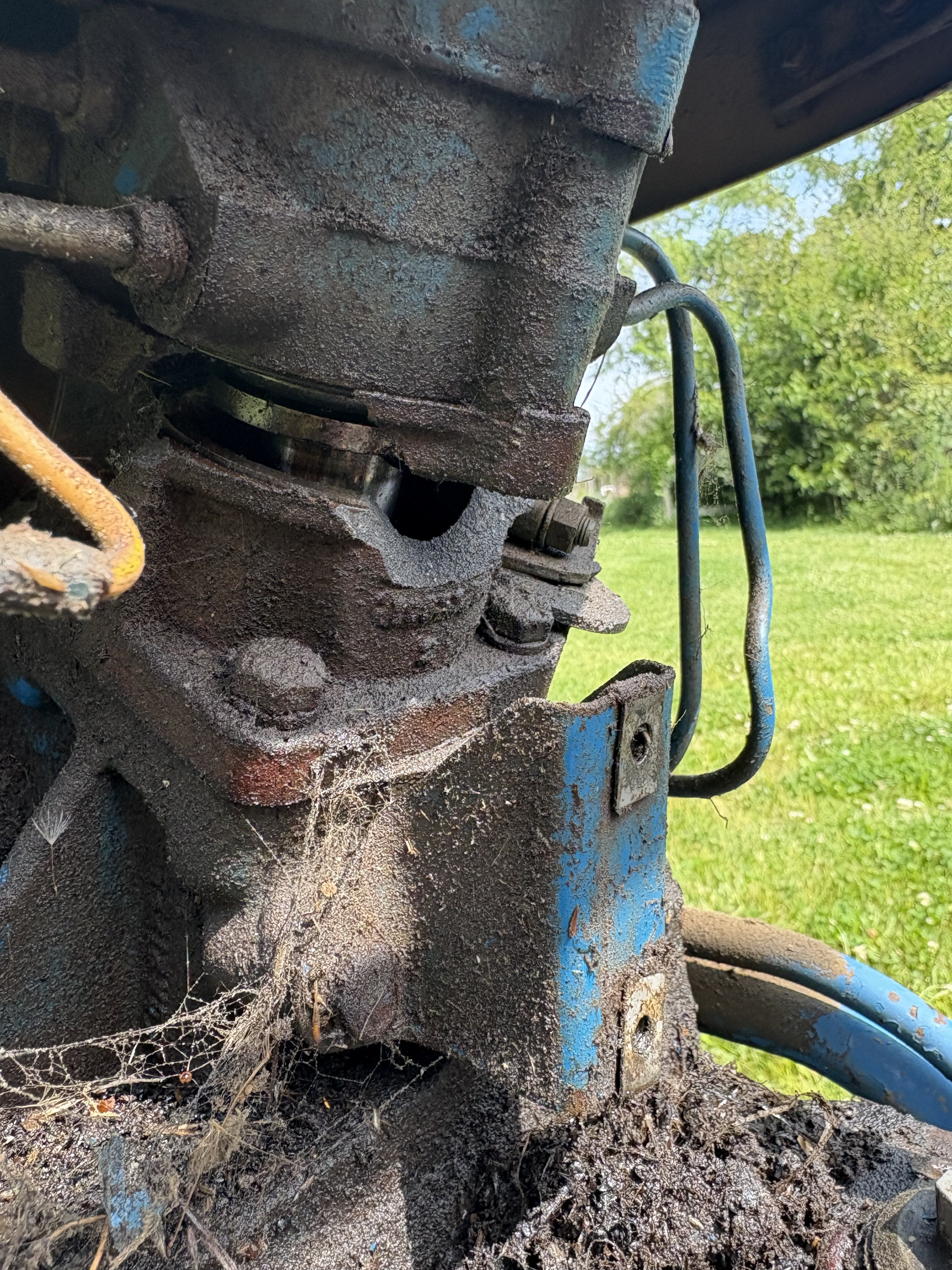

I have a 1975 Ford 3000 that I’ve operated for a few years. I’ve not been able to use the hydraulics for a few years, but honestly, this is a bush hogging tractor and I’ve never had to deal with hydraulics much anyway. It’s been a good tractor and I’ve not had much in the way of trouble with it. Last year while Bushhogging I found a sink hole and very nearly turned the tractor over. Had to have a neighbor bring his tractor and pull me back out and ever since then there has been a significant leak that appears to be power steering related. I’ve not run the tractor very much since then. Trying to get a look at what the problem might be today. I took the sheet metal off and this is what I found: I suspect that is not supposed to be in two pieces.
I’m not even 100% sure whether I have the right name for what I’m looking at, I’m assuming that the brake is in the steering gearbox. This tractor does have power steering, but I would not be opposed to going to manual steering if that was the cheaper option. I don’t have a lot of budget to work with and my best option for an alternative tractor while this one is down was my dad‘s old one that didn’t pan out for its own reasons.
What part am I looking to replace here, and anybody have a ballpark figure for what the parts should cost?

The official part name, according to the parts drawing, is the Steering Column. It is upper housing of the steering gear. The part number is E0NN3C529BA. It is no longer available new. Before trying to find one at a salvage yard and simply replace the broken part, I recommend that you disassemble it to see what internal parts might also need to be replaced. With that part cracked in two like that, there are bound to be at least a few. You might also check the salvage yards for complete power steering gear assemblies, or possibly find someone who sells rebuilt units. You can also find after market assemblies on ebay.

Sean, Hard to see stuff on this phone but I think that part is available. $230
Fordlost, If I'm correct about what part is broken, replacing the steering column with a manual one might not be a bad option.

Pricing is not bad on that one, and I don’t have to have power steering, but one thing I have no idea about is if I converted it to manual steering gearbox, what else has to happen on the tractor, to keep from messing anything else up?
It’s a bit of a job replacing that broken steering block but that’s what I’d do, catch a tire in a hole with manual steering and steering wheel kick back can be a real thumb breaker
If you do convert you’ll need to remove the steering cylinders and ps pump, then install a block off plate on the engine
Do not toss any of the old parts as there’s Al way someone looking for them, even the lines

Ultradog - That's not the original Ford part. It is after market. It says "replaces" a couple of different part numbers.
