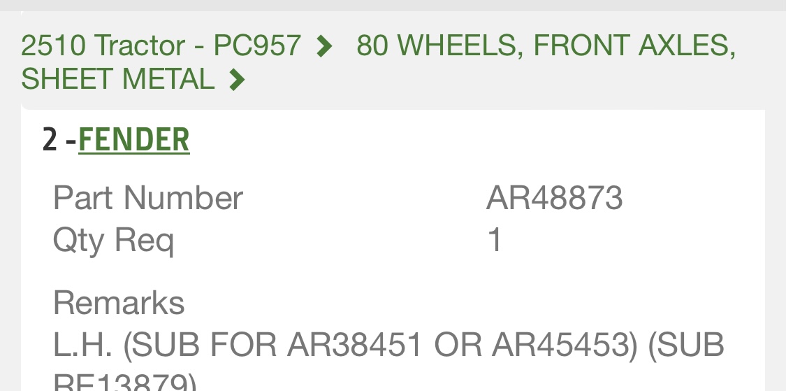

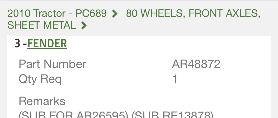

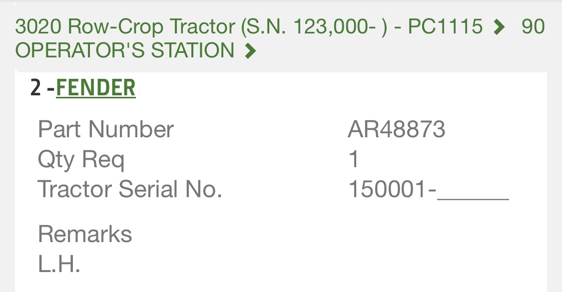

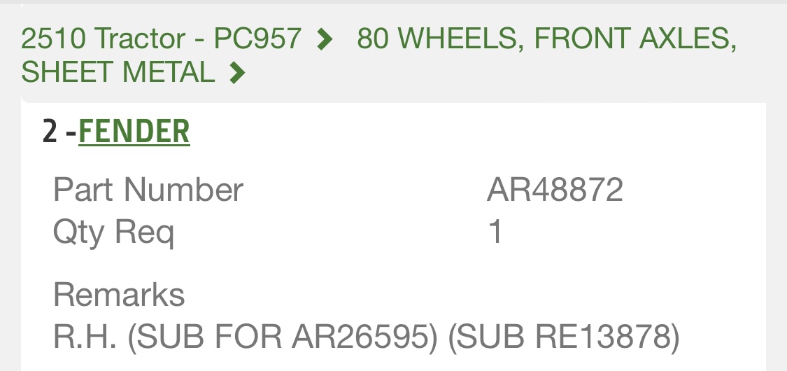

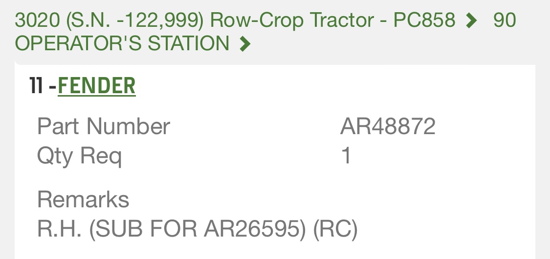

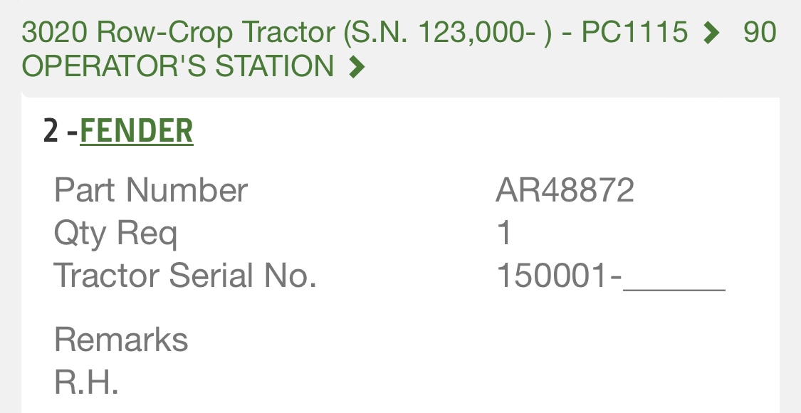

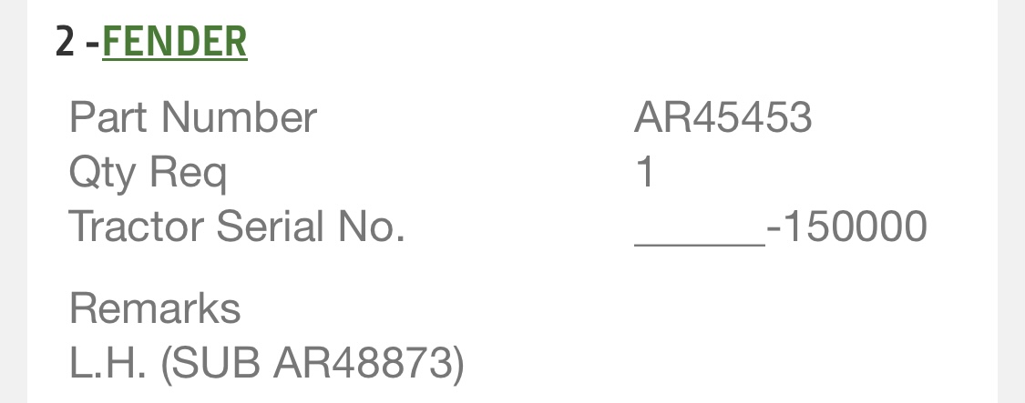

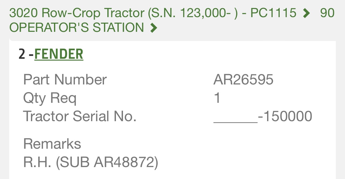

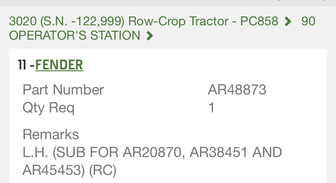

2010 rowcrop , some interchange . 2010 Utility are unique shorty fenders that also are part of the operator’s platform .

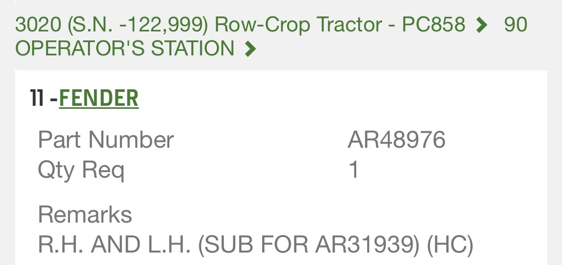

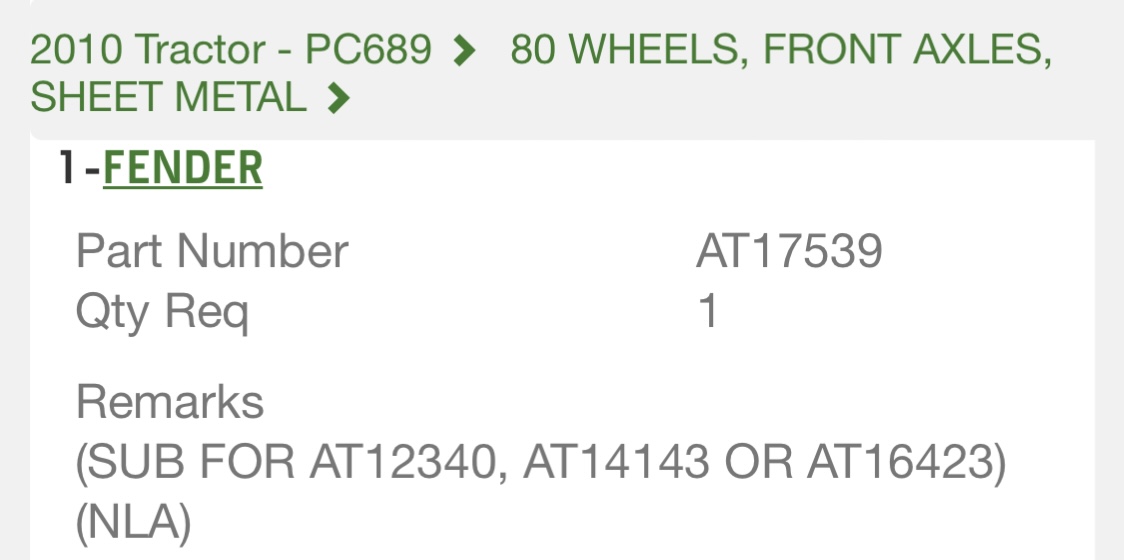

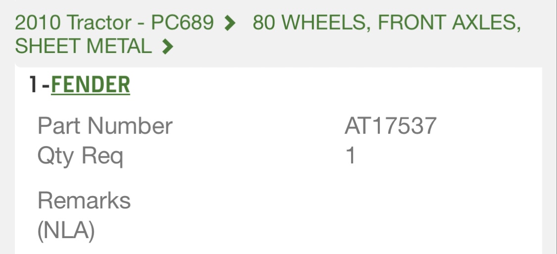

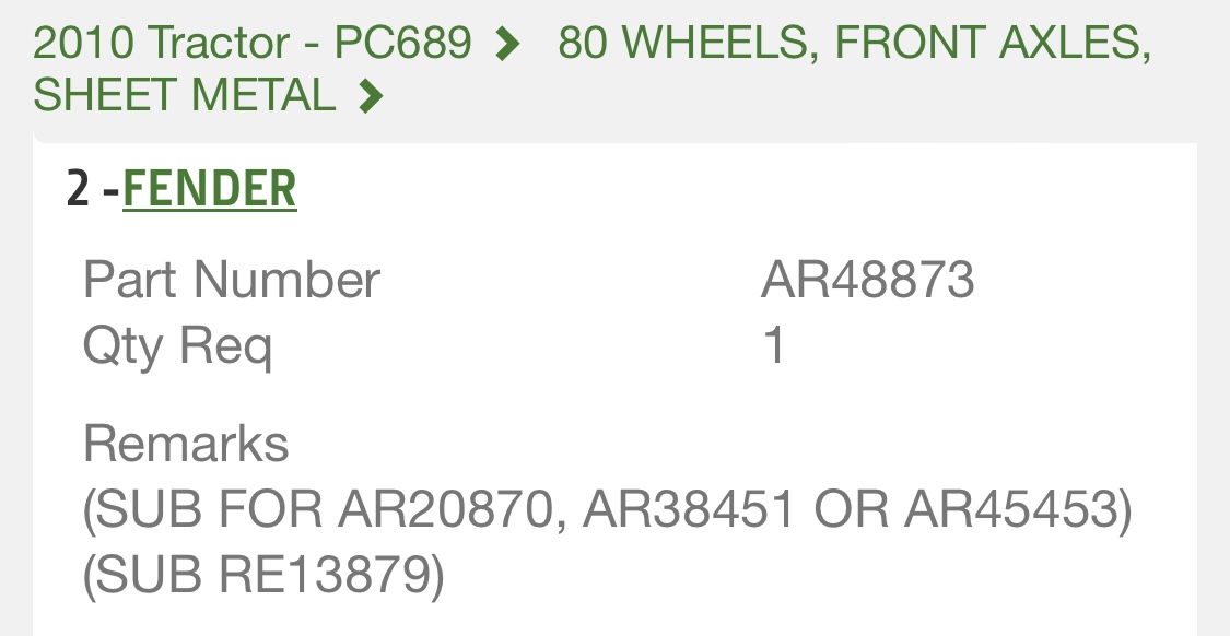

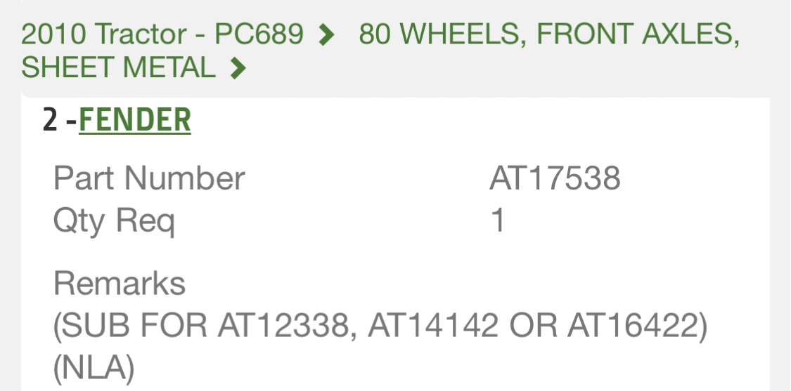

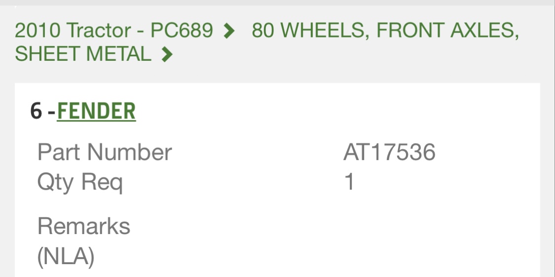

NO 3020 fenders are part # AR30487 or AR40496 while 2010 fenders are part # AT17537 & AT17536 or AT17538 & AT17539Are the fenders on a 3020 row crop utility the same as a 2010 utility?
Mine is a row crop utility and they look similar to the ones on a 2010More of a clamshell fender if I remember right. So what's going on what? 2010 to 3020? 3020 will usually have the fancy fenders with the lights in them.
Can you please post a photo of your 3020 Standard/RU fenders that resemble 2010 RU fenders? https://partscatalog.deere.com/jdrc/navigation/equipment/76112/srch/AR30487 https://partscatalog.deere.com/jdrc/navigation/equipment/82370/srch/AT17537 https://partscatalog.deere.com/jdrc/sidebyside/equipment/82370/referrer/navigation/pgId/271171Mine is a row crop utility and they look similar to the ones on a 2010
They will work. The basic fender is the same but the bottom part is different. I have a set on my 3020 utility and they will bolt flat on the axle where the original 3020's had a raised box to allow for 46a loader brackets. TomAre the fenders on a 3020 row crop utility the same as a 2010 utility?
Are these pretty good tractors?They will work. The basic fender is the same but the bottom part is different. I have a set on my 3020 utility and they will bolt flat on the axle where the original 3020's had a raised box to allow for 46a loader brackets. Tom
