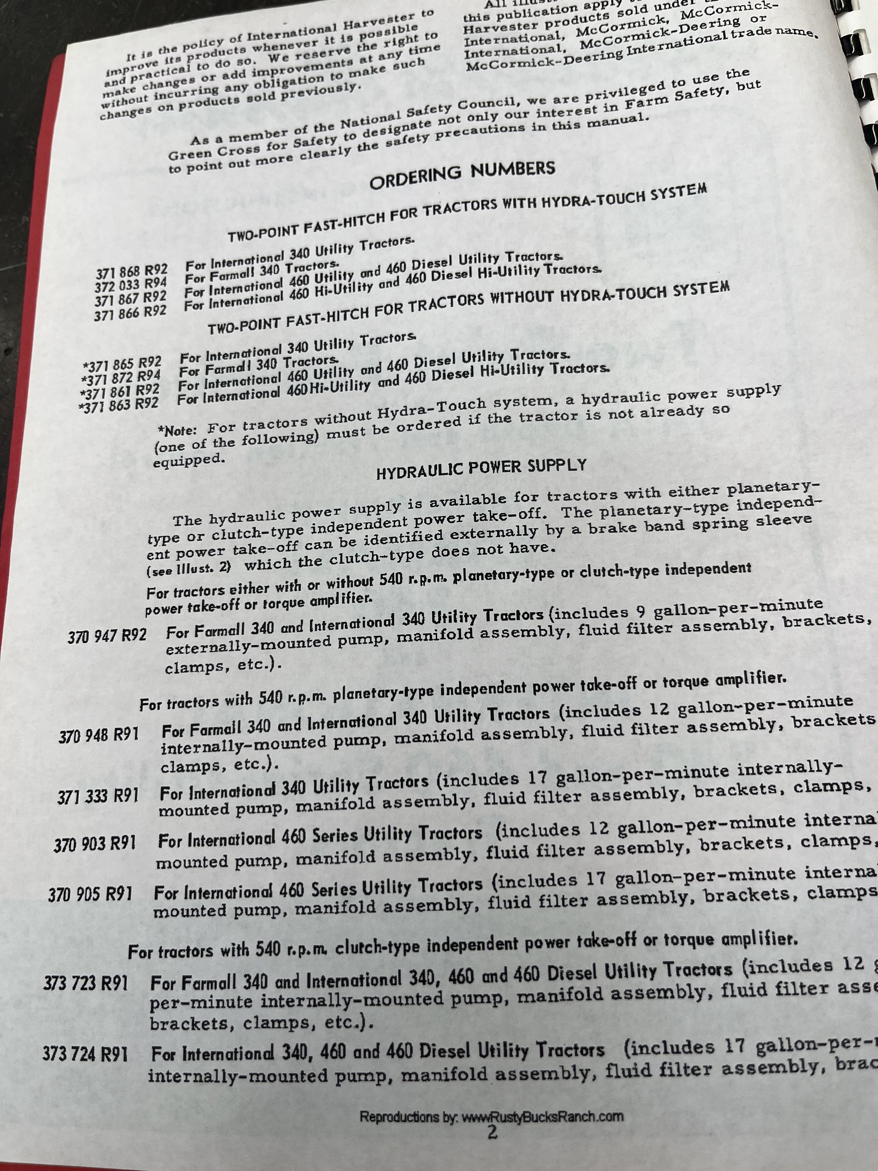

Take look at this info. Best I’ve found on how the 340 hyd system works. I have a 340 also
What should the flow be at the outlet? I have not got a good answer from I&T manual and wondering if someone knows
Pic is from a manual on 340 and 460 series tractors. If you can’t zoom on the pic to read it, it says 9 gallons per minute for external pump.

I would expect you would have with a good pump some where around the pump out put level of probably 8-12 GPM at some place in the 1500-2500 PSI when you crank the flow rater down to the specified pressure for the tractor. IF get less than those figures and ar not close to the proper volume and pressure you need a pump or the relief valve is not doing it's job or you have a restriction in the suction side of your line. Other option would be a blown o-ring in the system someplace.
