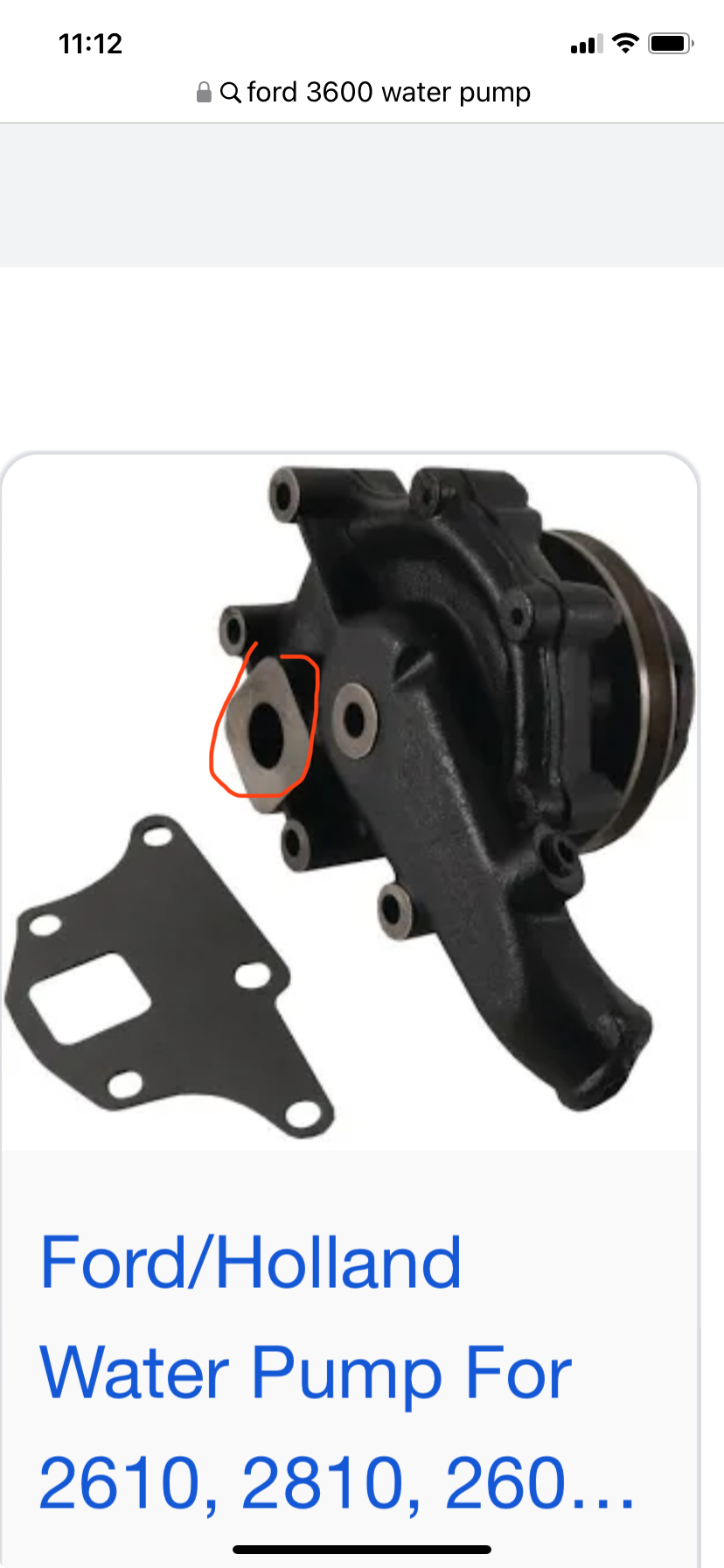

You apparently didn’t think bh49s question about new/old problem, was worthy of an answer. Give more details about the tractor and when how this problem presented itself. Timing can be a factor adding to an overheating problem but in this case since the tractor is just idling I doubt this is your problem. In my opinion the timing could be as far out of wack as possible to where it would still run, but at an idle doing no work the cooling system should be adequate to cool the engine. I am wondering if it could be possible some odd thing has happened in the cooling jacket of the engine? I am proposing maybe some thin casting flash broke away and is obstructing the passage for coolant to flow out of the water pump into the block. (see photo is this how your engine is configured?) Maybe a foil seal off the top of an antifreeze jug is in there blocking this? This doesn’t explain why you can still see circulation. Still have your old water pump? Show a photo of it, impeller side.I also read about timing causing over heating but I would thing the tractor would run rough, runs smooth. New radiator, nothing changed with it.
PS. Didn't see a picture.You apparently didn’t think bh49s question about new/old problem, was worthy of an answer. Give more details about the tractor and when how this problem presented itself. Timing can be a factor adding to an overheating problem but in this case since the tractor is just idling I doubt this is your problem. In my opinion the timing could be as far out of wack as possible to where it would still run, but at an idle doing no work the cooling system should be adequate to cool the engine. I am wondering if it could be possible some odd thing has happened in the cooling jacket of the engine? I am proposing maybe some thin casting flash broke away and is obstructing the passage for coolant to flow out of the water pump into the block. (see photo is this how your engine is configured?) Maybe a foil seal off the top of an antifreeze jug is in there blocking this? This doesn’t explain why you can still see circulation. Still have your old water pump? Show a photo of it, impeller side.

The idea you have about the cooling jacket makes the most since to me. I've checked the oil several times and its just as clear as can be. I'm going to try your suggestions. The old water pump it gone so no picture there but it looked old but fine.
