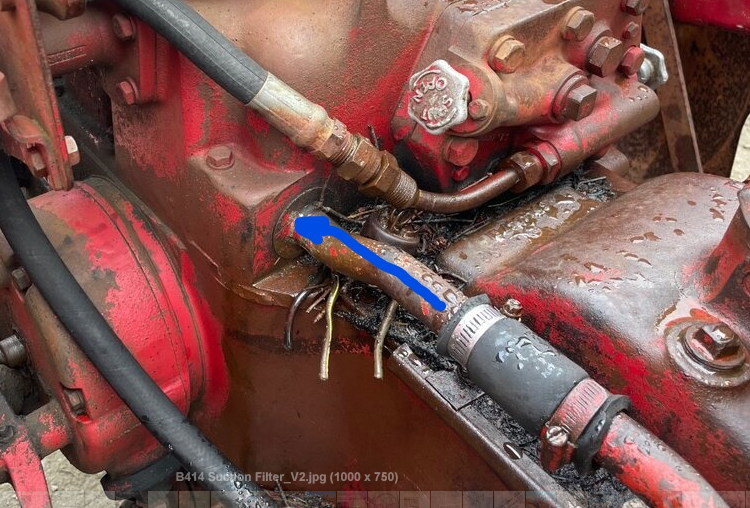

Hi folks I also have a 384 but I seem to be having trouble with the power steering and the hydraulics at times it will not pickup the bucket or steer. The book tells me there is two oil reserves one for transmission and one for steering and bucket lift I can only find one under the seat for transmission. Anybody know of a second reservoir?

Normally there is only one hydraulic reservoir and that is the one under the seat, open the filler plug behind the seat and look down in the hole the hydraulic should be an 1.5 to 2 inches below the bottom of the filler plug. There is also a suction filter on the hydraulic out of the reservoir in front of the seat.
The 384 is 40 plus years old and to be positive about the hydraulics, I would require to see a photo of the hydraulic connections from the loader hydraulic valve to the tractor hydraulic lines. Does it have the Power Steering cylinder on the left side tractor attached under the left foot rest?
See photo below, the blue arrow points to the suction filter.

Yes I have that same outlet I have been trying to find the filter so and yes my steering cylinder is on the left side.

What we used to do was we had a bank barn with a steep "Gang Way" as they called it in our area that led up to the barn floor on the second level, so we would park the tractor on the gang way with the front facing the barn and then loosen the hose clamps slide the rubber joiner pipe towards the front , gently rotate the curved pipe on the filter to clear the pipe from the front and pull the filter out of the hydraulic housing.
I have seen the IH Mechanic do one at the IH dealership by connecting a shop vac to the filler hole and let it run to create a vacuum and then remove the filter. I would recommend installing a new O-ring on the filter.
One more question does your 384 have two hydraulic lines going under the seat and into the top of the reservoir? This was common on the Industrial versions but not on the Ag versions.
I will have to check tomorrow morning I will get back on tomorrow thank you for your help. I also have a good steep ramp I can use great idea.
Hello again mine has no hoses going into the top of the reservoir it has the one coming out of the filter area and one coming out of the front valve housing like the picture you sent only difference is that hose goes forward not towards the back of the tractor.
That is good, in the photo that I had attached, the owner had too long of hose going to loader control valve, he/she just looped it around under the right foot rest and up to front of hydraulic reservoir, that is the high pressure line for the 3PT.
