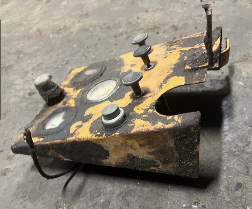

I have an early 39 rtu (under 300 serial number) I am looking for a dash for it. It’s a pretty simple panel with 5 small holes for the buttons and light and 3 for the gauges. I have looked in the normal places with no luck. Anyone have one they can spare or have the measurements so I can fabricate one? Thanks in advance.

Installed one on my 39 R cab off a 40 RTN. Made diagrams with dimensions as planning to fabricate one to replace one I borrowed.
Have to remember what I did with paperwork otherwise would have to draw out again. Dash face 9 1/2 h 7 1/2 w top 7 3/4 wide on bottom. Bend is 3/8 on top and 2 3/4 at bottom. So metal piece 8 1/4 top 13 1/4 bottom. Would have to account for bend. Dash sits on angle so old geometry would make sides a scalene triangle except for 3/8. One side being 9 1/2 Bottom 2 3/4. Right side 9 1/4.
