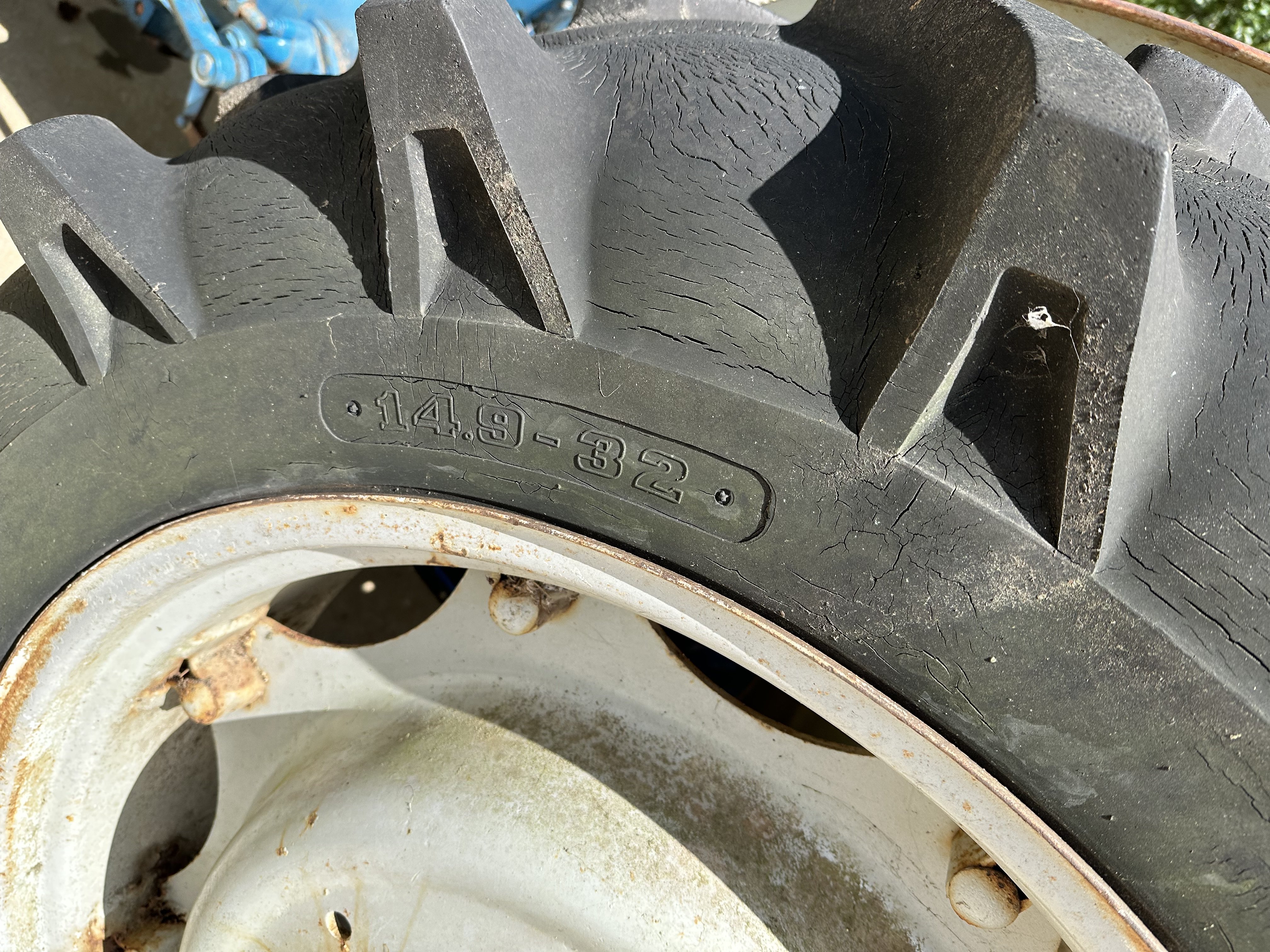

I have 14.9-32 tires on the rear of my 3910. Looks like that isnt the correct size, and from what I can find that is a very uncommmon size. Does anyone know what I could put on this rim thats more common and maybe a little bigger?
Are you sure about that tire size, 13.6-28 was the standard tire for a 3910 with 14.9-28 being a option
14.9-30 was a size used on the 4610 models but I've not seen 32 inch wheels on a Ford

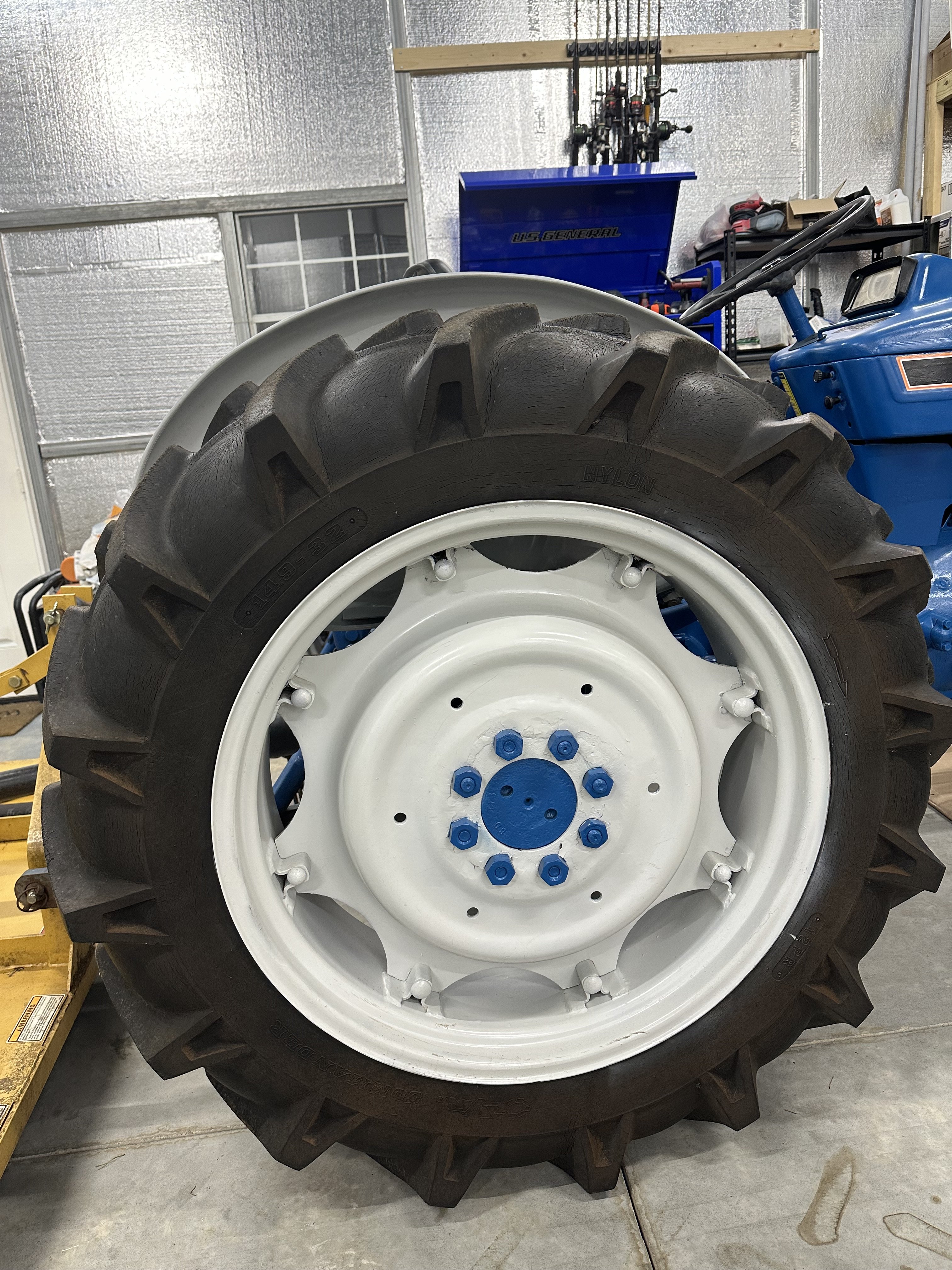

Here are some pics. Thats why Im asking, I thought it was odd as well. I want to find something that will fit on these rims
The parts site does show a 32" center and a 10" x 32" rim, both listed as NH-E Only, which I believe means New Holland Europe Only. It would be a tight fit to put 14.9" wide tires on a 10" rim though, but those in the pictures don't appear to be pinched in too much at the bead. That rim and is only listed for the 3610, 4110 and 4610, and only after 1/1/90.
Would probably be better to check with some salvage yards for a set of 28 inch rims and centers to swap it over to standard US 13.6-28s or 14.9-28s
4000SU, 4600SU, 4610SU, 3910, 3930 rims will all work

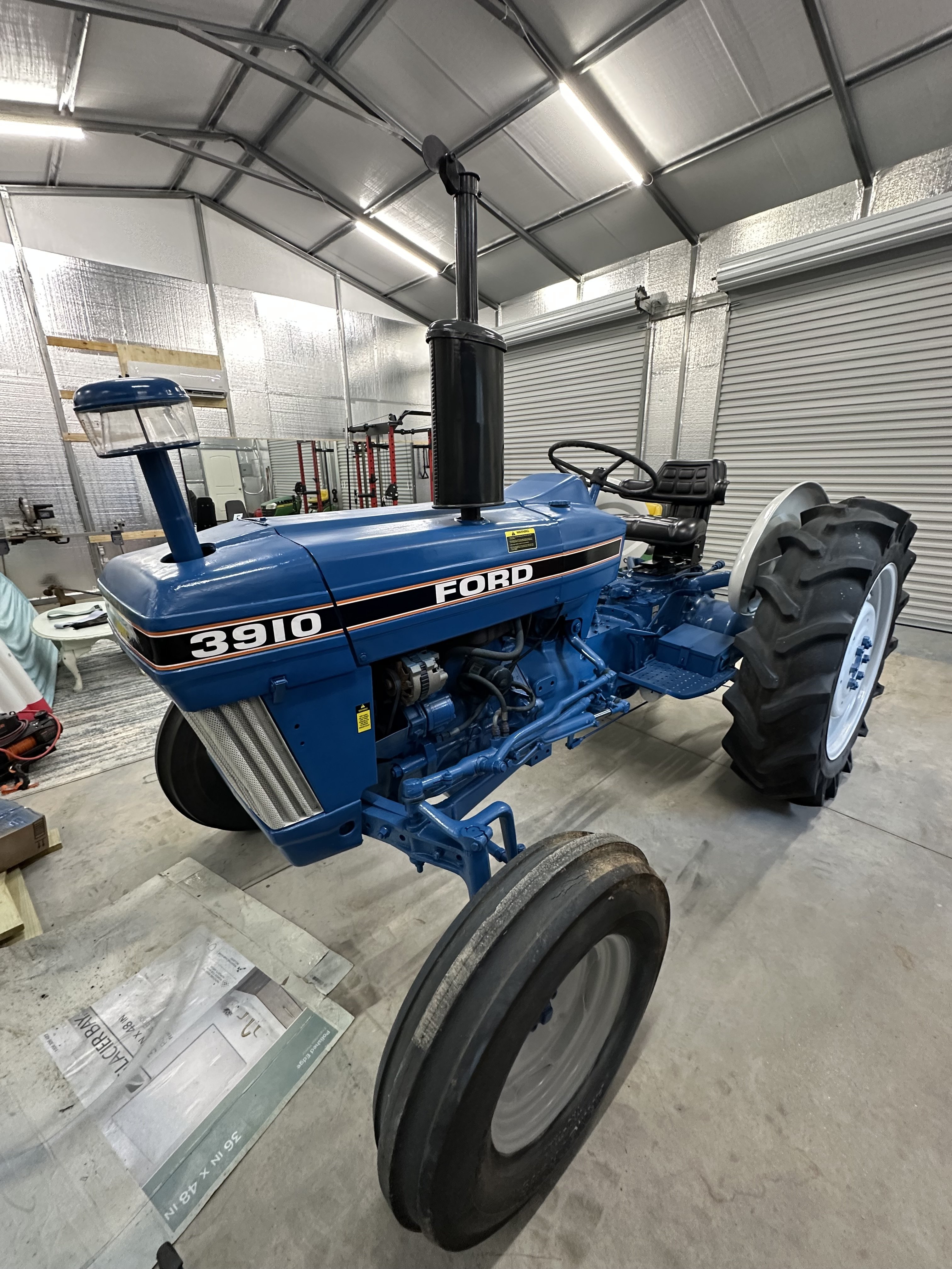

Has anyone ever seen a power steering system like this? I dont see this on any other 3910s. Maybe it was a European thing?
Im way over in western ny. Im
Sure shipping would be more than theyre worth. Thanks for the offer though!
That's a aftermarket power steering system, I see them advertised on eBay
It's a decent setup but don't add a loader to the tractor, the steering arms can't handle the added pressure.
