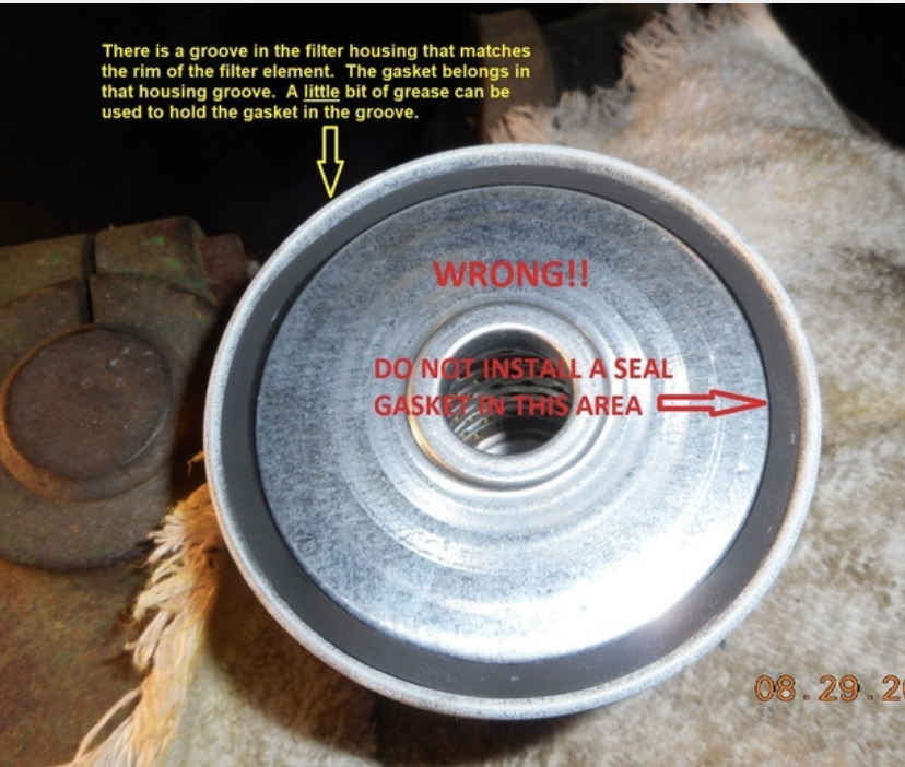

My diesel will start and run for about a half hour and then acts like it runs out of fuel. Do they have a vented cap or vent tube that could be blocked?
With all these new parts it leaves the most likely cause is that it is sucking air until it has sucked enough that the injector pump doesn't have enough to pressurize.It is a 3 cylinder diesel. I have replaced the injector pump with a new one , replaced the injectors, cleaned the fuel tank and replaced fuel filter.
Napa fuel filter , one o-ring around bottom of housing one o-ring in top of housing
Napa filter with new o-rings one on top one on bottomDo not know what brand fuel filter was used. How many of the big square section orings were left over ?
On Wix and NAPA filter if the top o-ring was installed like in the photo that is your issueNapa fuel filter , one o-ring around bottom of housing one o-ring in top of housing
There were two left over gasketsNapa filter with new o-rings one on top one on bottom
I wonder if your low pressure lift pump is going bad, or maybe has a pin hole in the diaphram. It doesn't happen very often, but it does happen.
Congratulations! Thanks for posting back. Don't worry. You are far from the first who had it turn out to be the most basic simplest thing after replacing a lot of parts.I’ve gotten down to its rust coming from the tank clogging the outlet. I’ve just received the new tank and will be installing it
