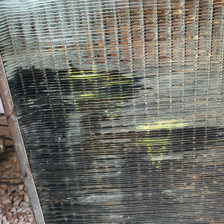

I was washing my 4020 Propane and noticed it was leaking coolant. I removed the radiator from the tractor and plugged up the bottom fitting and noticed two leaks in the core about 1/3 the way from the top.

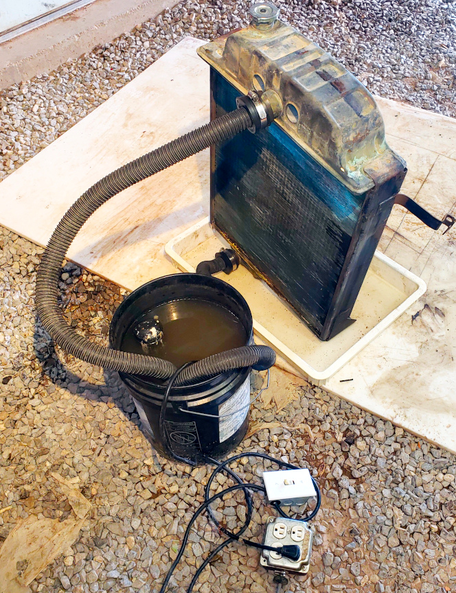

To try to save a few bucks, I assembled a Radiator test area and will try the Bards Radiator Stop-Leak. Before you go ballistic, at this point it is worth a try to see if I can plug up the two tiny pinholes.
After compiling some Red-neck engineering I was able to cobble together a test devise that will provide almost 2 gallons a minute at about 5 PSI.
I bought two 2" rubber blanking caps and drilled a 3/4" hole in them dead center. I then installed two 2 1/2 Gallon shop Vac hoses into the holes in the caps. A very nice tight fit that only gets tighter under pressure.
The pump is a 1/2 HP Sump pump from HF. It will provide 2 gallons a minute under 5 PSI.
The pump sits in a 5 gallon bucket. I cut the power cord and installed an ON/OFF switch.
I test ran the system and it works well with only a few drops of water under pressure at the fittings. And yes, the two pin holes leaks were dead center in the core and dribbling.
I will in the AM set all outside in the sun and heat up the water/stop leak to over 100 degrees F.
If the Bards Stop Leak work, so much the better.
Yes, I will flush out the radiator as I do not want that crap in the engine.
If it does not work, a new radiator will be ordered. They DO NOT include the mounting frame. You have to unsolder the old one and reuse it.
Leaks in yellow.

If you have access to the pin holes, clean the area with a dab a small amount of JB Weld on the cleaned area. I have a tractor that has been operating that way.
The Bars did not work. I ran the pump after the normal required time for several hours afterwards and it still leaks.
I will pry the fins back and see if I can locate the pin hols and solder them up.
My experience with several radiators that had pinholes is once they start they will continue so patching up a few holes now means you will probably get more in the not too distant future. I'd have it recored if you could locate a shop using your original (heavy) tanks. Yes a new one is just 50 bucks more plus $150 shipping.
The radiator core is too far gone, and the holes are in the center!
This radiator has a steel frame around it (you do not get this with a new radiator) and it is soldered in places at six points.
What is the best method to remove and re-solder this frame to the new radiator? I'd hate to melt the new core's internals!
