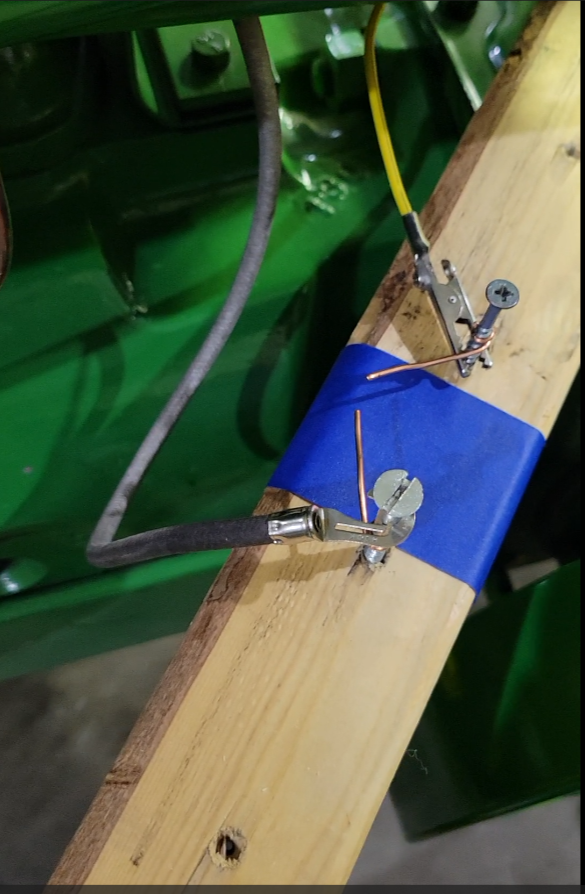

As teddy52food mentioned, you certainly could hold the spark plug wire 1/4" away from the block and then rotate the flywheel, but it's not easy to hold the plug wire steady and rotate the flywheel at the same time - by yourself. I made a very simple "tester" that lets me connect a plug wire to one side while a ground wire is attached to the other side. The two copper leads can be bent to the desired gap. In this case, the leads are 9mm apart, and my magneto will easily jump that gap with a nice blue spark while slowly rotating the flywheel. This "device" works very nicely, prevents the possibility of receiving a nasty electrical shock while holding the plug wire, and is easily adjustable. As a quick test, one can simply rest a spark plug against the top of the block or comparable surface while making sure the plug wire terminal is away from that surface. However, because the gap of a spark plug is so small, any spark seen there doesn't give one a good idea of the strength of the magneto.
Incidentally, be VERY careful with such testing. There have been some very bad accidents resulting from rotating a flooded engine with the spark plugs removed - raw gasoline can be expelled through the open spark plug hole and if the magneto creates a spark, a nasty explosive fire can result - not a good situation if your pants were sprayed with gasoline....
Regarding timing, if it is too advanced, you will know because your engine will kick backwards because it fires too early. If it is too retarded, the engine might seem somewhat sluggish to start, but it will still fire. Assuming that everything mechanical is timed properly (flywheel to crankshaft, camshaft to crankshaft, lag angle set properly in the magneto, etc.), the impulse of the magneto should "snap" just when the "LH IMPULSE" letters on the flywheel are exactly at, or very slightly beyond, the 3 o'clock position when rotating the flywheel (and again 180 degrees of flywheel rotation later). At the same time, the slots in the flywheel should be horizontal.
