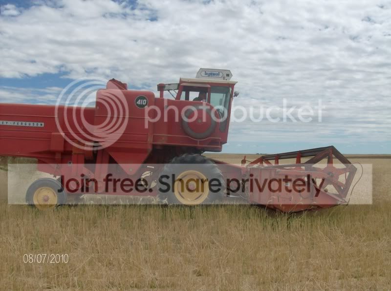

410 massey combine
Awful to work on, just awful, and the engine made the cab HOT...did thresh good, but I would rather run the other red, silver, green, or orange.
I run a 540...similar to a 510/410, they are a little warm in the cab, but do a real nice job of threshing in my opinion. If a guy could find a nice straight machine that had been maintained I wouldn't be afraid of it.
Masseys always did a real good job of threshing and cleaning BUT as someone said they are brutal to work on and I mean brutal. The engine compartment is cramped and alot of repairs require removing the drive wheels. Parts are unbelieveably expensive and some are hard to get for the older machines. Maybe look for a nice 6600/6620 Deere or a M2 gleaner. Good luck Ron
I know what u mean.I like I.H. red myself.But this old combine comes with both heads it is clean and cheap.But I guess u get what u pay for.Might be -?-- when it breaks?

We have one and it works pretty good. They are a bit hard to work on if you have to climb up in them (especially when we had to put the grain pan back in my 10yr old brother was the only one who fit!) Our cab has a blower in it that keeps it decently cool. Ours does have a large header but we don't have especially large yields most years <50 BU/A wheat.
We were having issues with the gearbox randomly cutting out on the header thus the skipped wheat (this was an insured field that got hailed out anyways)
