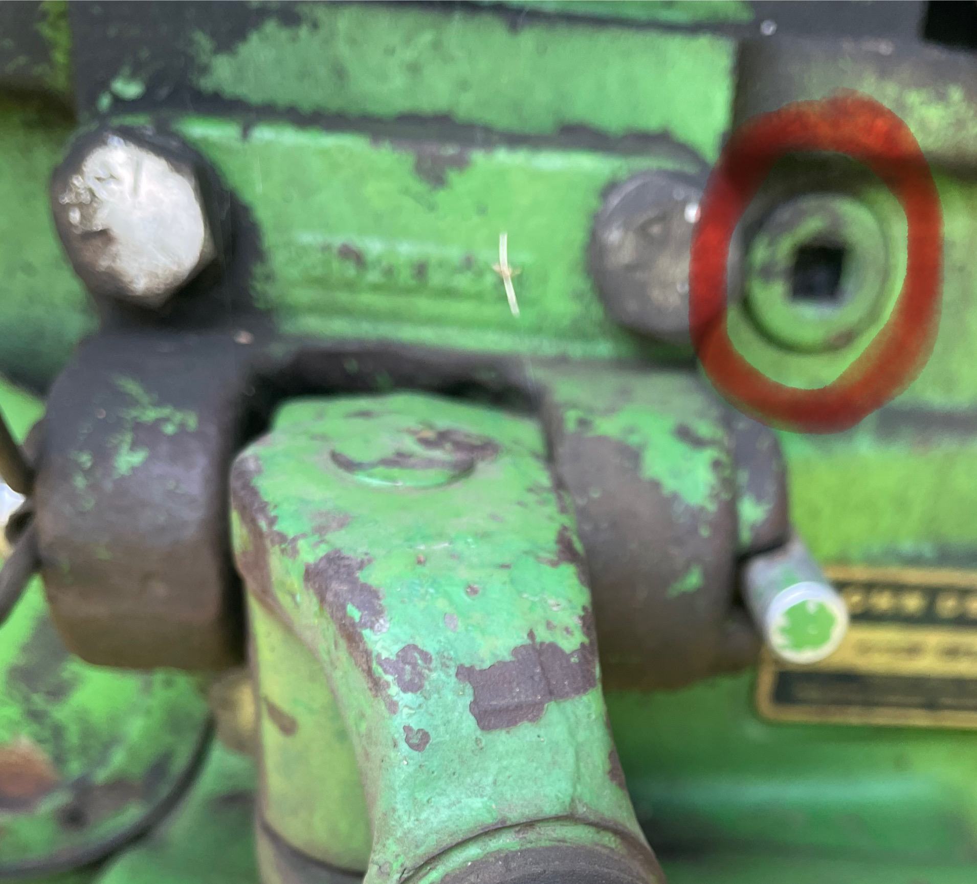

Yes you do need two returns. One is for everything but the pounder it can be returned to power beyond. The second needs to have 0 back pressure or the pounder will not work like it should. I would plum it in the plug to the right of the center link bracket.
Thank you, just to be sure, is this the plug you’re referring to? IMG_6100.jpeg
