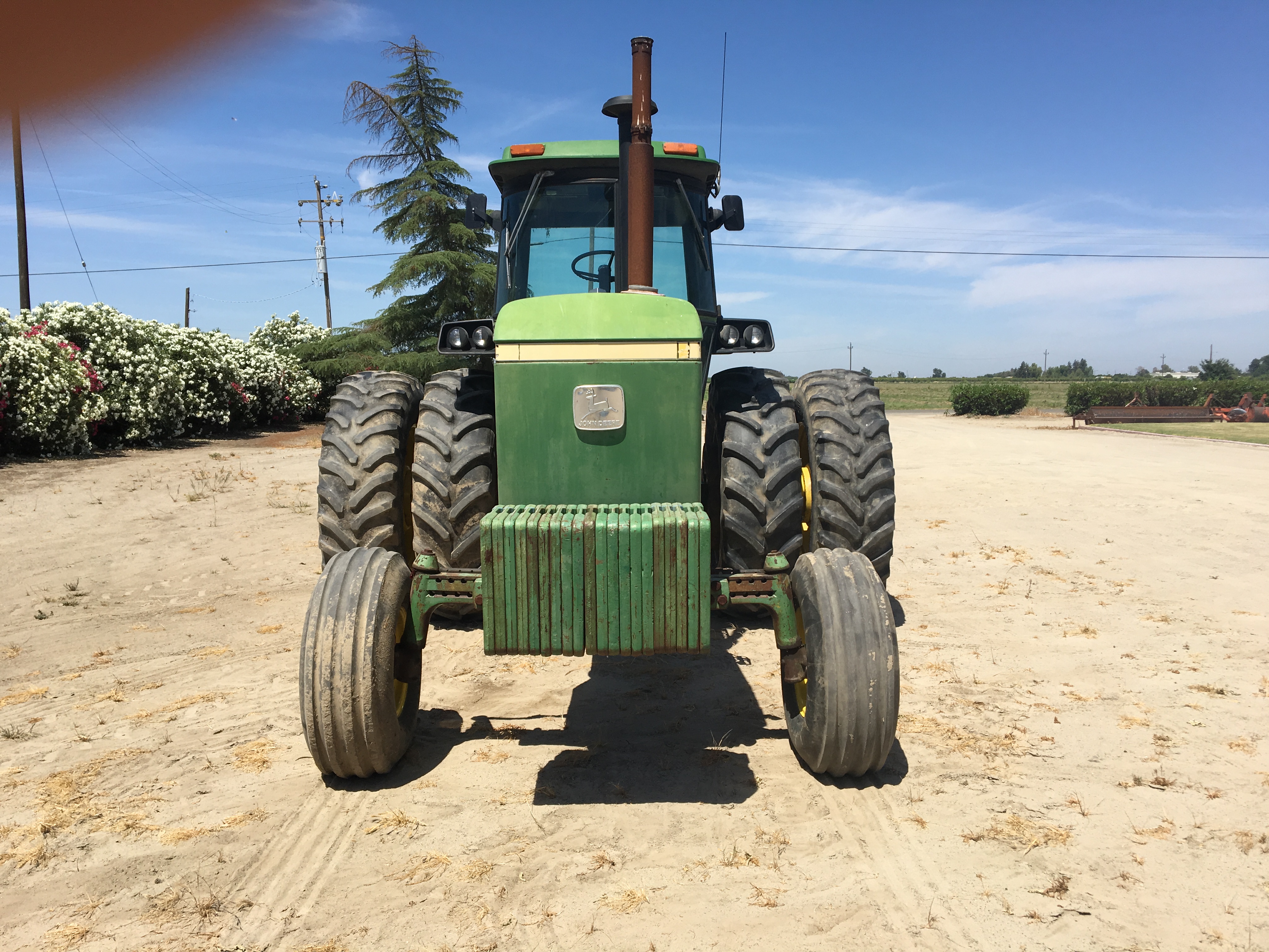

That’s my old 4640 I sold in 2016. I’m pretty sure that was the original medallion and you can see it has the writing. But if you look at old brochures on eBay, none have the writing.

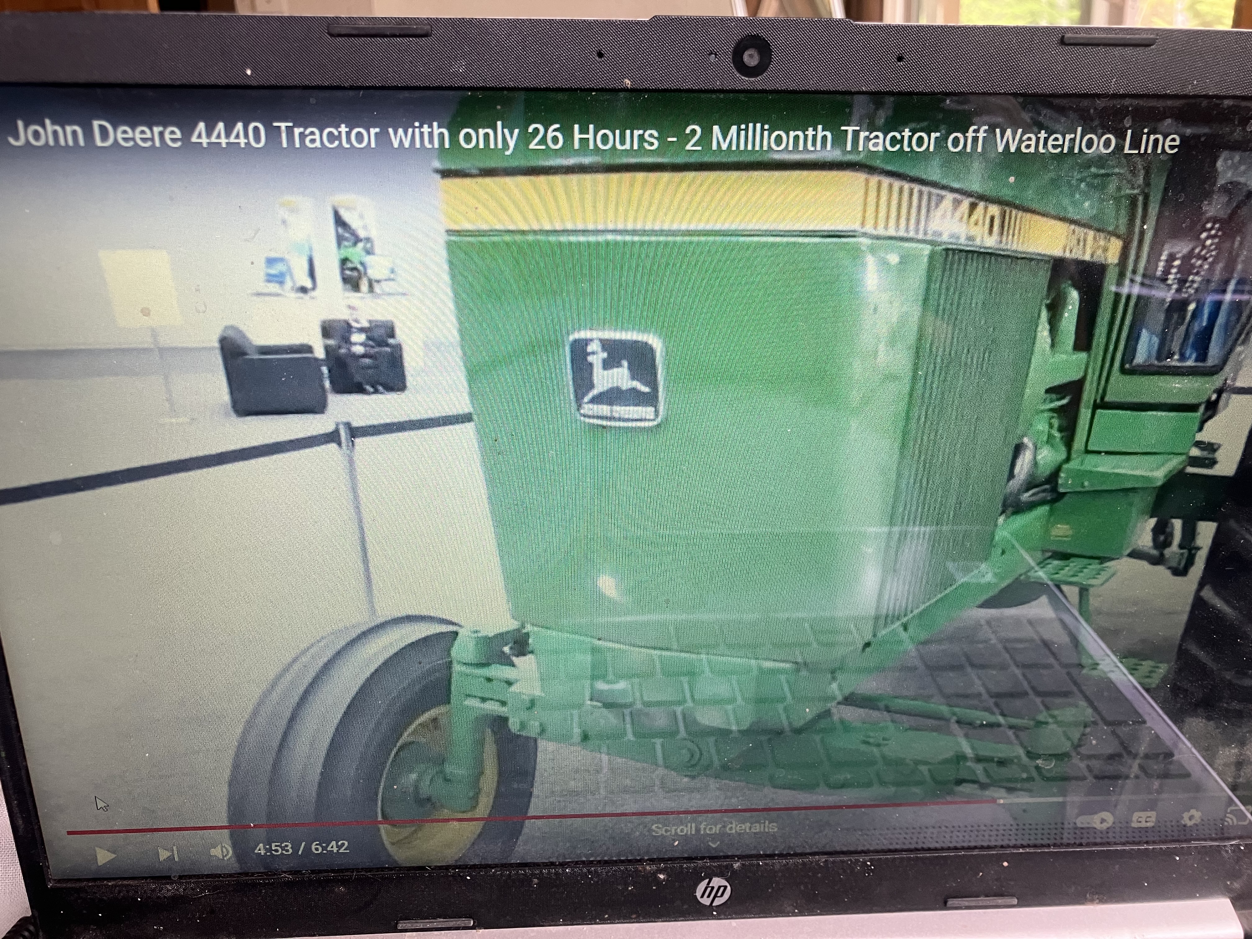

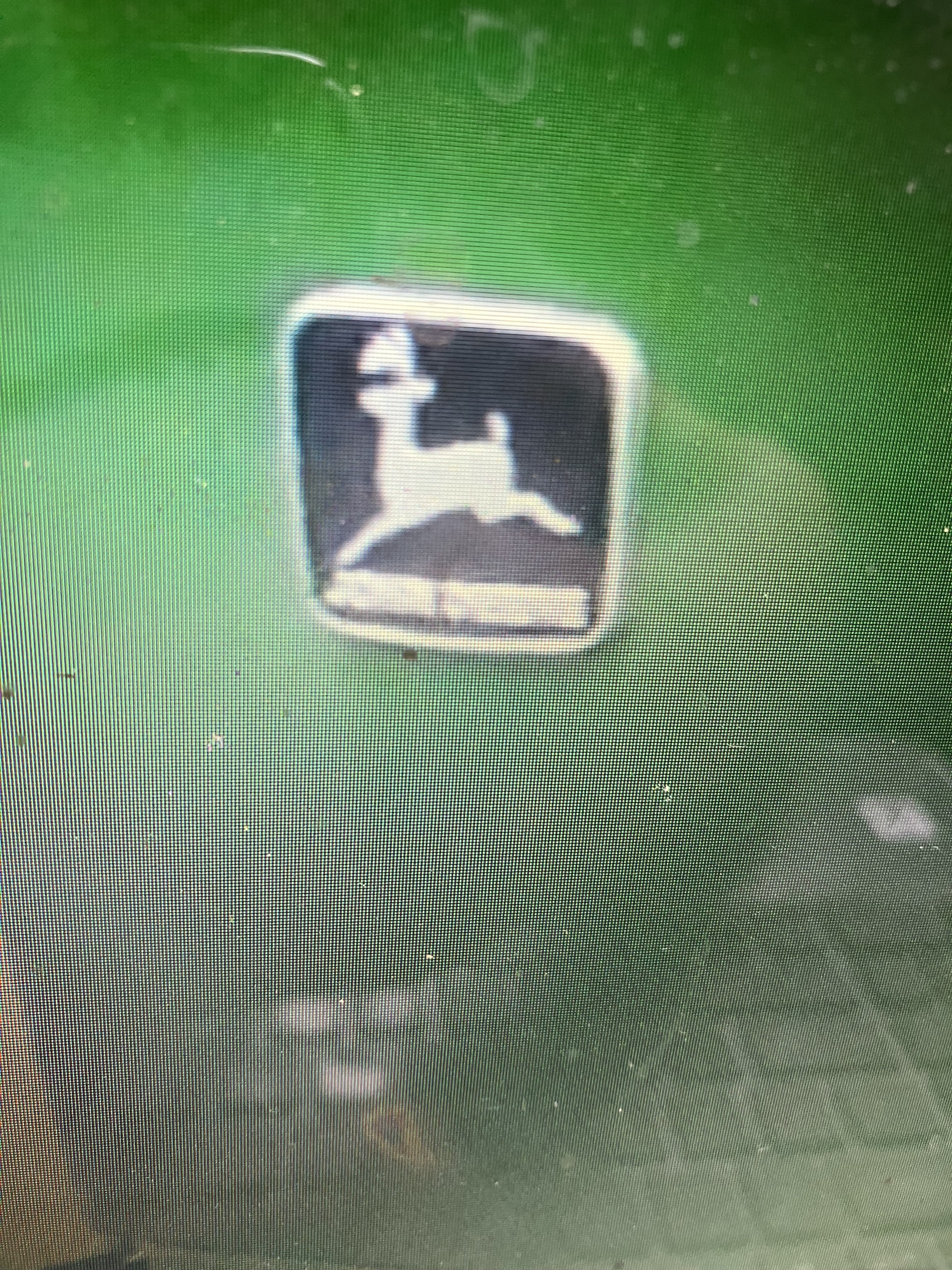

Here’s the 2 millionth JD. 1981 4440 with 26 hours completely original. Clearly has the words John Deere under the logo. My 4640 was an 81 also. Any chance they changed the medallion between 78 and 82?

Looks like 40 series came both ways. What year is your 4440? My 81 4640 and the 81 4440 that JD has both had the words under the logo. And all the plastic replacements have the words.
