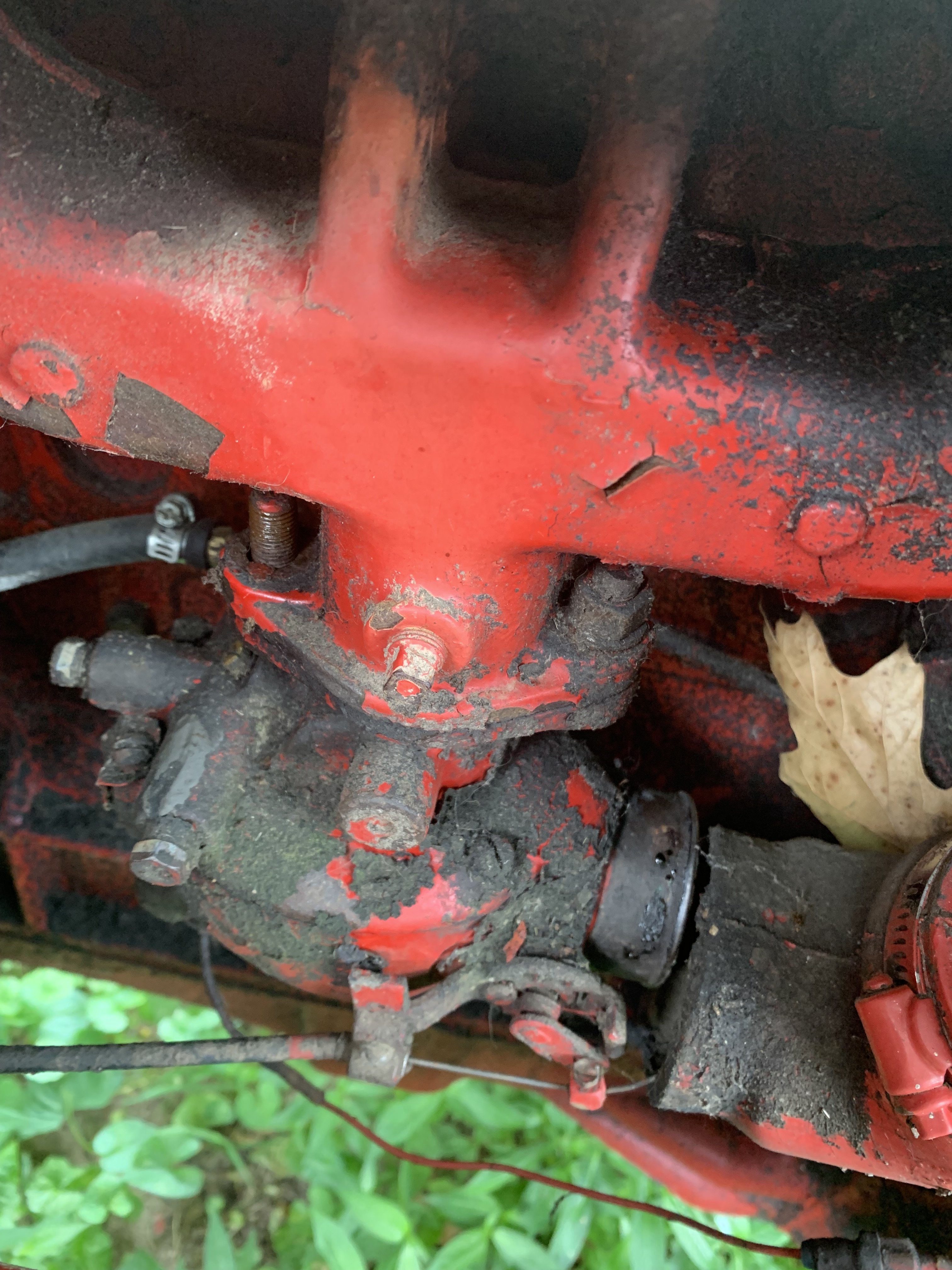

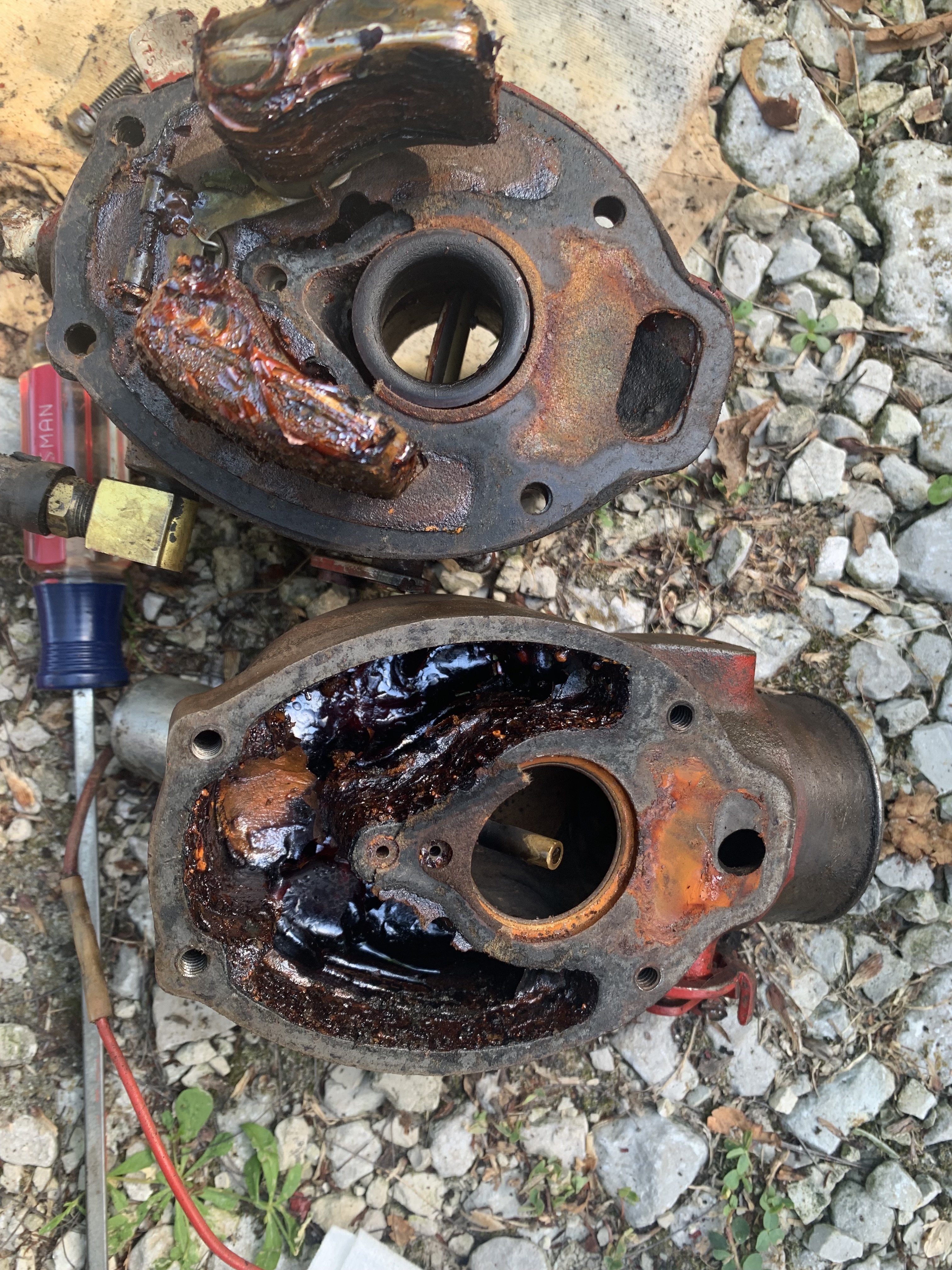

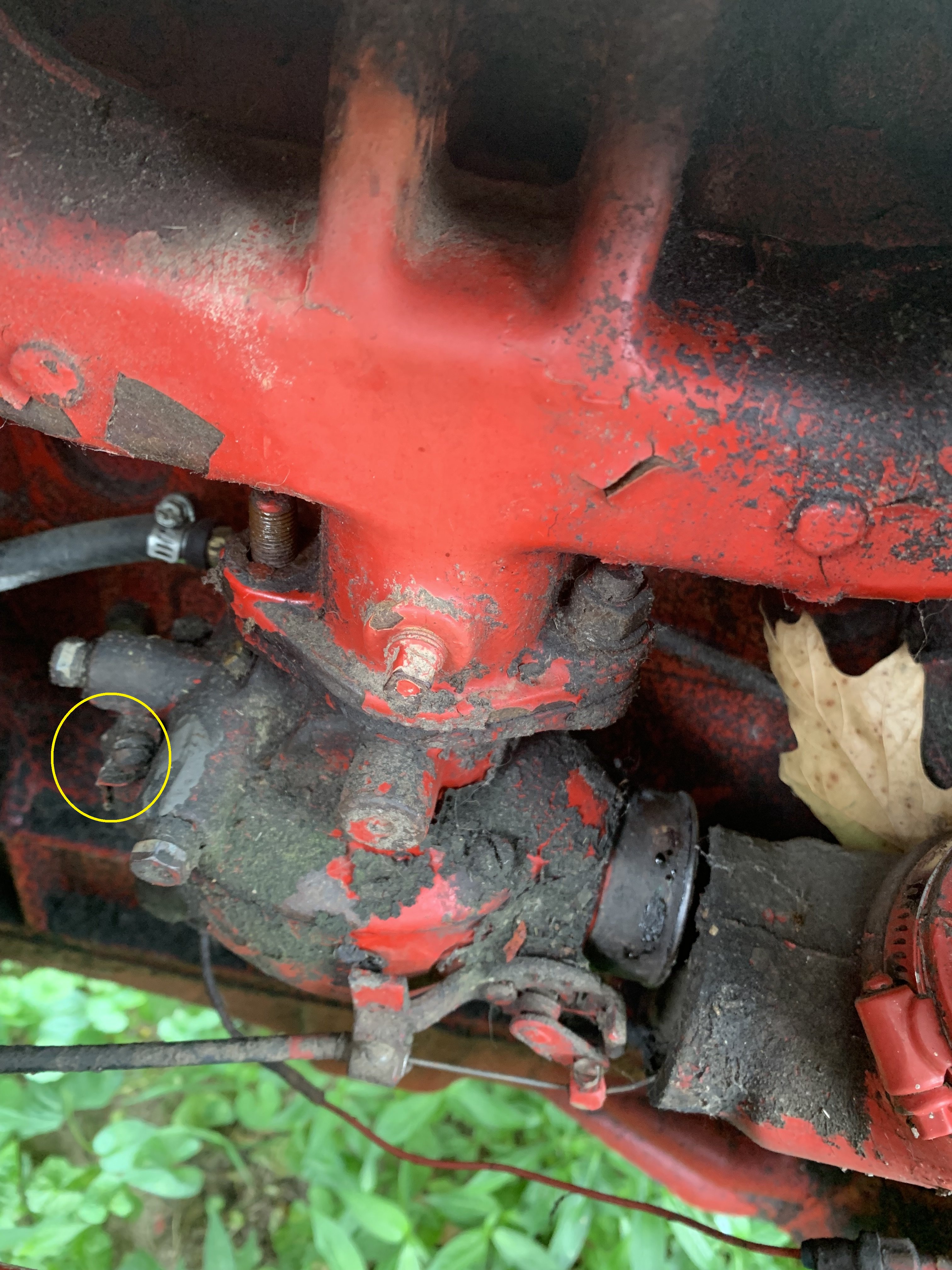

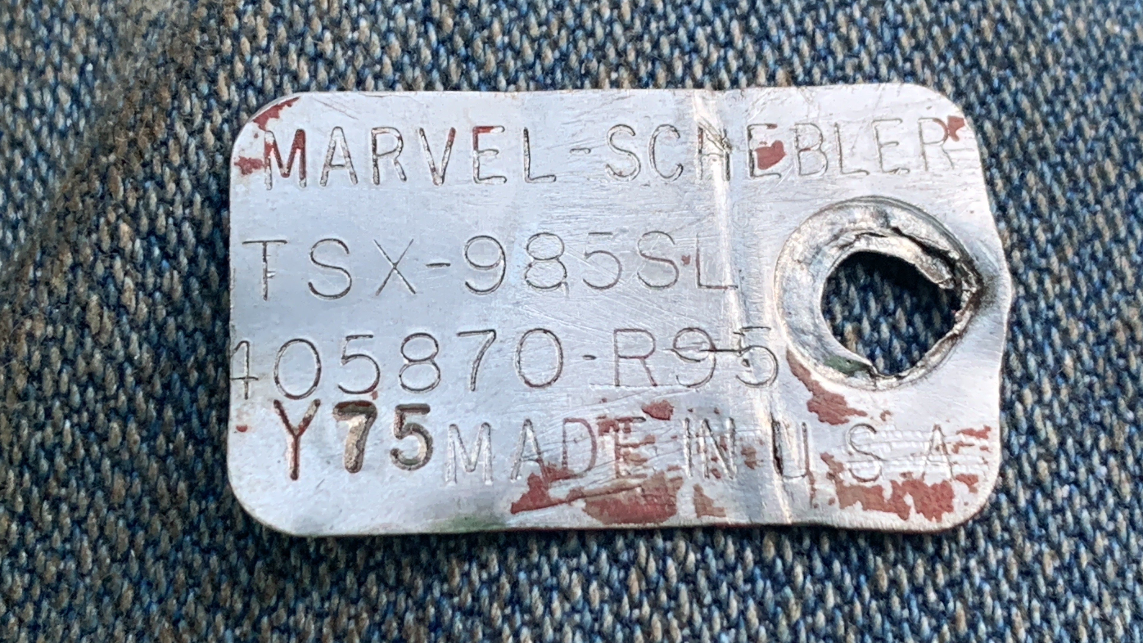

I have been helping my son in law on his international 464 tractor that won’t run. We installed new points and rotor and plugs. Have good spark. Next I pulled off the carburetor and found it was in bad shape. (See attached photo) I cleans it and installed new gaskets, float was good.
Using starting spray the tractor will fire and run for few seconds but acts like no gas is getting into the carb. Fuel pump working ok and have fresh fuel at carb. My question is how does the fuel shutoff solenoid work, And can it be bypassed? I ordered a parts kit for it using the tag but the new float was too small, used old one.

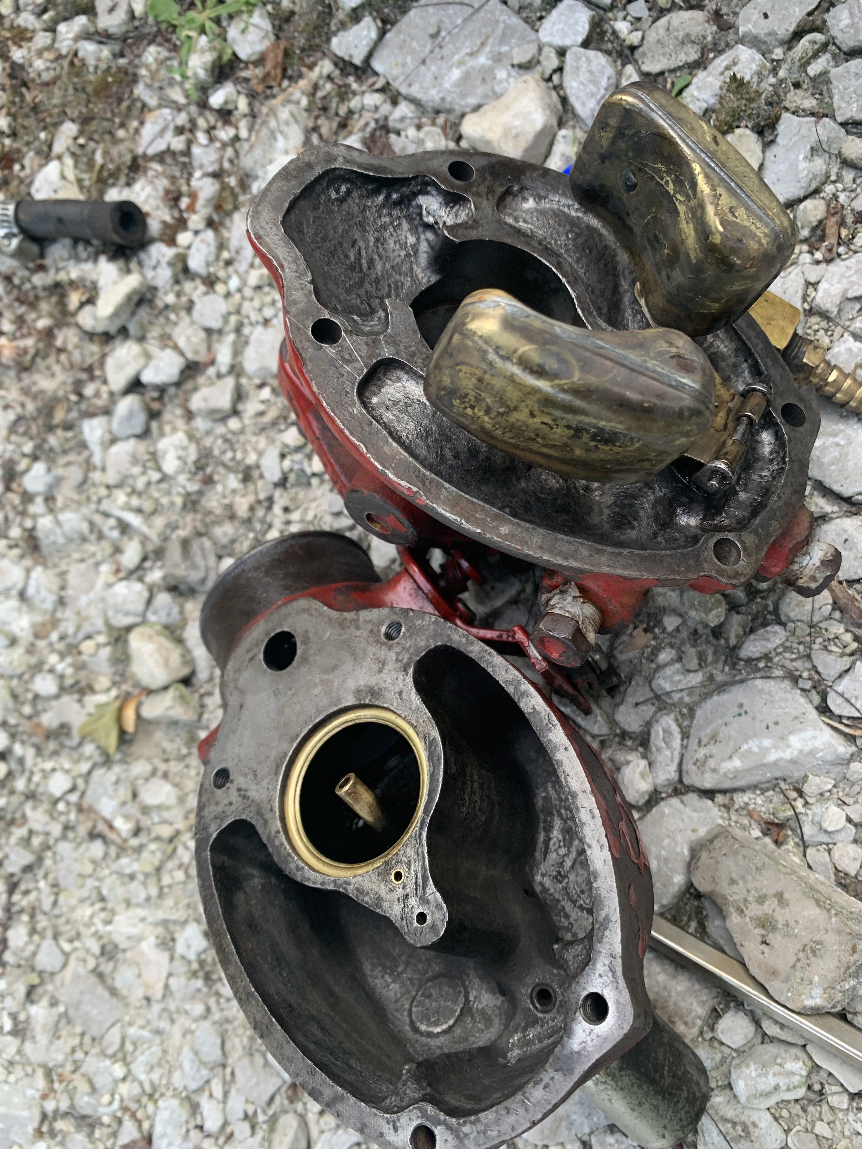

That carb is still a mess it needs to be soaked overnight in gunk and agitated every so often. Them passages probably still plugged. Everything needs to be spotless. And that tar on the float only adds weight to it.
I disassemble , remove the float, and then boil everything EXCEPT the float in white vinegar for 30 minutes. Then take a wire from wire brush and poke through every tiny hole in the carb being sure not to miss any. Soak it in a baking soda solution, rinse it and then dry thoroughly with compressed air. Blow air through all orifices . Others may have easier methods. Just curious, would it start with choke partially closed ? If so it points towards a clogged carb passage.

I ran wire through all of the ports and blew out everything,and no it would not start with choke or not. No fuel smell or excess coming out of carb.

Is the whole ID tag in place? If so, what are the numbers on it.

Just assuming its a Marvel Schebler TSX type . Only 2 or 3 were used on that tractor I think ???? Someone may know if the same adjustor would fit all models possibly. Those carbs have many similarities

YT may have the parts if you call them with the TSX number.
I have replaced several solenoids on John Deeres with the manual adjusters from McDonald's. I called and gave him the TSX number from the tag. He had the adjuster and gasket for it; the main jet itself does not get changed. He will have carb kits if you need one of those as well.

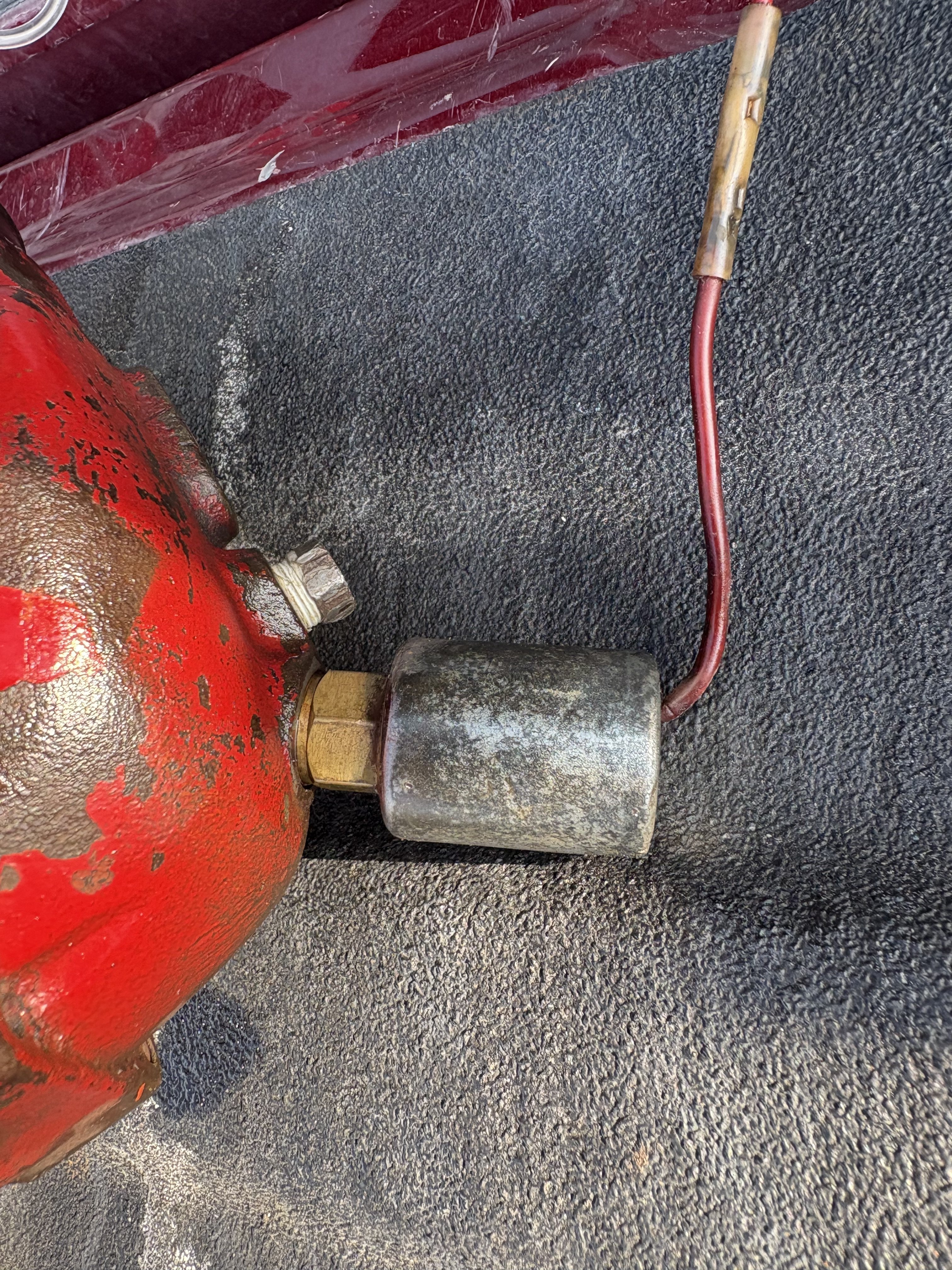

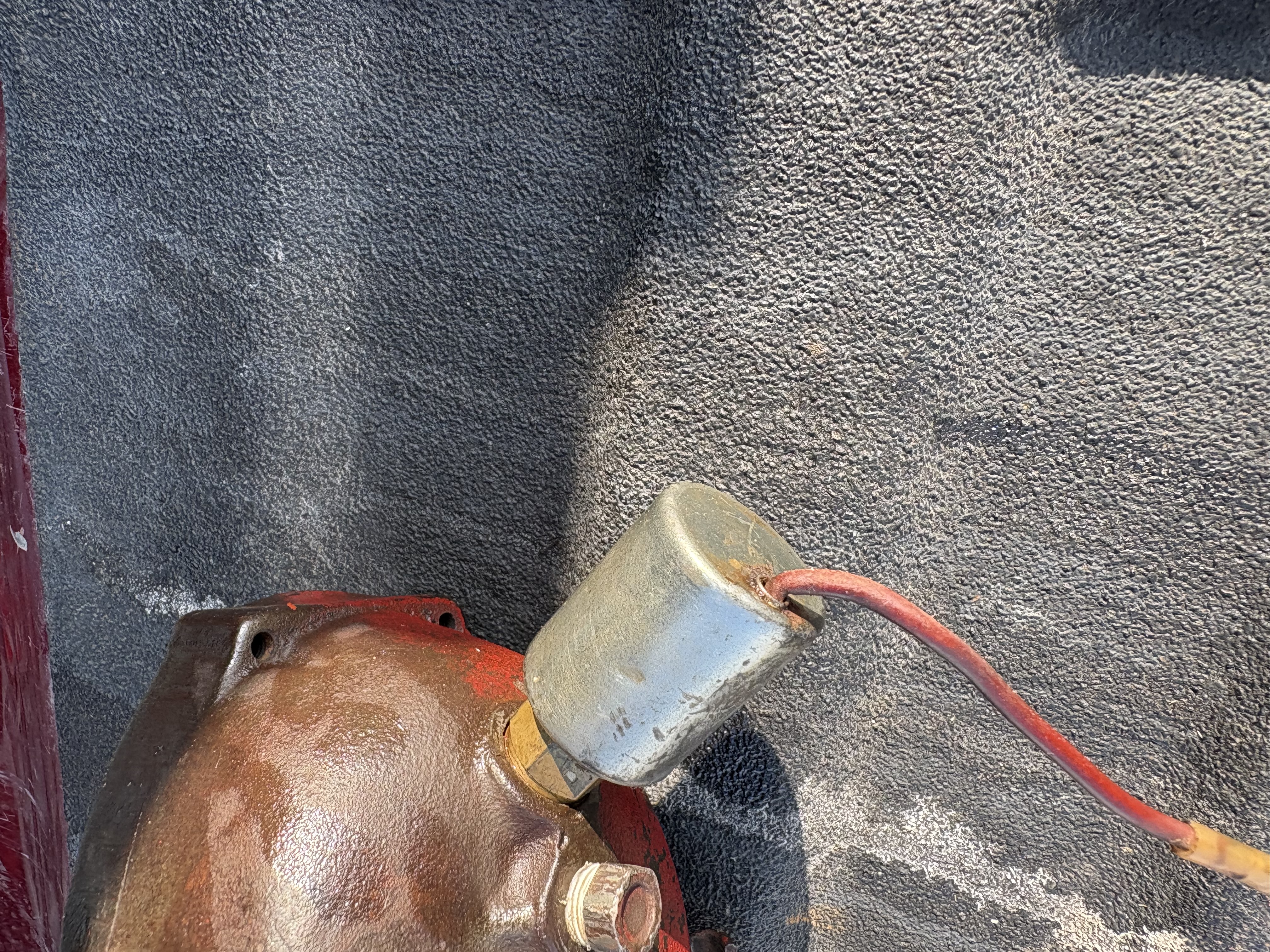

Here is a picture of the solenoid, I see no numbers of manufacturers name or ant adjustments.

You have one of the non-adjustable ones. PartsASAP/YT has one, link below.

Have you tested this solenoid? Ground the body of it and apply power to the wire. You should see the needle inside it move in and out as power is applied and removed. If it doesn't it needs to be replaced. My choice has been to convert to the mechanical adjuster for the main jet (for about $50.) If you want to go that way you would need to call YT to see if they have it for your carb. You should get the new gasket for it as well.
