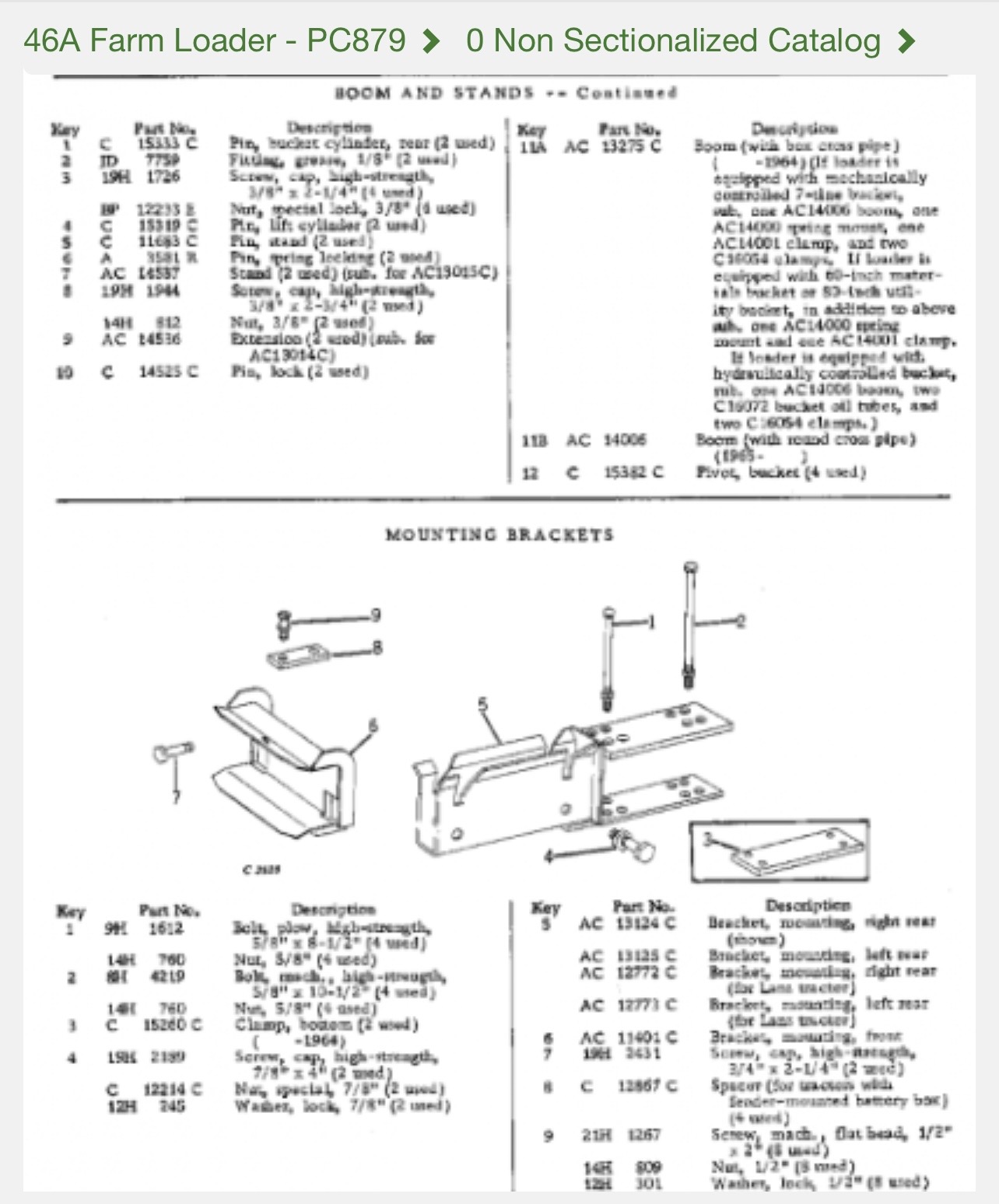

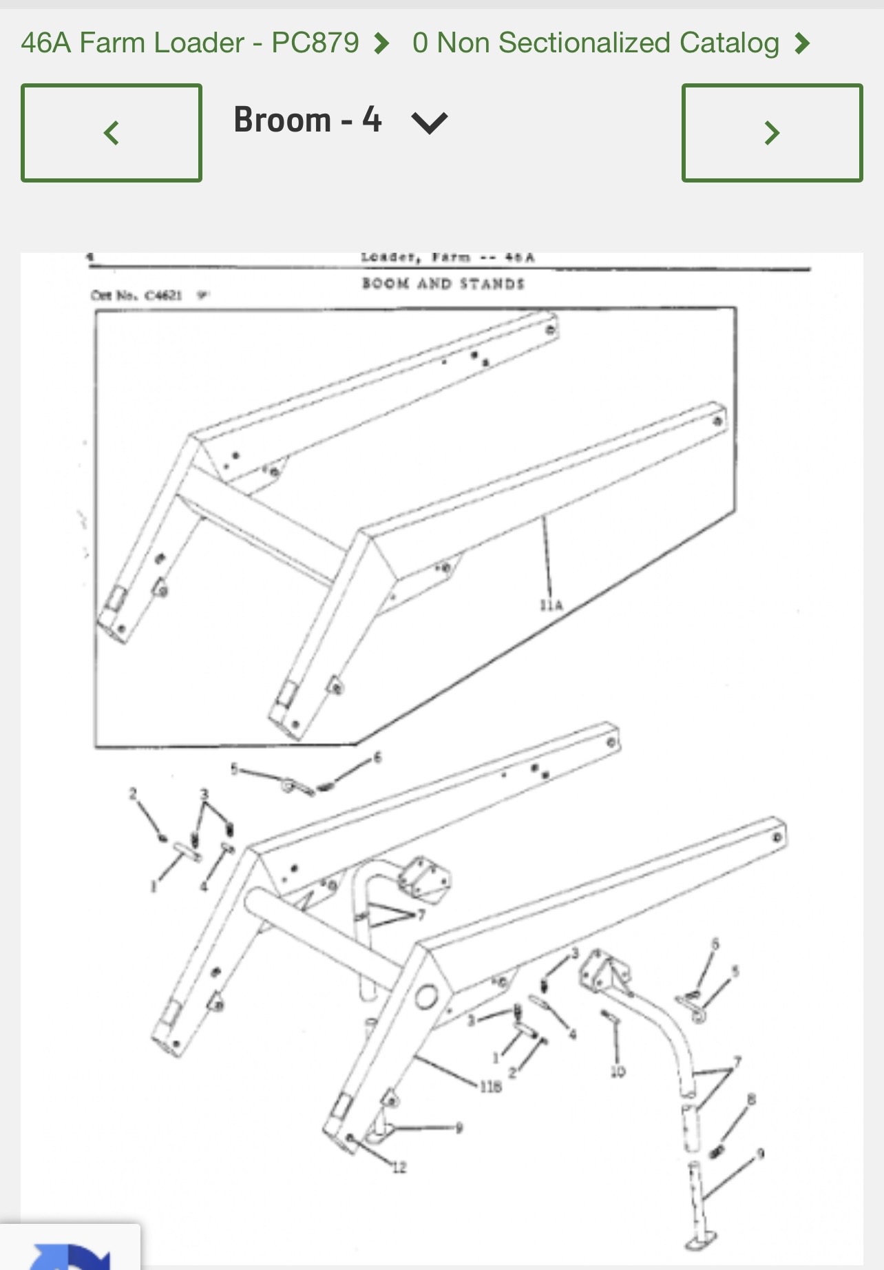

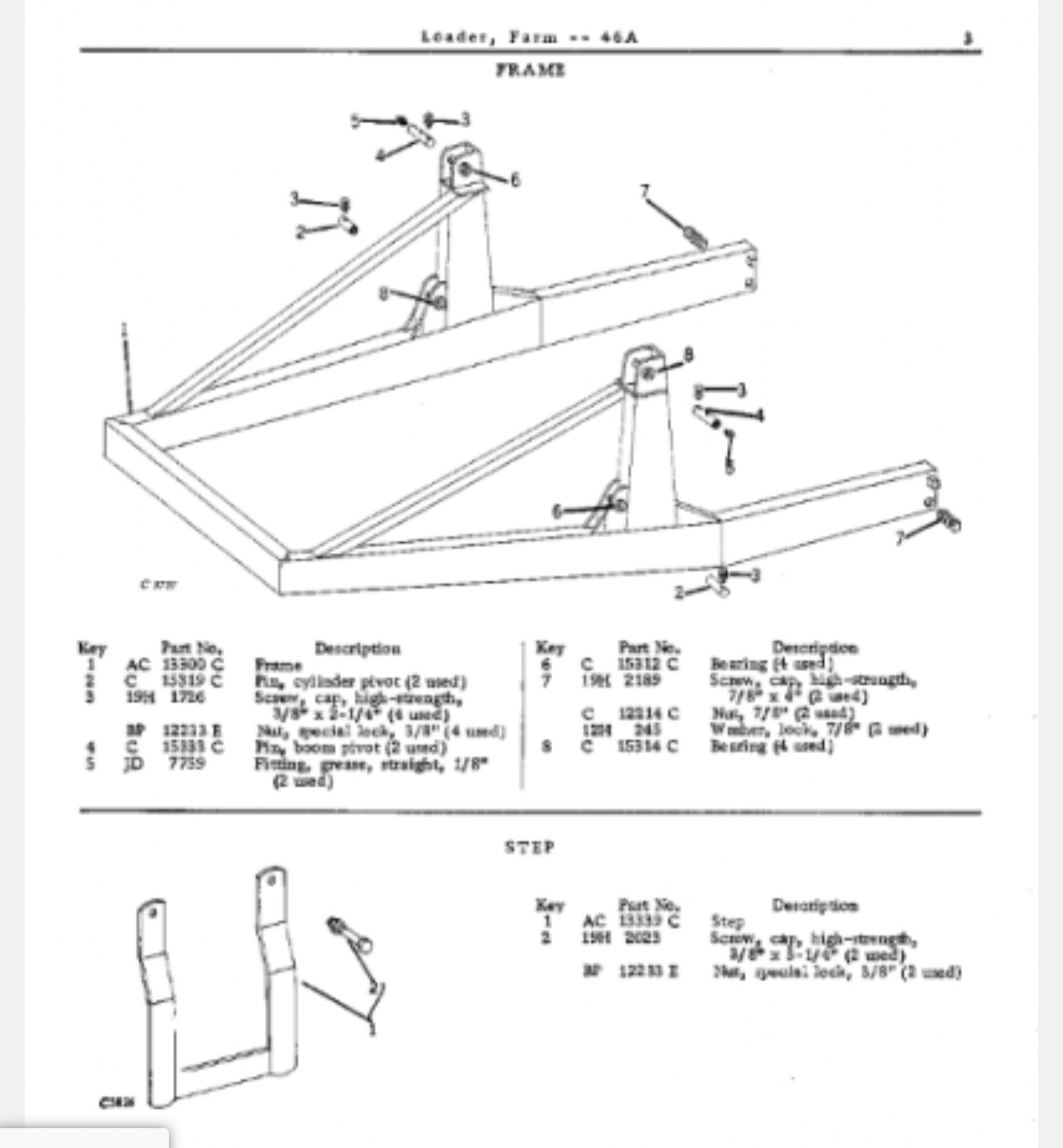

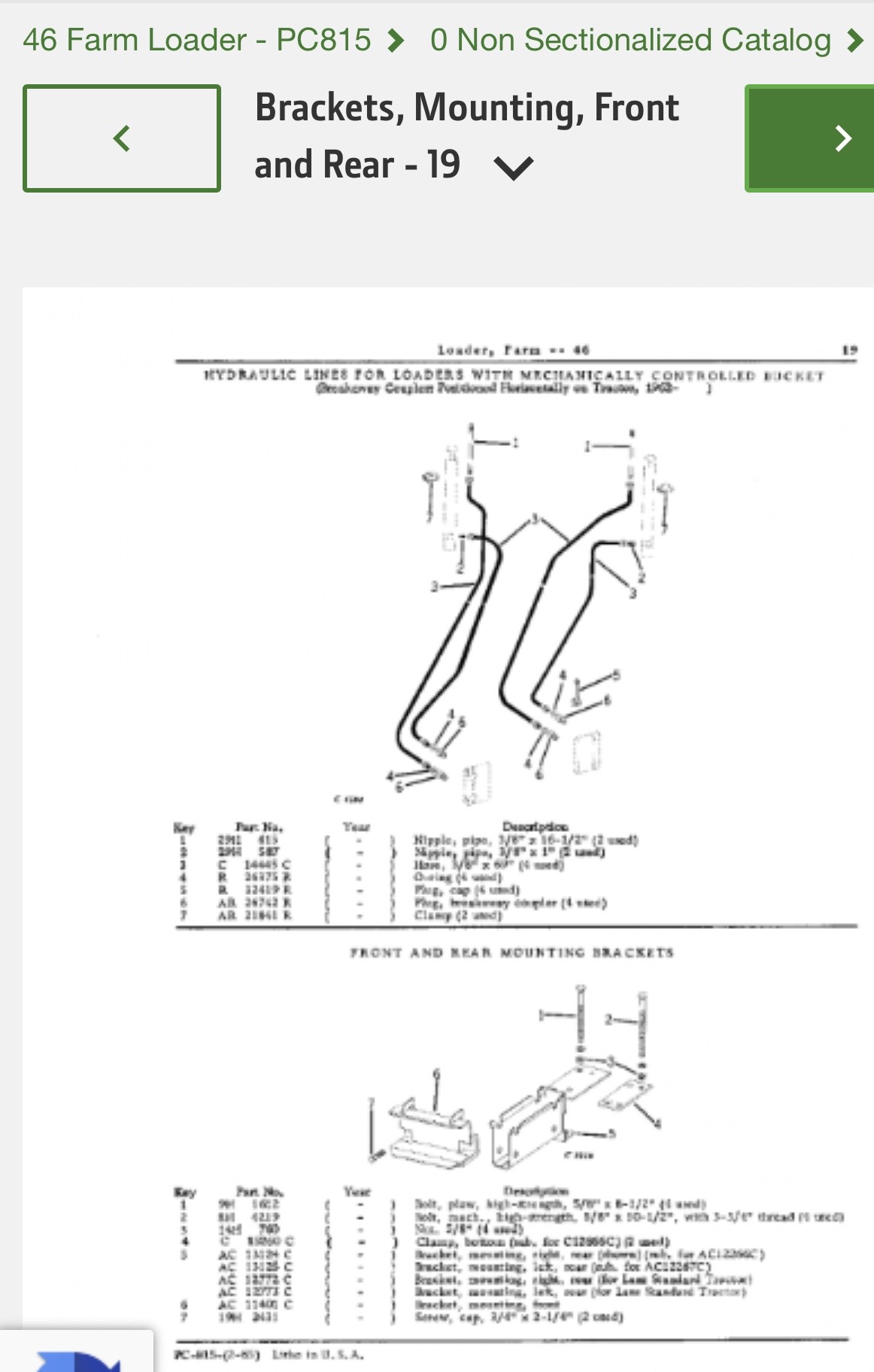

Thinking about buying a 46A loader to mount on my 630 standard. I’ve heard of people using 46A’s on two cylinders but haven’t found any pictures. My concern is how well does the loader frame fit around the belt pulley or does frame or mounting brackets have to be modified to make it work? Any one out there have pictures of a 46A on a two cylinder?
I have one on a 3020 and it is pretty wide at the rear, since they were made for the 2 cyl.'s can't see what you are so concerned about. Facebook on Omaha Ne, has on listed on a 630 to answer your questions.
All that could be located for 46A and similar mounting hardware.

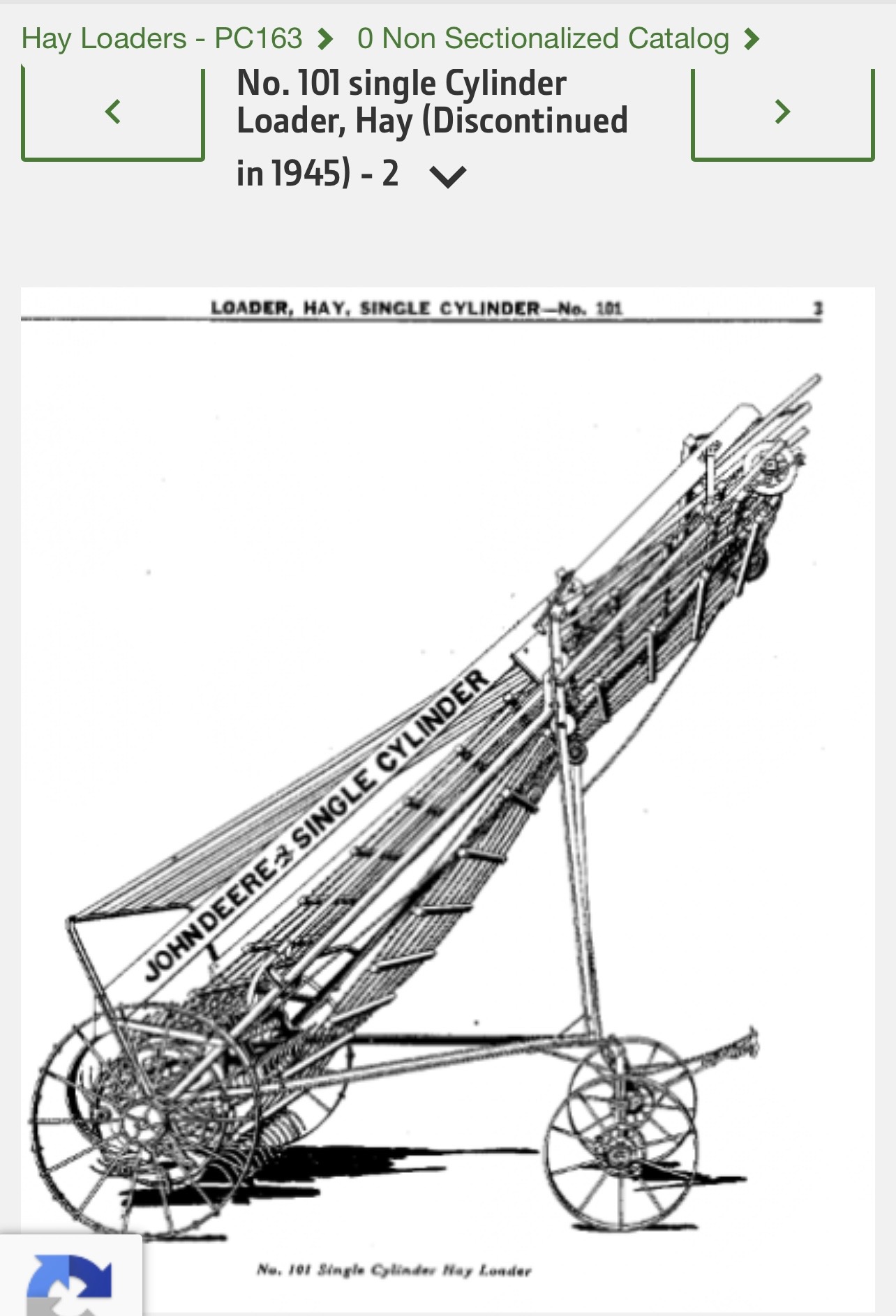

For interests sakes , a hay “loader” was built until 1946
