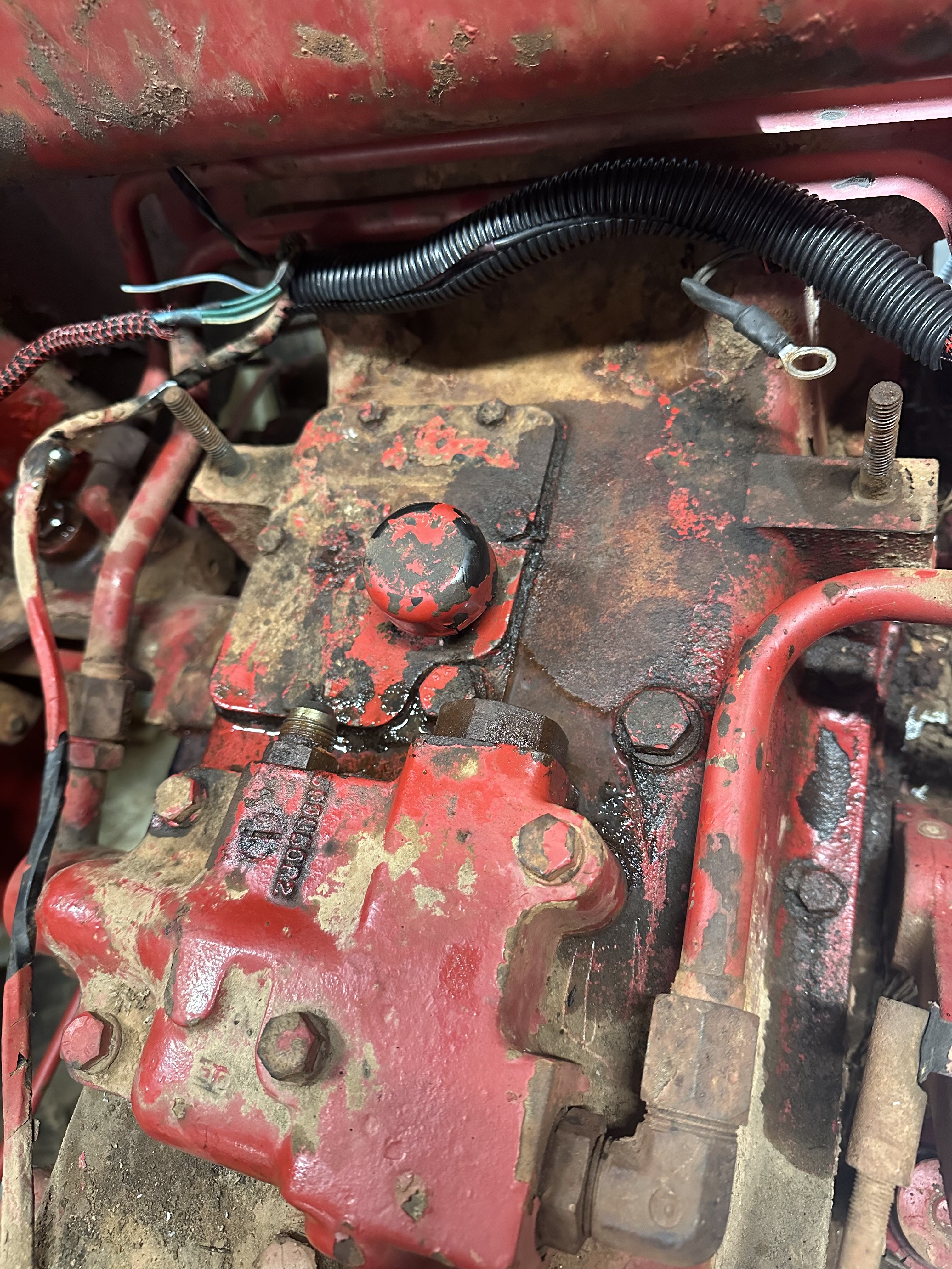

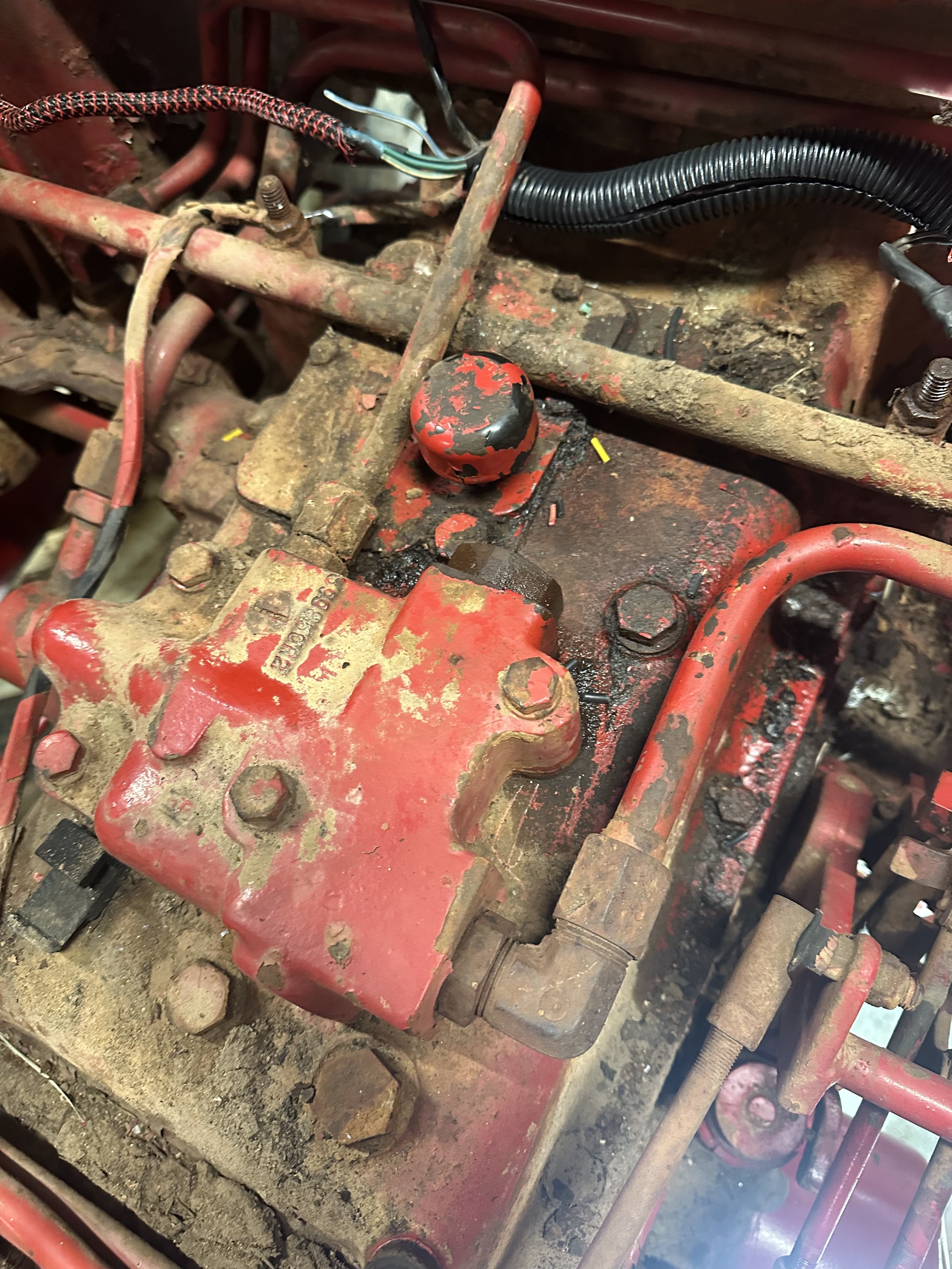

This is far as I got tonight had to take the pto lever all the way off ..it came all the way across and was working the valve close the the hydraulic filter ..right in the way
Got it JimB2. !!!!!!!! The arms came down. You hit the nail on the head .. that valve was stuck… now going to put it back together some and crank it up ..cycle it a few times to work that clean fluid in there
