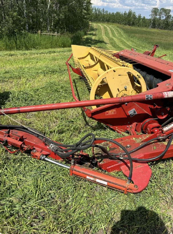

This is my first season with a 488 haybine. The tongue that goes from the unit to the tractor keeps breaking at the haybine. So, I stole another tongue from a parts machine, and I see that it's been welded and reinforced too. What the heck? This looks like a poor design to me with all the stress of the haybine sitting on this tongue bar where it goes into the haybine. You can see in the photo that it's snapped and dropped to the ground.

I just don’t like the looks of that cylinder on that hitch. My bet is that’s what is breaking the hitch. And for cutting the cylinder should be retracted and I see it’s extended for transport position. I have the 489 model and it’s a better set up than those 488’s. Mine don’t have that wobble box either. Gonna be cutting hay with it today.

Mine must be an older 488, it doesn't have the cylinder for transport/mow position.
Just has a spring loaded pin and holes in the frame.
A PO did add some angle to the tongue for strength, and welded in metal behind the cutterbar where it had rusted.
That said, dragged it out when I lost and was waiting on a bearing in my disk mower, mowed 25 acres like a champ.

Ya, that’s a hefty cylinder for this unit. So I’ve had to use it very sparingly just to move the transport. When it broke and fell, it pulled the cylinder out.
I’m not sure what’s going on with this thing as the metal in the drawbar seems rather thin in my welder’s opinion.

is there another pin to pull out before using the cylinder? on mine there is ,and u use a rope to pull it and hold till it pops on the hole u want. then just pull ahead or backup to move the hitch.

Yes, mine has a spring pin. I suspect the reason the previous owner put a cylinder on this is that manually moving it forward or backward doesn’t seem to move the position very easily at all.
Yep, someone got creative because thats not the way it was designed. The 488 might be one of the longest produced hay machines there is, they were first made in the 70s and they still make them today. The design isn’t the reason its breaking.

Well, we found an old drawbar from another unit. It’s got a lot of reinforcement and welds at that joint as well. Notably, this one did not have a cylinder attached to it. We installed it… And so far everything’s good.
The one thing about this drawbar as well as my other one is that I find getting into the transport mode extremely difficult. You’re supposed to either back up or move forward to change modes, but nothing is moving. I’m assuming the nut that holds the drawbar in place (on which pivots) is supposed to be tight. Correct?

Yes. It takes some practice. When I used one, I would keep a small piece of 4x4 on the haybine to use as a chock when trying to get it into transport mode. Just put it behind the driver side tire and back up, it should slide right into place. Getting into cutting mode should be simple without a chock, just pull forward, maybe steering slightly to the left if needed. Sometimes on certain hillsides I would have to pop the clutch.

Do you by chance notice any polished areas on the tongue where the rear wheels of the tractor are rubbing against it during very tight turns?
Do you go round-and-round or back-and-forth mowing? The problem with round-and-round is the corners keep getting tighter and tighter which brings the tongue in contact with the rear tires. With a 9' machine we'd go 8 times around the field and then do the rest back-and-forth. By the 7th time around the turns are getting pretty tight.

just looked again at ur photo and that dont even look like a factory thing. some ones idea it think.
That cylinder setup is bad, bad news... it would need to have some sort of slotted, sliding mechanism on the tongue. I suspect that the cylinder is pulling/pushing the tongue with respect to the pivot bolt.
Just looked at my 479. Yes, the tongue is under designed for strength. My good one and my parts one have fish plates welded on all 4 sides. The design is almost as bad as their jacks.
