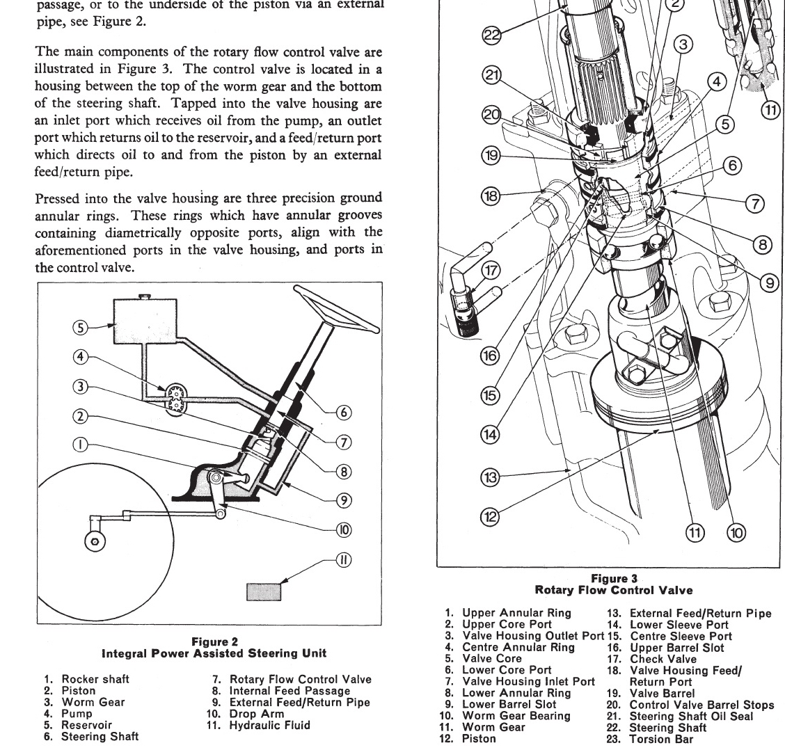

Ok I will try that but shouldn’t the relief valve protect against spicks also does anyone have a diagram my system doesn’t have a steering valve with the 4 lines together or the cylinder under the radiator I will put some pictures on here when I get back to it thanks for your help

The diagram can be found in chapter 9 of part 12 of the 5000 repair manual. As with most Ford manuals, the info is somewhat lacking in detail. For example, the relief valve is not shown in this image.

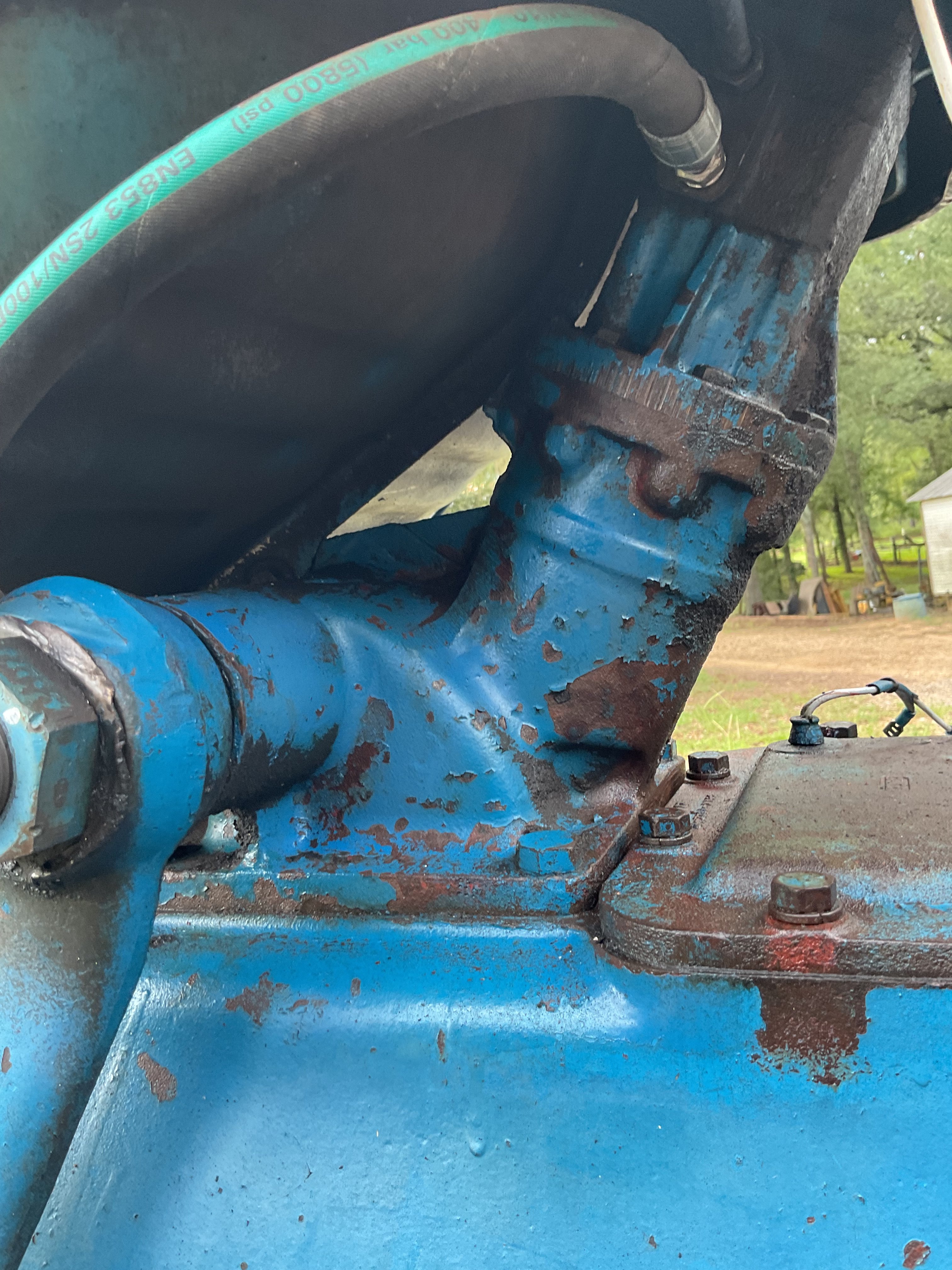

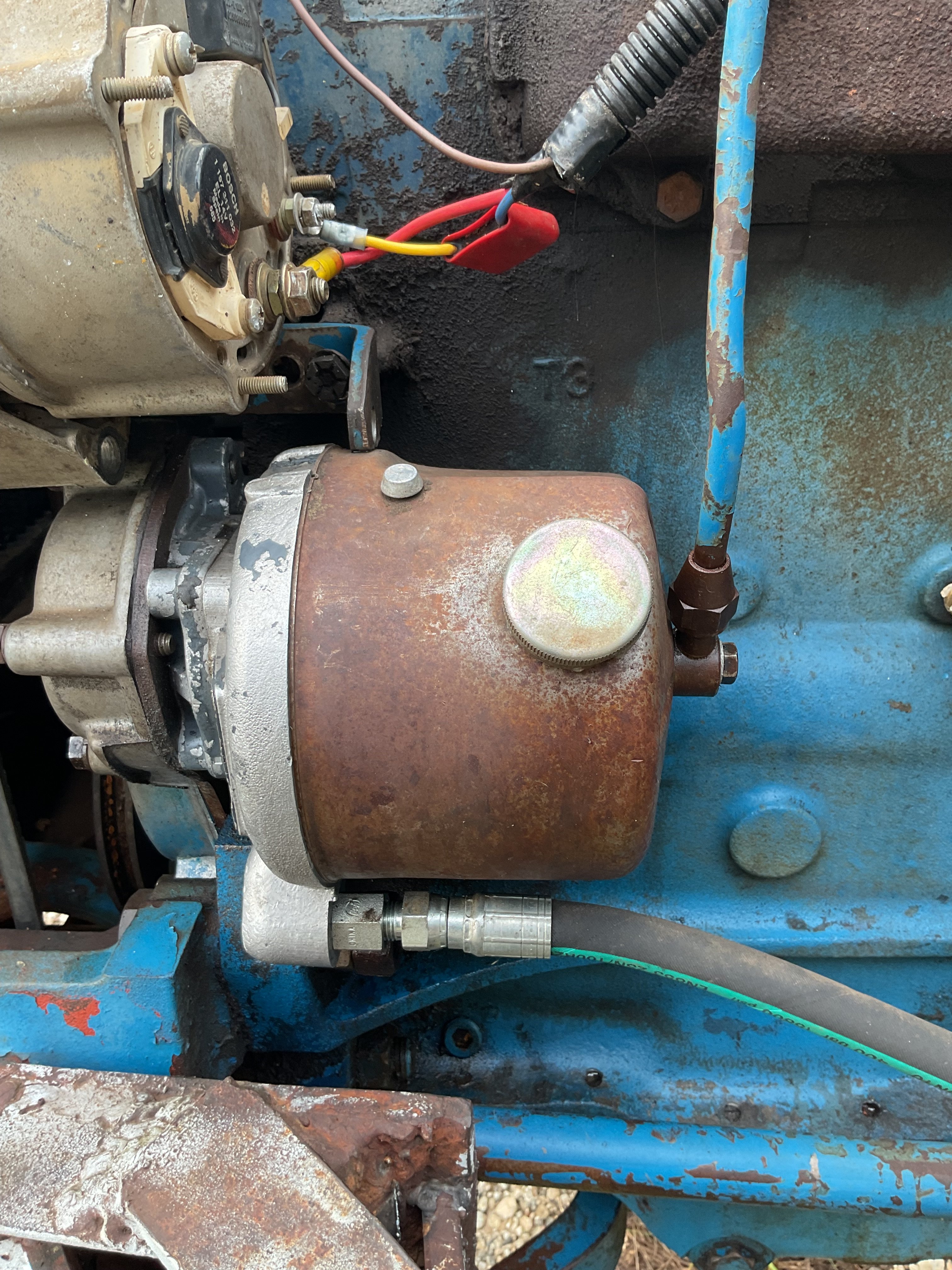

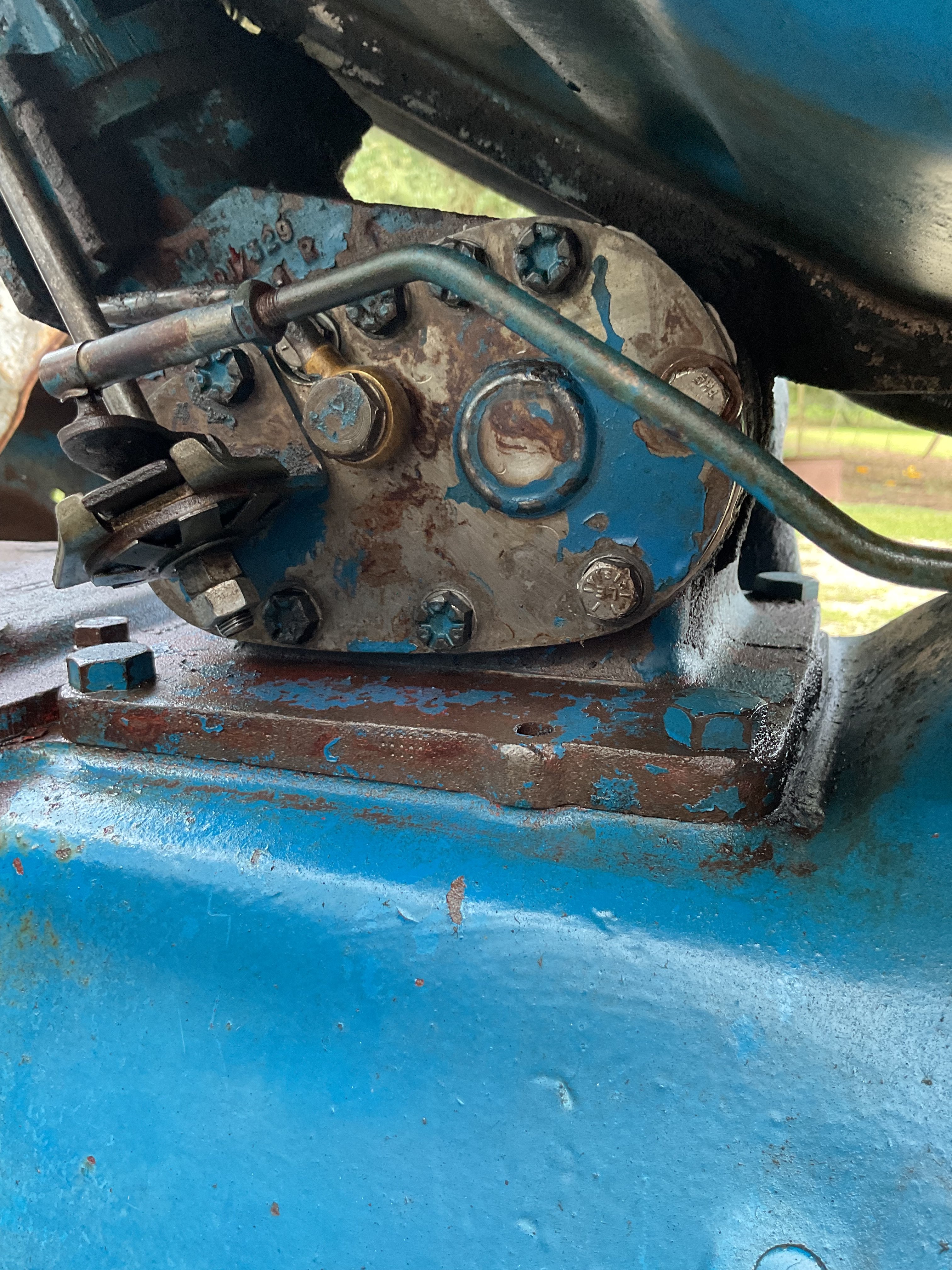

Hey guys I haven’t hit any external obstacle to get a pressure surge it will blow out when I turn left and it popped the same bolt both times the one you can see at the bottom left I really appreciate all of your help this is a great tractor if I can just keep some power steering fluid in it the first time I had hyd. in it the second time I had trans fluid in it
If it keeps popping new grade 8 bolts, you've got other problems going on inside - it's not a hydraulic pressure issue. I would start by checking the output shaft end play to make sure it's within spec. Either that or you're overtorquing the bolts.

Thanks Bern I will get back at it tomorrow especially the the information on the link as I don’t have any technical information to guide me and the time you have to share your expertise to help me I will check the sector shaft closer. The reason you don’t see the broken bolt is because I have resealed it and replaced the bolt.
After breaking two bolts multiple times with the other bolts staying intact, I would think that the cover plate might have become deformed. You might consider replacing it after you figure out the root cause.
