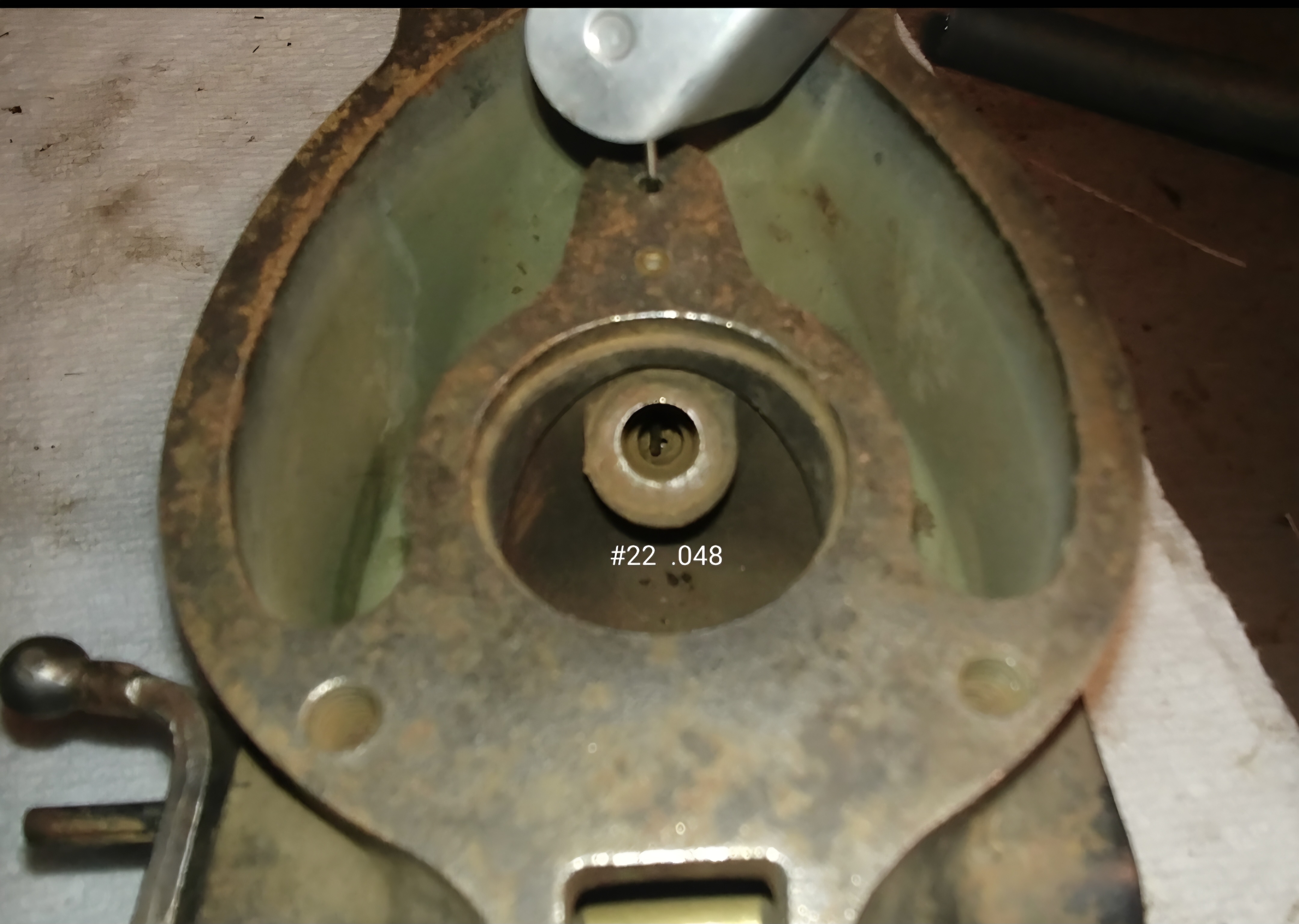

Idle curcuit headwaters are where the .048 wire pokes out just above the main jet. (Sometimes the stepped passage is partially blocked with sediments)

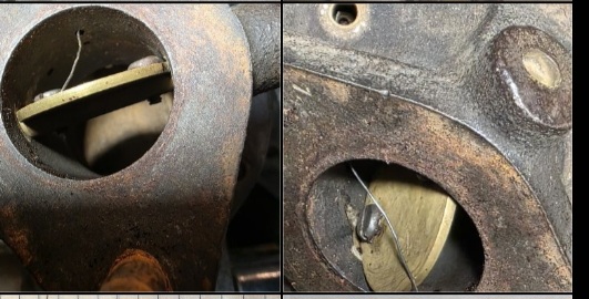

These pics show poking a wire through the primary idle orifce and down to the spot the idle mix screw lives.

thank you, very good picture of what I will try to do today much appreciated
