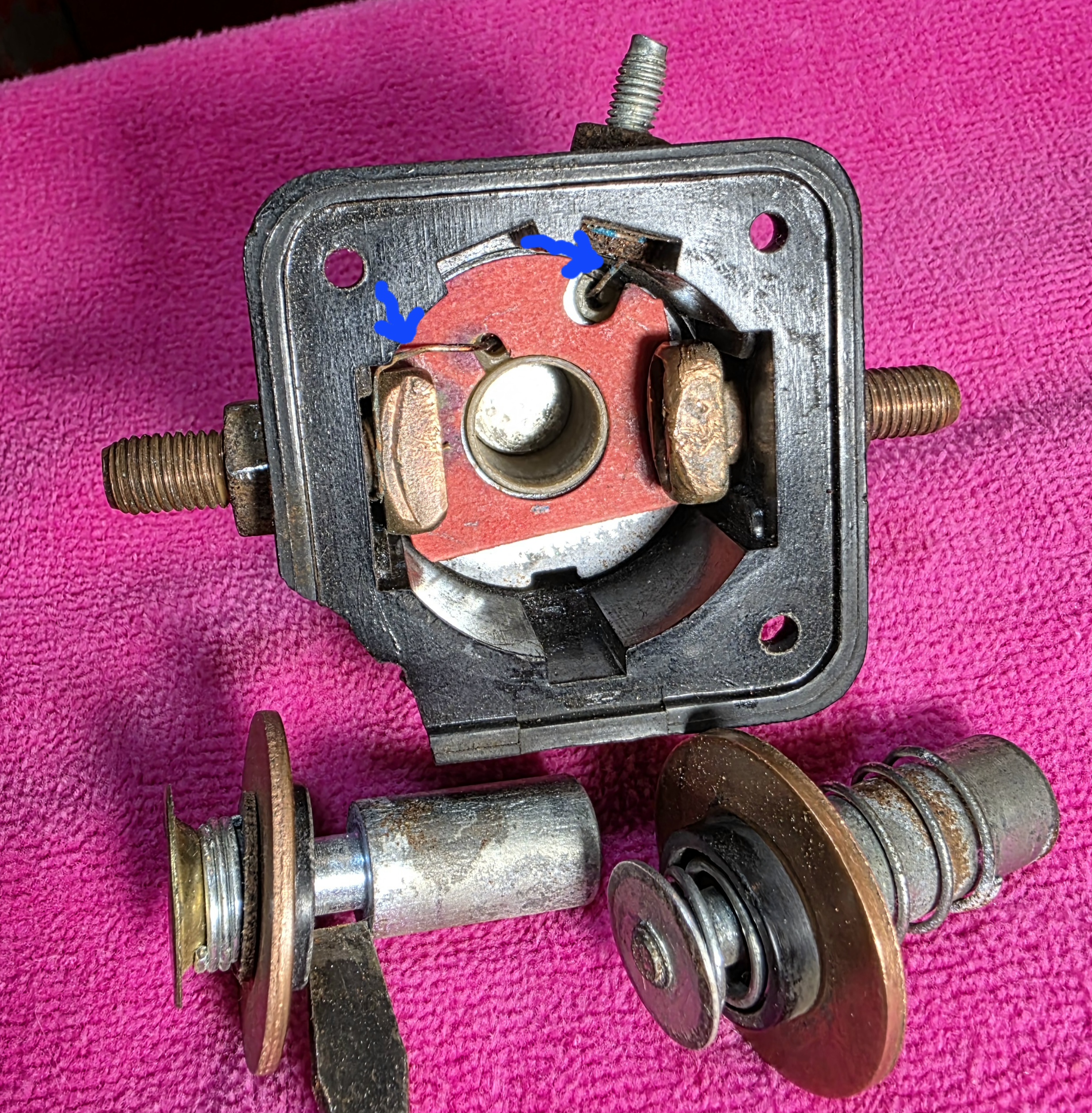

Here is a N solenoid.
Blue arrows point to the electromagnetic coil wire ends. One to the small terminal, and the other to the rear facing big lug. They should have continuity. ( maybe .7 ish ohms) The small terminal will show battery volts. (dont need to push the starter button, it's hot as long as the battery is connected up to the tractor)
Screwdriver showes the defection ability of the copper contact disk. (pic showes an "extra" contact/plunger)
When you got battery volts across the solenoid (between large posts) its because the starter post (field terminal) connects to ground through the field coils, and armature windings. It's a good reading.
