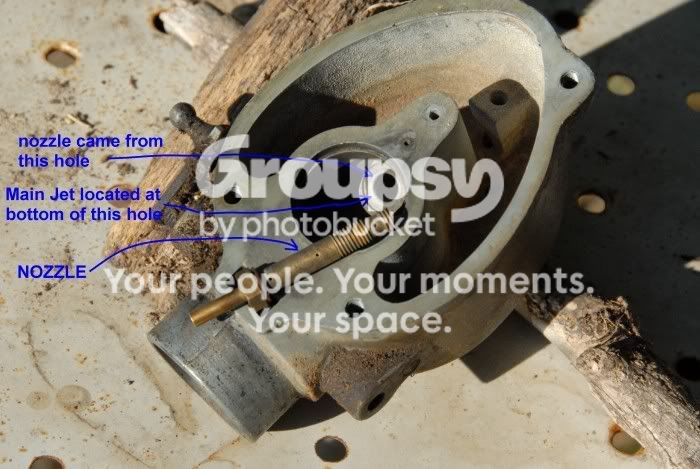

Hey its been awhile since I have posted but the ol 52' 8N 12V decided not to start on me after sitting for about a month now. I checked for spark right away and had great spark at the plugs, then checked for fuel and had great running fuel. I pulled out the main jet and it had what looked like rust build up on the neddle and I wiped it off but still nothing. It started to rain here so I didnt get to look any more into it untill it quits any one got any ideas? Thanks

I may be going out on a limb, but chances are that you didn't do what you think you did and reported here, " I pulled out the main jet and it had what looked like rust build up on the neddle and I wiped it off but still nothing.".
My dollar sez that 90% of owners who open up these carbs never see the main jet...........could be wrong, but doubt it.
The red path in attachment is the fuel path for all except idle and idle path is part of that, except it tees off to "B" via vertical path marked 'fuel' & arrow. Be sure that full path is clear.

Well I sprayed it all out and it fired right up so just a dirty carb from sitting and getting stormed on and not worked. Thanks guys
