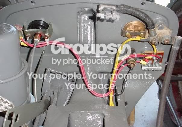

hould look similar to this. Are you sure you have a '52 N?

If your tractor does not have the solenoid as in the picture posted earlier, then it ought to have a manual start switch like one of these .....very likely the first, as age & quantity of tractors limit the likelihood of the last pictured.
Very similar to first picture you show. It has four posts coming off of it. The one on top has a wire from the positve side of the battery, a wire going to the ammeter, and a small jumper wire going to the second post down. The third post has the wire from the thumb starter button, and the fourth post is on the bottom with the lead going to the starter.

verything matches up? What happened to the starter switch/solenoid mounted, not on the starter, but around the steering column...and that it has 4 terminals vs the normal 8N's 3 terminal solenoid mounted on the starter motor??? I'm puzzled by the posts in this thread??
