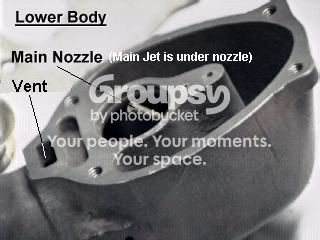

check under the big nozzel for a plugged main jet. Same thing happened to me. once I got main jet I didn't see at first out and cleaned the crud that had plugged it, It was able to run without keeping the starting fluid to it. trgWY

Since ALL fuel (for power & idle) in those carbs must pass thru the Main Jet, I would certainly look there.

great picks. thank you, this gives me a great view, thanks again. I am gonna get this thing running real soon. With all of this help, Thanks again.
