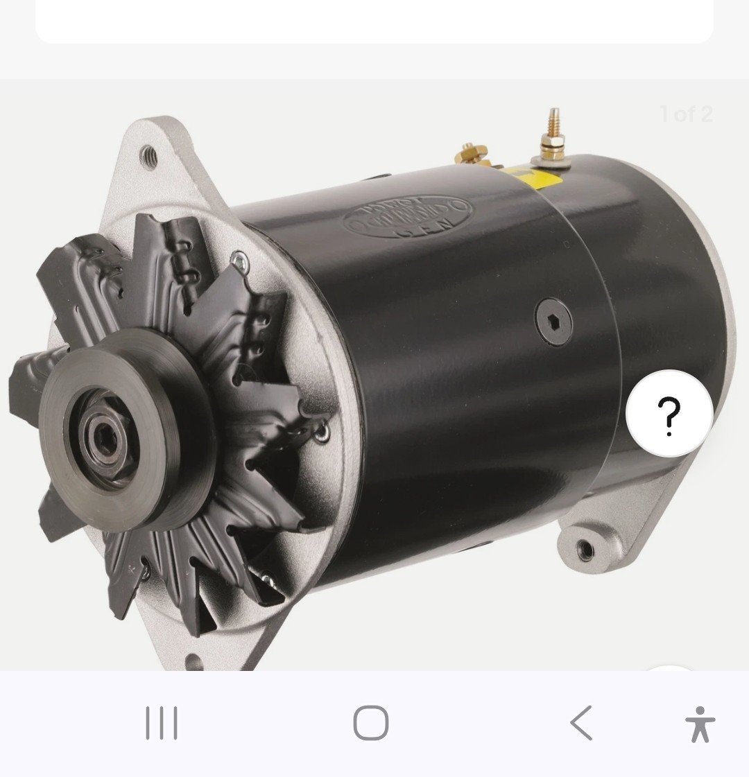

I have a volunteer to come out this weekend to check. I have a meter (somewhere) but I have no idea how to read it.
I have consciously avoided all things electric all my life.
How do I tell (am off to research) if it is generator or alternator?? Reading the article on changing right now.
12v battery means alternator???

We cannot see it. Post some pictures of your tractor and the components driven by belts at the front of the engine. If one has a tag that says Delco Remy clean it off and take a picture of it. Those things will help or at least be easier to tell you where and what to look for. From the parts book it looks like some were 6 volt and some were 12 volts.
All the diesels were 12v, gas were 6v until 1957. I can tell from looking, that one's pre 1957. I can see in the picture in your other post, it has a 12v alternator though. I'd guess it's a self exitor and doesn't have a regulator.

Looked at it when I fed, and it is an alternator.

.the shorter lighter colored one is alternator. The other,,,,generator. gm

Roo The other guys are correct but a generator can be 12 volt and an alternator can be 6 volt Though the later is rare.

Short term best to have your friend help you on that. Next id its bad find a starter shop they should be able to fix it.
I seriously doubt it is a 6-volt alternator. If you post a couple closer pictures of the alternator that shows the wiring and a good one straight on the back about 18" away from it, we may be able to tell you how to test it on the tractor, if your "volunteer" doesn't know how to.
