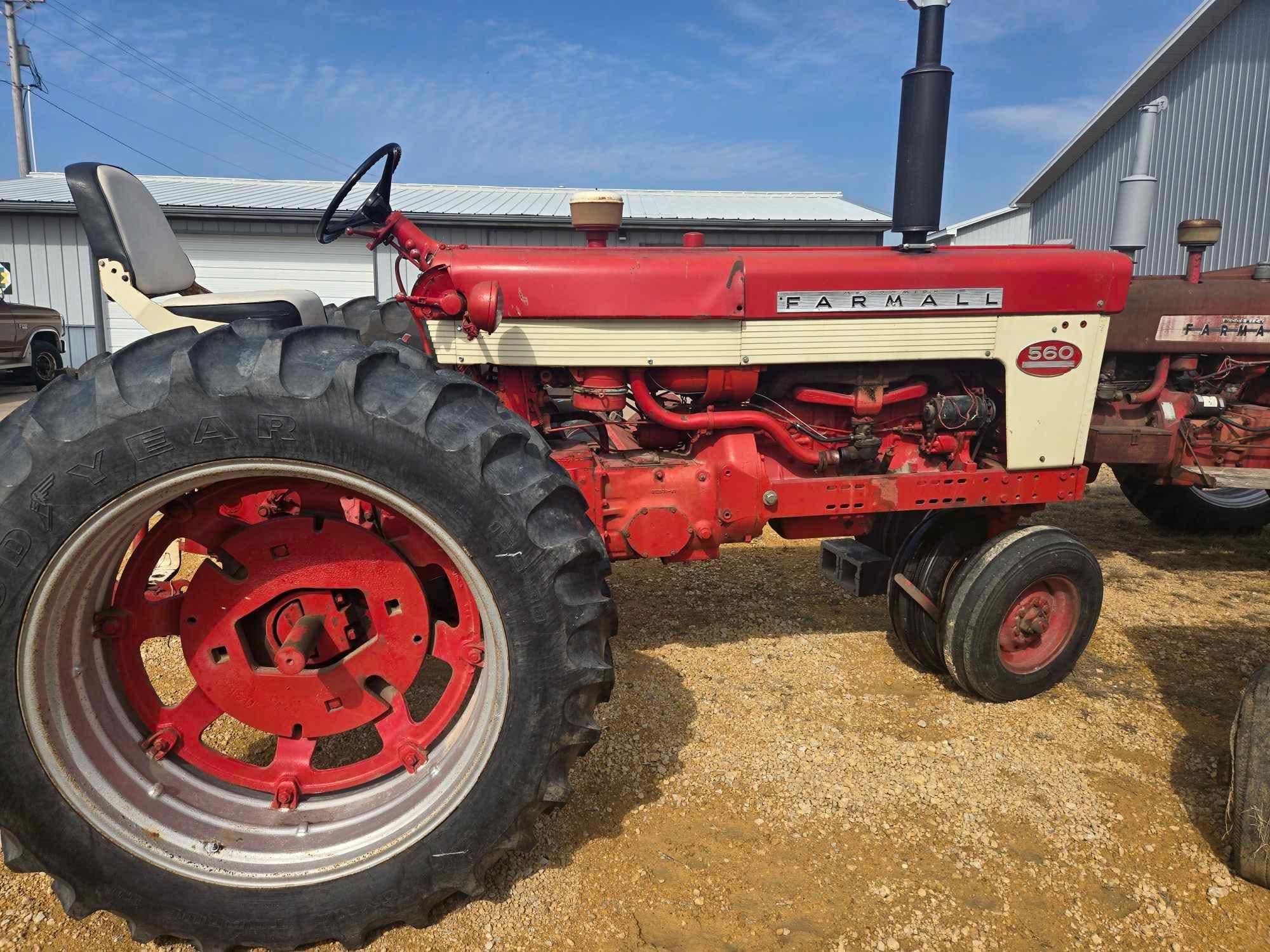

Good evening and welcome to my tirade of questions and assumptions. Feel free to correct my assumptions. I recently bought a farmall 560, it ran rough, I did plugs, wires, distributor cap, rotors, condenser, and I rebuilt the carb. It’s an oddball in the way that when I bout it, it had the correct head on it, but smaller spark plugs, like lawn mower size. I used a bore scope to look at the pistons and they were almost spotless. I was told it has a 706 manifold on it.
Assumption time: I would like to believe that with the pistons being so clean and a different head and manifold, that there was potential motor work done. I have it dialed in now and runs beautifully. I would also like to believe, maybe dream, someone bored it out to 706 specs. Is there a way to tell that without going to a dyno or taking the head off to check the pistons? It has over 8k hours on it according to the working tach. There was also a shoddy, albeit correct colors and what not,
paint job on it and the tin is decently straight.

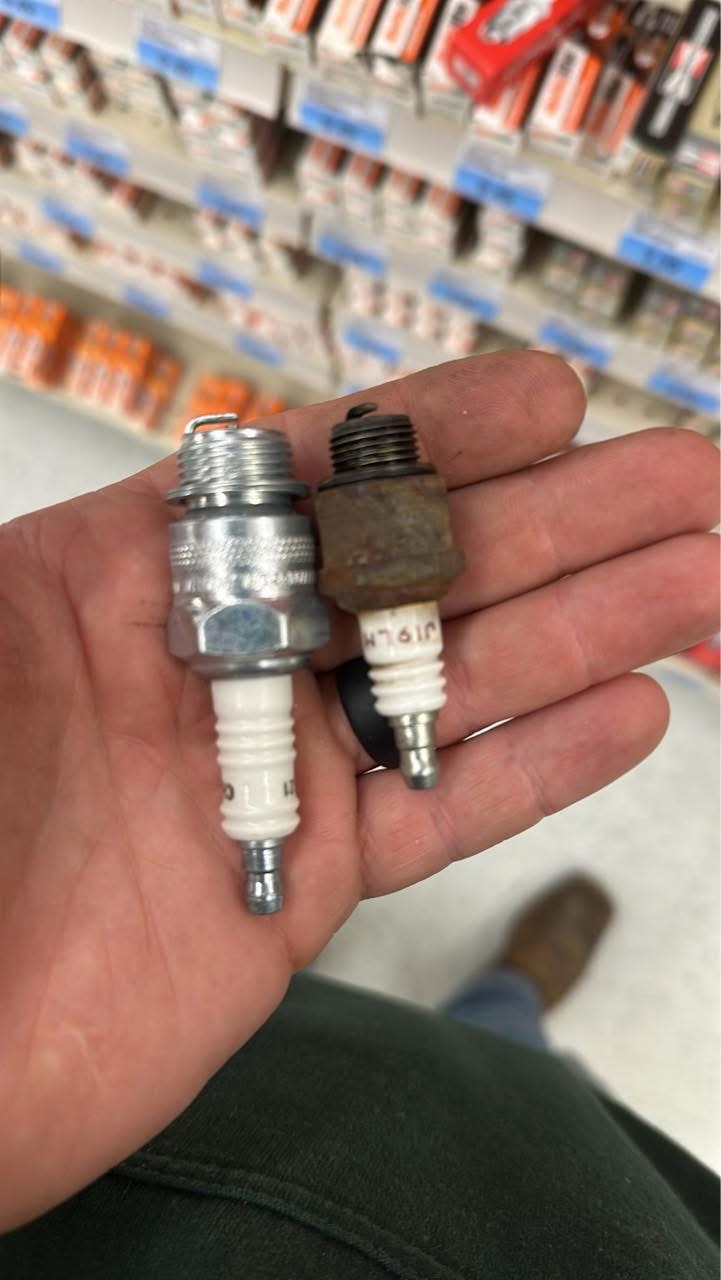

The way I read it was that the bore and sleeves were different. But in regards to the spark plugs, the plugs in it currently are j19lm I believe. The ones that belong are automate 3116s or champion d21s.

The way I read it was that the bore and sleeves were different. But in regards to the spark plugs, the plugs in it currently are j19lm I believe. The ones that belong are automate 3116s or champion d21s. View attachment 110657

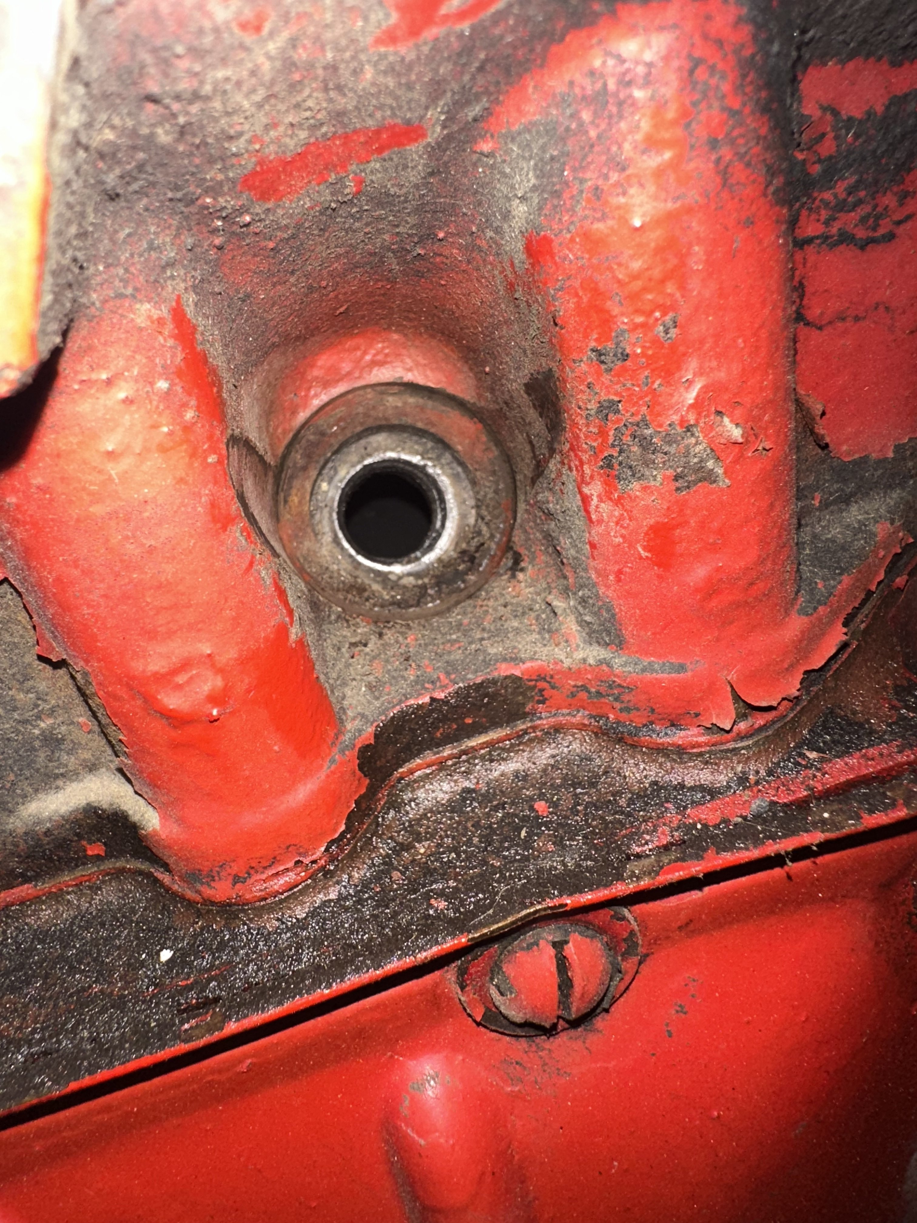

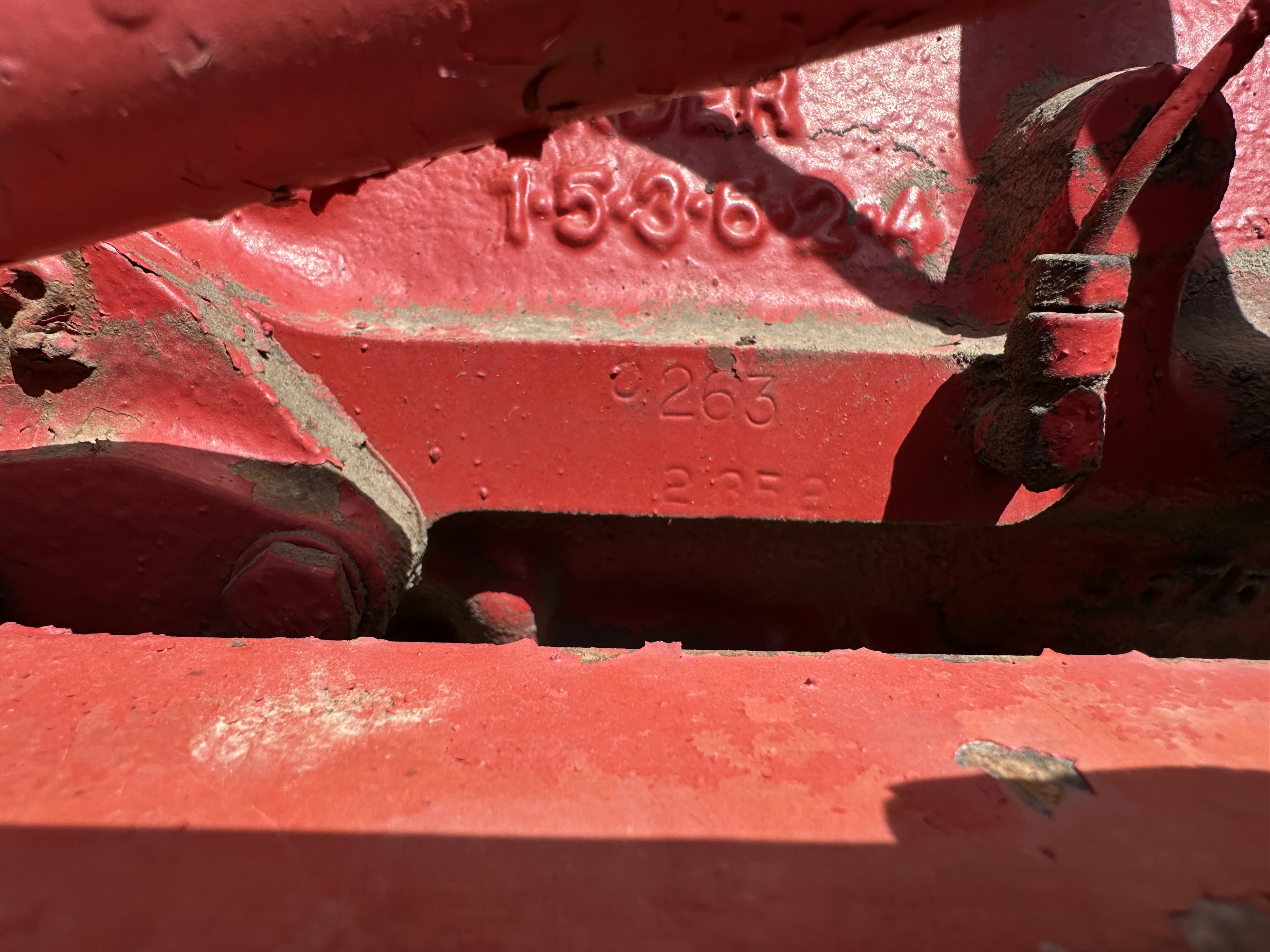

Okay I see what you mean, I think someone put a truck engine head on it. Not real sure maybe even the entire engine is from a truck. I am not enough of an expert to tell you if that can be done. What are the numbers stamped in the flat machined area by the oil filter? I can’t, but maybe someone else can tell you what you have by those numbers.

You have to clean out the spark plug holes and get a much better picture up close for us to determine if you even have those. It really looks to me like that head is just machined to use small plugs “14 mm” plugs. My next step would be to go to rockauto and see if IH 60s/70s trucks/pickups 6 cylinders used 14mm plugs.

It's POSSIBLE that someone installed 18mm to 14mm thread adapters in the head.

This is the number on the block
View attachment 110791This is the number on the block
About 6 inches further back is a cast number. On my 560 gas it is 367511R2. That should be what you should have. If so, the head has been changed and the pistons have been changed and the block could’ve been bored out to a 706 or an 806. Nobody knows. I’m always curious enough I would probably pull the head off just so I know for sure but I’m crazy.😀 A dyno could give you a little more insight.
I just blew up your picture and I can see the number 3675— so I’m guessing you have a stock 560 block and the Pistons and head have been changed. You may have gotten more than you planned on.👍
