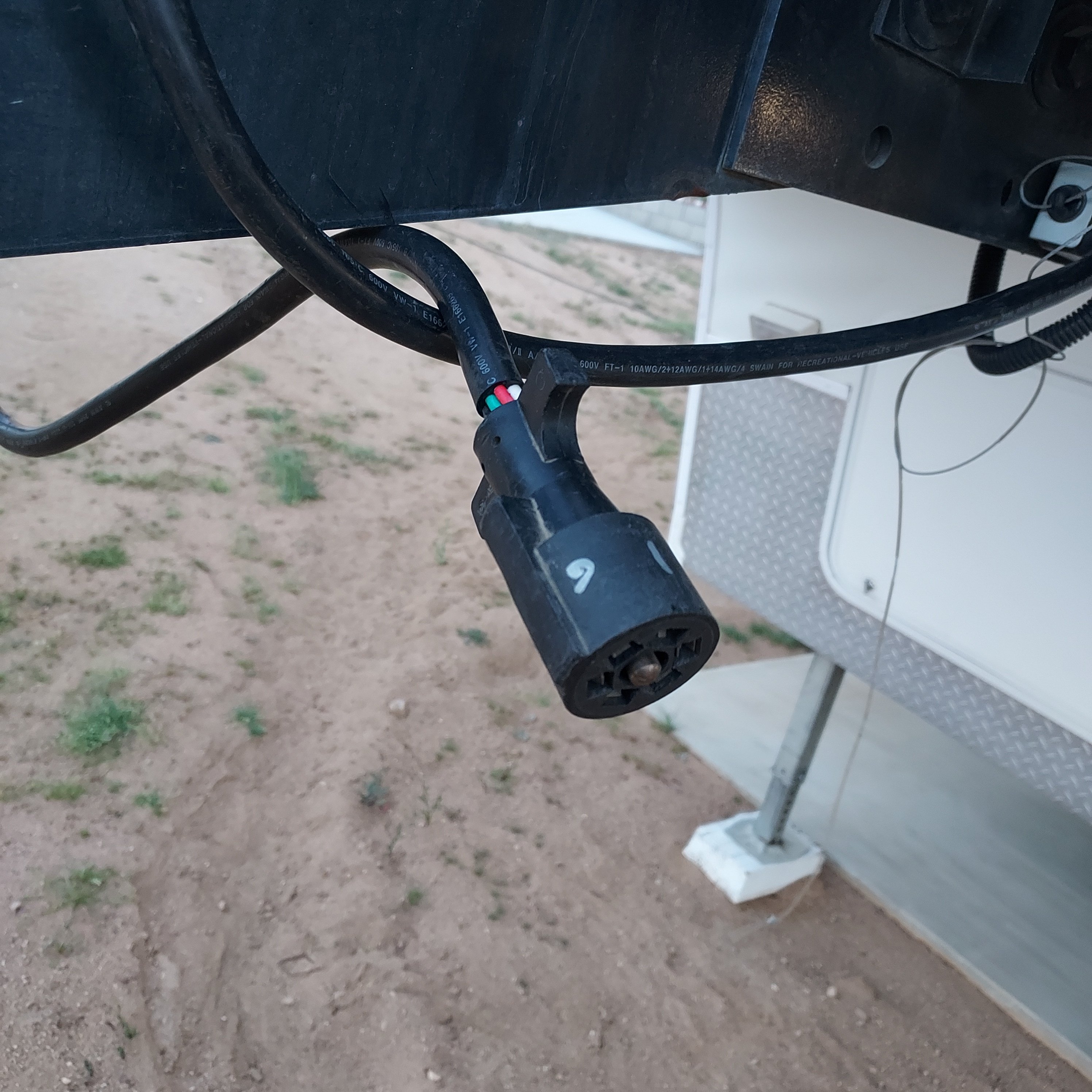

Looking to replace a 6 pin plug on my 5th wheel. Now what I have done was strip all 6 wires on the old plug thus using a meter, I would go from say the white wire and trying to find resistance to the female termnal, well I am finding resistance on a couple of the terminals? I would think there would be 6 separate readings. The old plug is a sealed one with no screws to take it apart. I just don't want to take the old plug apart and have 6 wires without a clue as to where they terminate. I guess I could just cut the plug a little closer to determine where they go.

First of all, you have a SEVEN terminal plug.
It's NORMAL to find a degree of continuity between many of the terminals as all the functions are tied together on one side as they share a common ground, electric brakes, tail lites, right and left turn signals (which double as brake lites), and backup lites.
Here's some diagrams, but no guarantee your cable has standard-color wires!
There should be a screw in the side of the plug or the screw holding the wire into the plug and they come apart. Slip endways over each other to come apart. I have seen the wires individually crimped into the pin crimp so you had to cut each wire loose on those. Top or the one with the raised tab should be ground with the white wire then black and brown on each side from white and green and yellow for the next apir below that and red on the bottom. Blue is in the center. Green and yellow are right and left turn and depending on how your wired can also be the brake wires for a 3 wire set up other wise the red is brakes. Black and brown are marker and tail lights . The blue wire in the center has now been used for the ABS system on trailers. I used it foe my blinky light for over size work. Before the ABS and my trailers didn't have ABS on them. Thhis is all dependent on your particular wiring on both trailer and truck.
Just cut the old plug off. Then you'll be able to read continuity between the severed leads and the contacts. As long as the plug is connected to the trailer you're going to read continuity across the different contacts because they're connected via the lighting and brakes. Not to mention you'll blow the fuse on your meter when you hit the battery lead.
Note that the color coding is very consistent, so you should be able to go by the illustration provided by Wore Out.

Cut the wires off old plug and leave a little insulation for reference.
Got a jump pack? White wire is supposed to be ground, and black is supposed to be the charge line for the house/breakaway battery. Clamp it in the negative clamp of your jump pack. Clamp a nail in the positive, and use it to probe the other wires and see what lights up.
There are a couple of different color schemes used, but it doesn't hurt to verify by probing. By the looks of the picture you should be using the RV scheme.
You don't say what the issue is causing you to start this whole process. I'm guessing something not working. If it isn't too late; clean a spot on your trailer frame and hook a jumper cable from the frame to the negative on you battery. Plug the 7 pin connector back in and see if things start working. My 91 24' Dutchman still has the original plug and wiring. When one light goes out it is a bad bulb or connection. When multiple issues occur it is almost always a bad ground.
I agree, color coding should be consistent to either the 7 traditional or 7 RV pictures wore out posted. I have found some of those molded cords that were not. On an existing trailer plug I start by verifying color to function position and write them down for reference. If the colors match one of the standard configurations good, if not I know it upfront.

Well got the 6 pin plug all back together and she works fine, the only thing I don't understand is why the L/H turning light turns on and off real fast like weather it is connected to the truck or not..
How does it flash fast when not connected to the truck?
Usually a fast flash is caused by a heavier than normal load with a contacts flasher. Does your truck have a flasher with contacts or it it a solid state flasher?
You have what is called a 7 way or 7 blade plug. There is a 6-pin plug which is different than what you have, it has round pins like the plugs used on semi-trailers, not flat blades as you have.
It seems like you mean your truck blinks fast on the left-hand side with or without the trailer connected, but your wording sounds like you are talking about the trailer. If you have dual contact bulbs (parking and turn signals in one bulb like a #1157) I have seen a filament break and cross onto the other filament and make the fast blink. I would say check the bulbs
