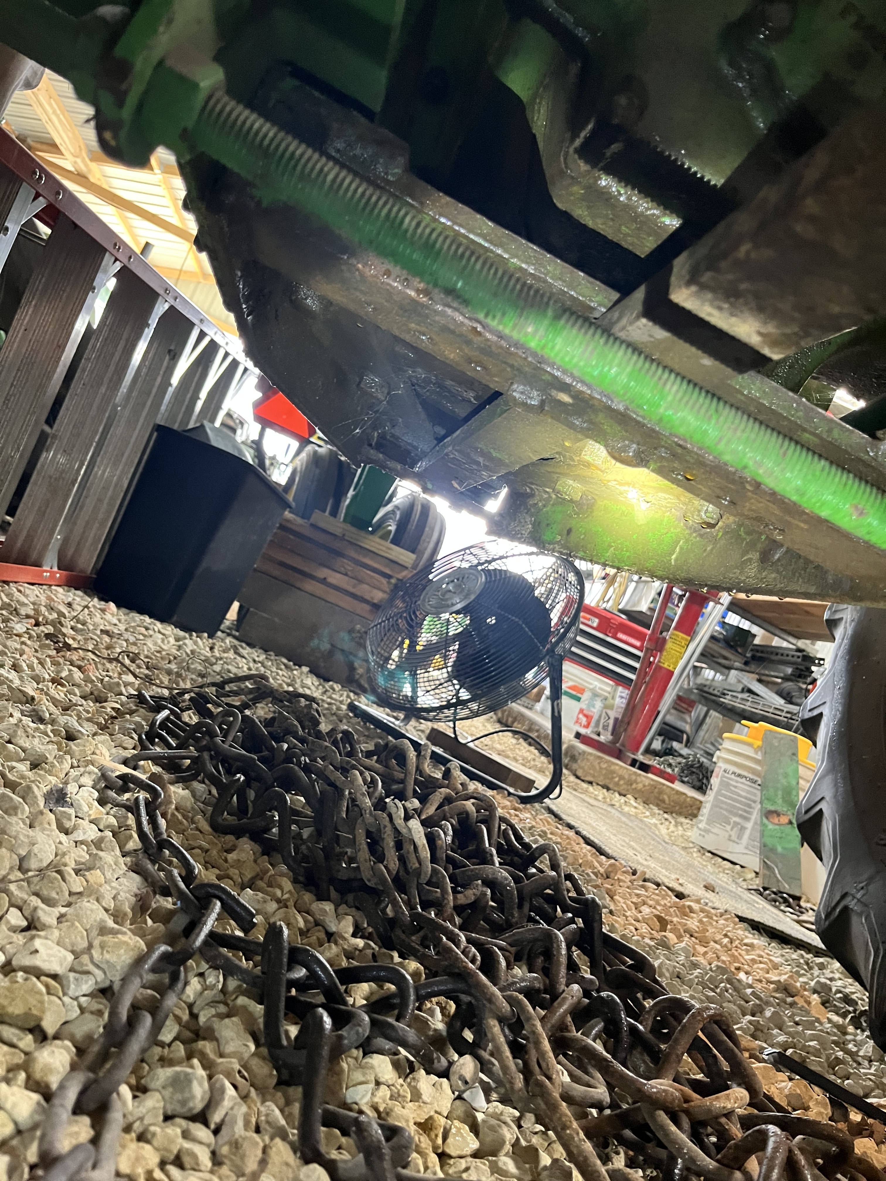

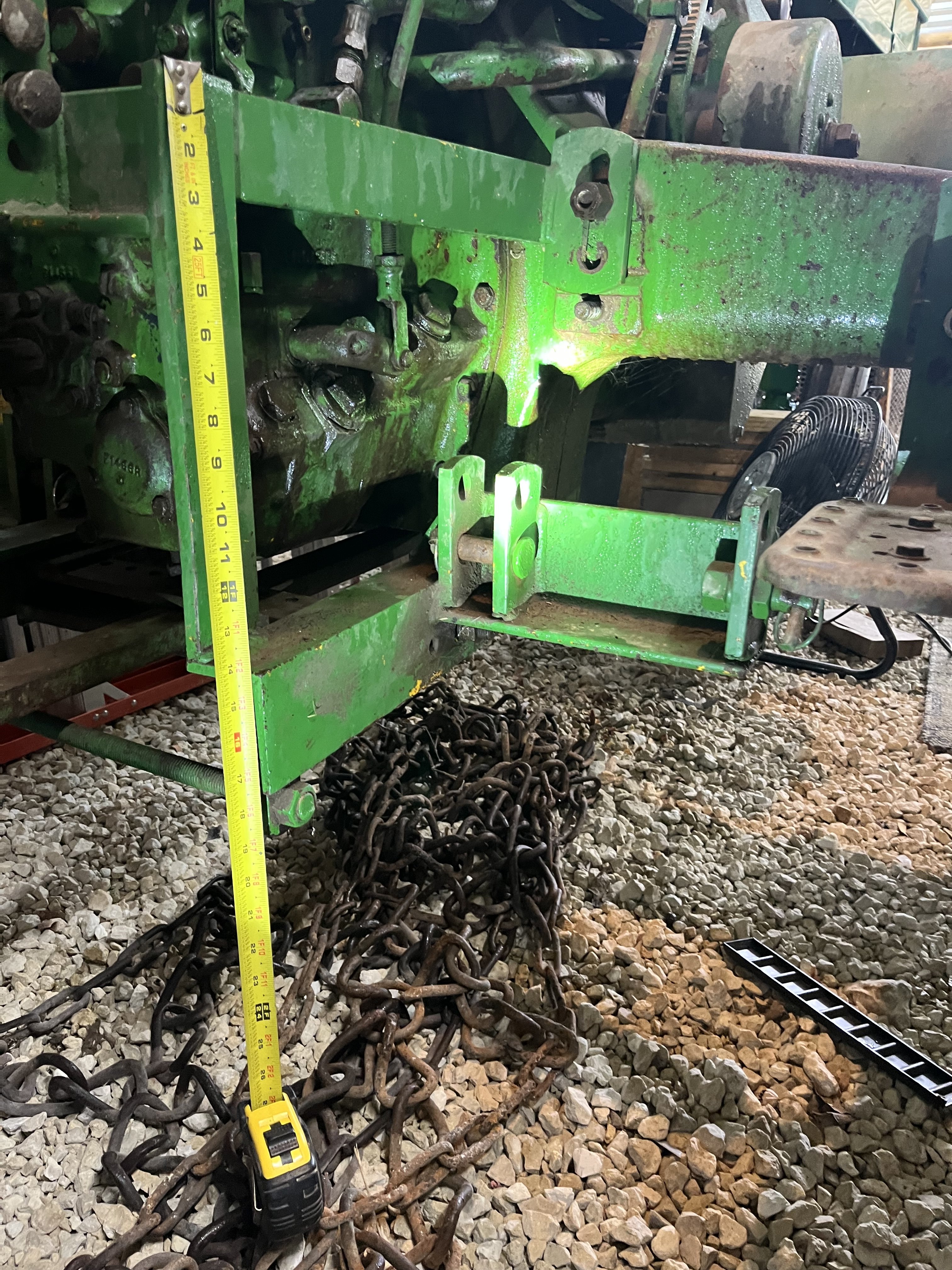

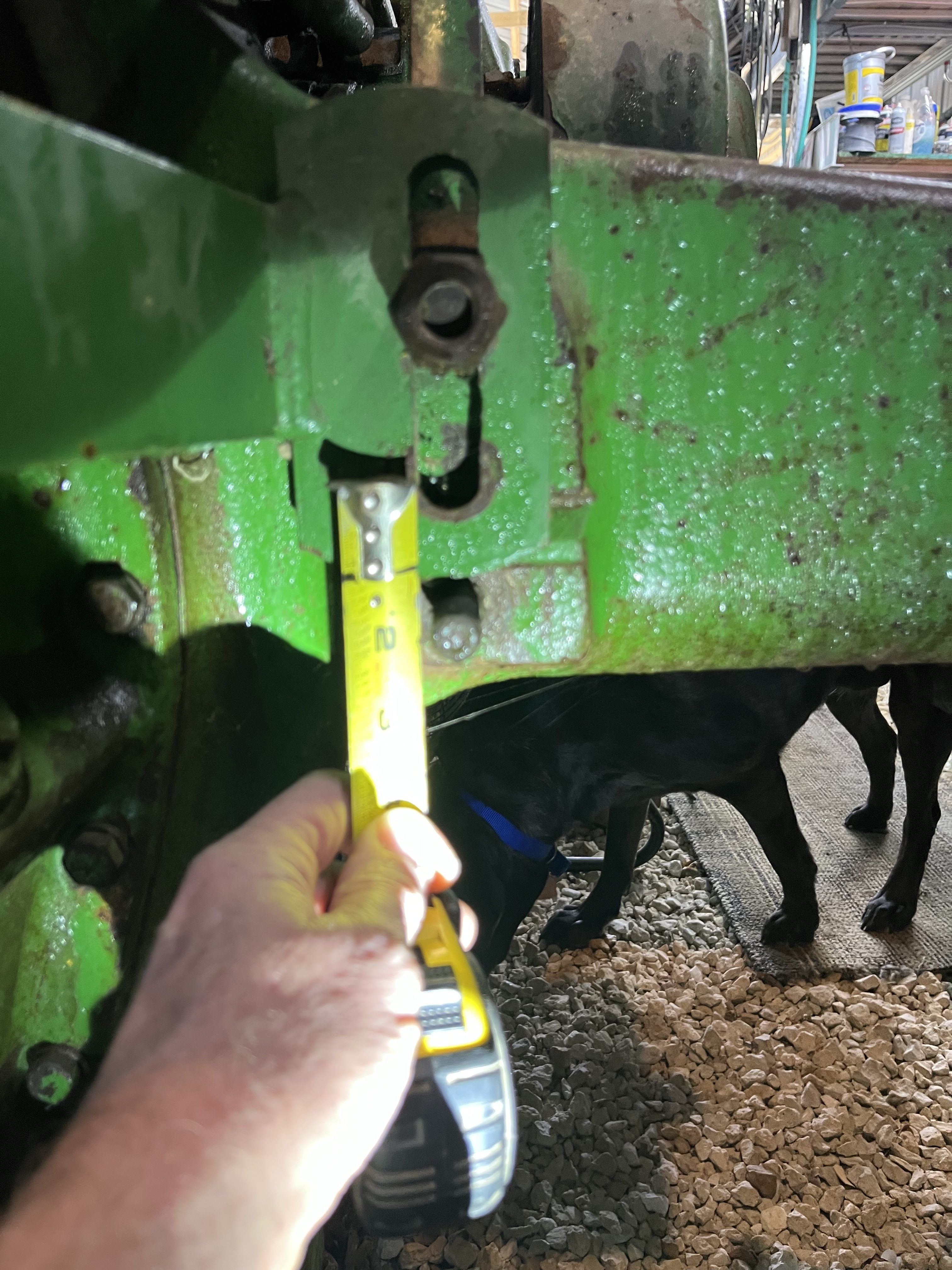

I have an aftermarket 3 point that I was told came off a 620
The axle mounts are 1 1/2” too high
The angles bolt onto the drawbar mount just fine.
Is the draw bar frame that mounts to the main casting supposed to have 1 1/2” spaces, which would drop the angle brackets 1 1/2” thus dropping the axle mounts the 1 1/2” that is needed to make them bolt up ?
Or
Is this 3pt for an 80, 820 or maybe a 630, 730 ect ?
I could just cut them weld the supports but would rather not if it can be avoided
Thanks

It looks like the bottom does fit really well. Both mine have holes for the axle mount instead of a slot I'd be tempted to cut the whole slot assembly off at the weld and attach a new ear with 2 holes on instead EXACTLY where you want it.
Lower it much more and you might catch something with that crossbar don't know what you would be using the tractor for not saying you couldn't move it down with spacers or even grade 8 washers to make sure they are hardened. Especially just to try it see if you like it that might be the answer. Usually those frames are mounted flush I believe.
Looks like it might be for a 50 or 60 The 20 series on up have the top link bracket made into the back of the tractor. They don't need the piece bolted to the axle. ,
